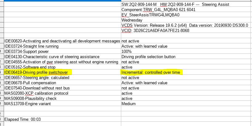

But if you really want to change the Driving Profile to "Direct: control over threshold value', you can access "44-Steering Assist" control module then go to "Adaptation" and change it at the highlighted channel as shown in the picture:

Thanks for the replies. Tried out the throttle resetting as per the video and another with slightly different procedure, didn't notice any difference. Will try out vcds tweek when my new laptop battery arrives.
