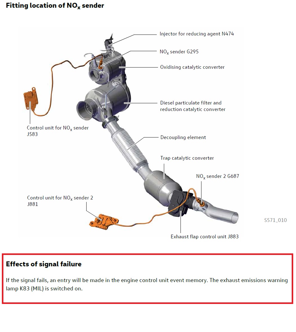

According to "Self-study Programme 571 - The Polo 2018", if the GPF is not functioning normally the K83 lamp (MIL) should be on.
Page 27 of this document:
https://procarmanuals.com/self-study-pr ... polo-2018/
