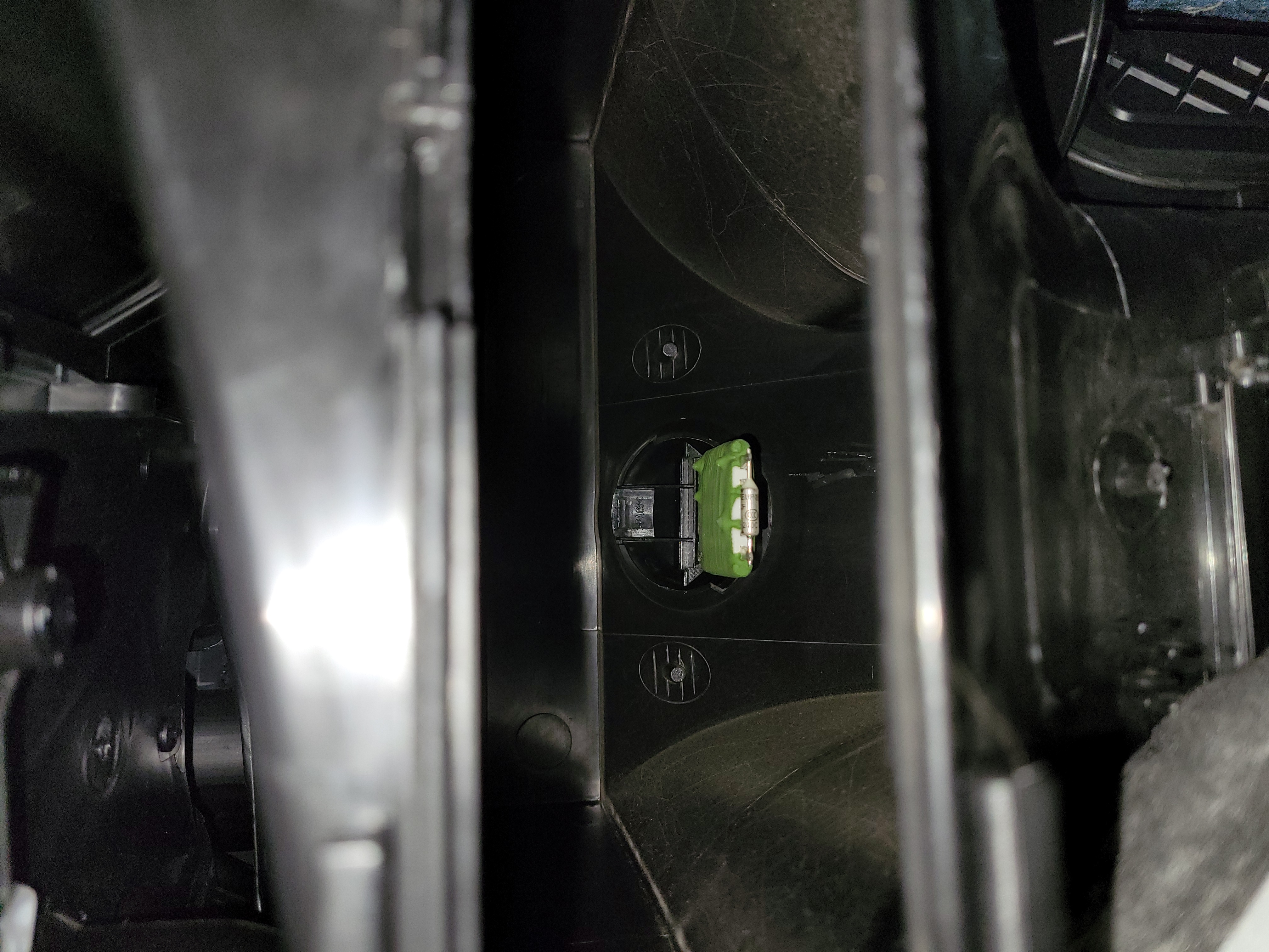

I've taken a picture of the resistor through the filter box . It doesn't look burnt
- 20210906_183319.jpg (4.12 MiB) Viewed 1971 times

I guess you should check the resistor pack again.
If you find that the thermal fuse breaks regularly (interval between 1 or 2 weeks) you will have to check the fan motor, the motor shaft should rotate smoothly, without roughness of any kind.

Re: 2011 polo . New heater resistor pack smells
You have good eyes I didn't notice that or more like didn't know what I was looking for.
Spoke to a local garage, first question he said was did you get the resistor from eBay (I did ).
Might be worth buying a genuine one and try again?.
I think the first resistor broke because the pollon filter was full of fluffy stuff

A genuine is also probably just a Hella/Valeo resistor with a VW label on it. But, like ciclo said, you could and perhaps should check the fan itself, does it rotate freely?
