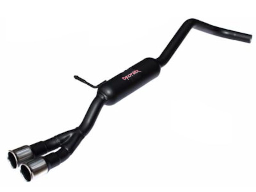

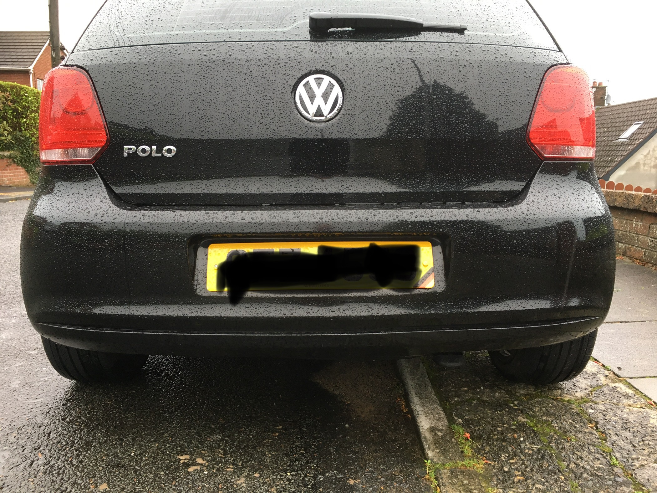

Hi folks, new to the forum and hoping for some help from the wealth of knowledge on here. My daughter has a 2010 1.2 6r Polo. She wants a Sportex exhaust put on it, that’s the easy bit, my problem is the back bumper. On her car the tailpipe is hidden under the car, the new exhaust has twin tips. Should I be looking for another bumper or be drilling holes in original one. I have attached some pics, her car is the black one, the white one is what I would like it to look like but I’m unsure what model the bumper is from. Any help would be greatly appreciated.
