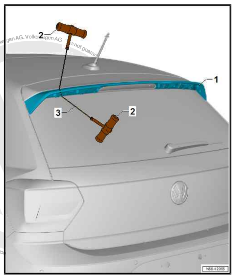

Hi, I'm looking in to getting a larger wing/spoiler on my 2018 GTI, does anyone know a good method of removal for the factory spoiler? If I'm not mistaken it's stuck on with 3M Tape?

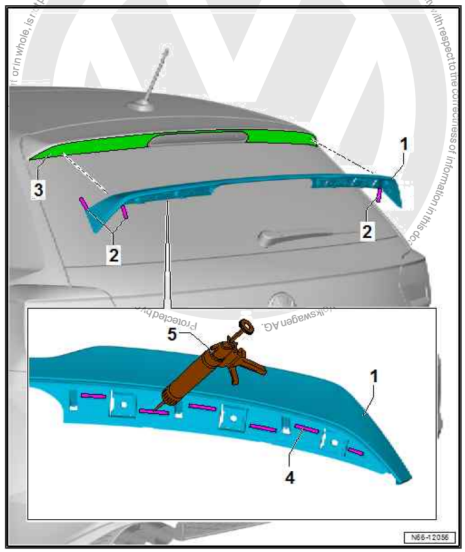

I believe service manual stated to use glue
//found it in VW Polo 2018+ - General body repairs, exterior - Cardiagn Service.pdf page 320
removal:
installation:
