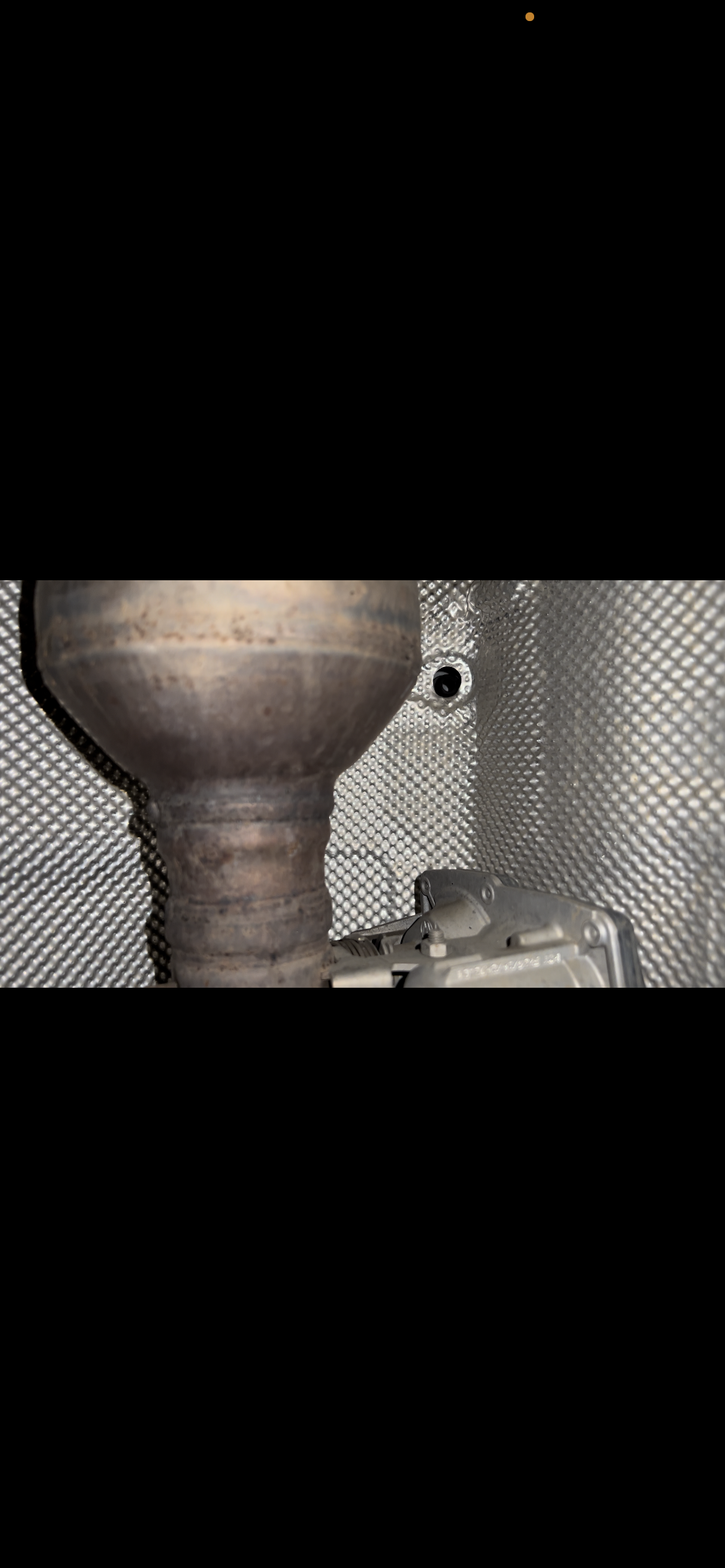

I think I found what’s causing the noise. Is there meant to be a screw or fixture in this black hole?
Looks like a screw is missing in the black hole?

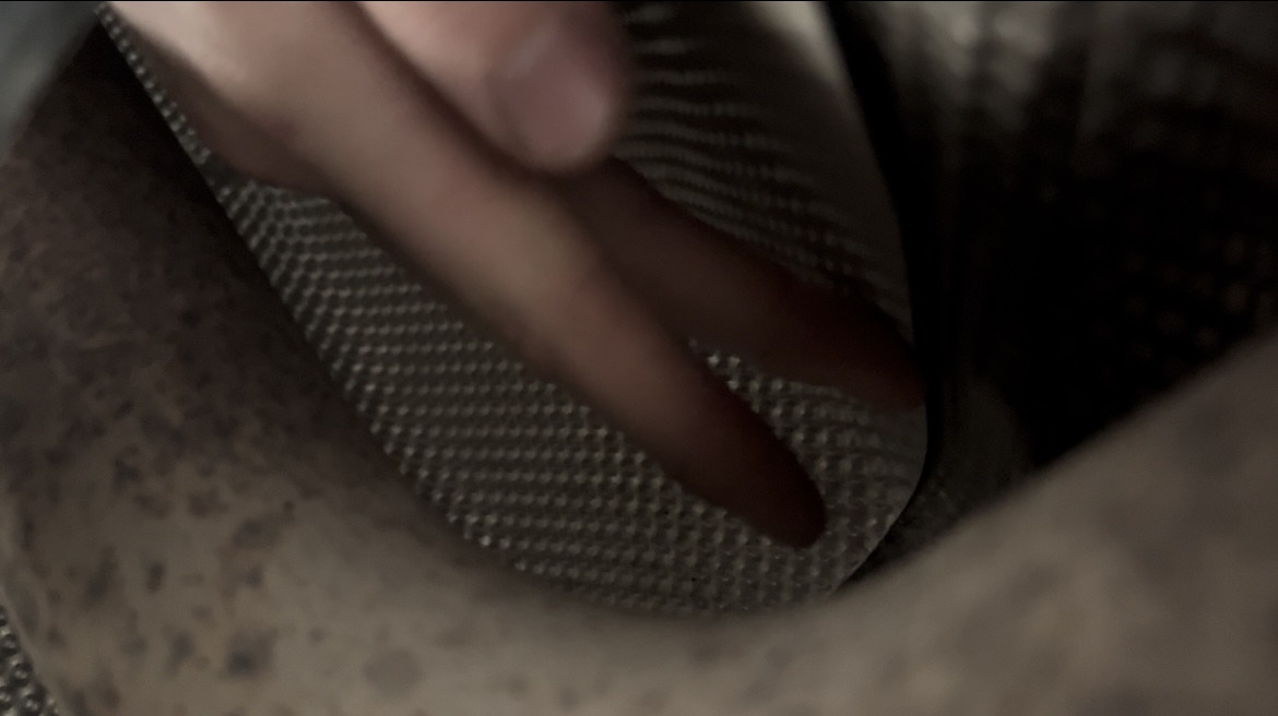

Update - found the cause.
If anyone experiences a metallic vibration noise under the car, it is the exhaust heat shield above the rear bend of the exhaust pipe where the heatshield spreads out towards the front of the fuel tank. I bended mine slightly and the noise stopped.
