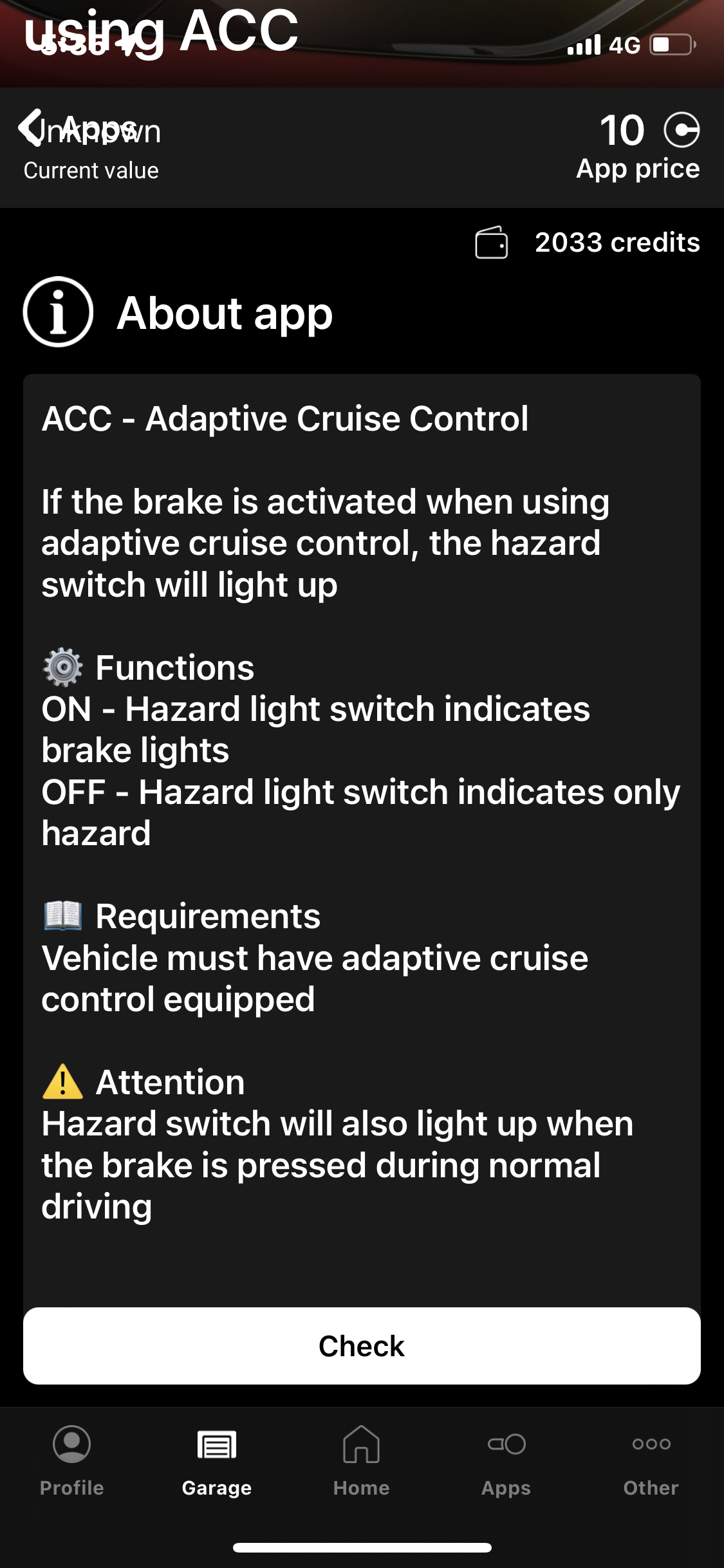

Yep 100%, the brake lights illuminate under any automatic braking.. there’s a app in obdeleven that illuminates the hazard button to show you when the car is braking.
