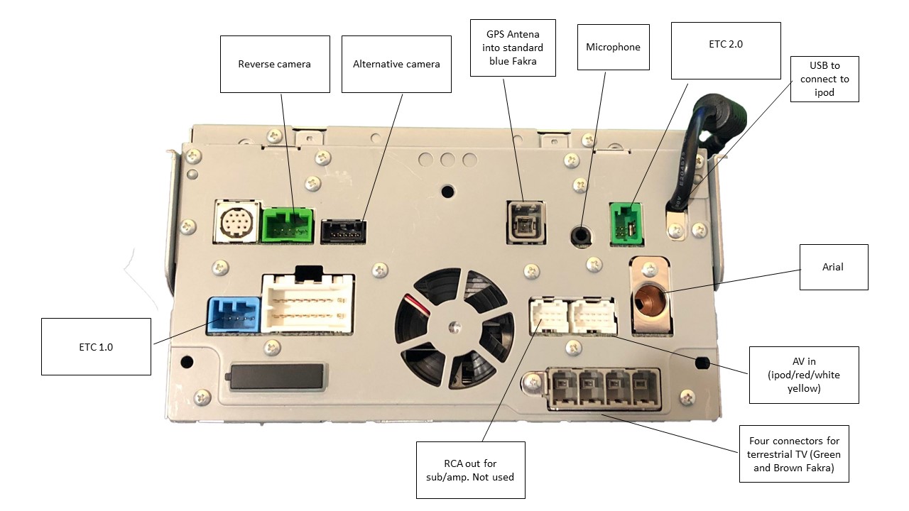

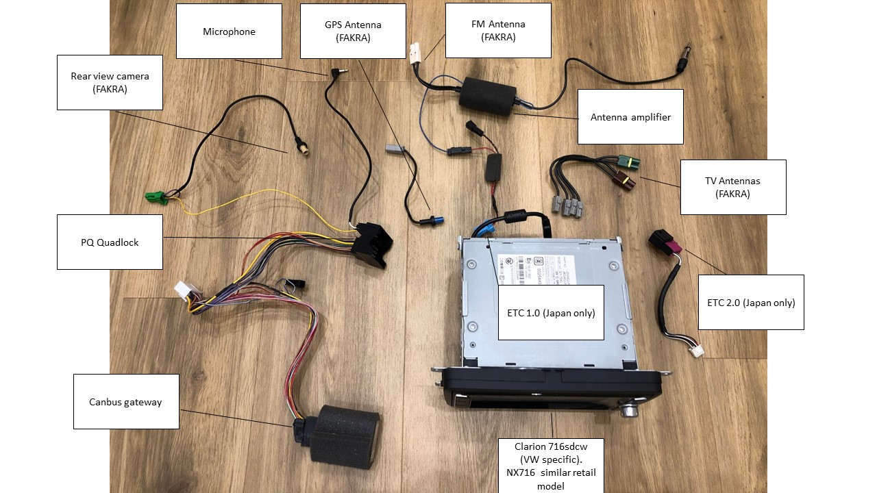

The radio and patch harness has a number of connectors as follows. Not relevant to the retro-fit but are a good resource:

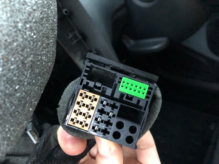

Despite the car being MQB interestingly the car has a PQ quadlock.

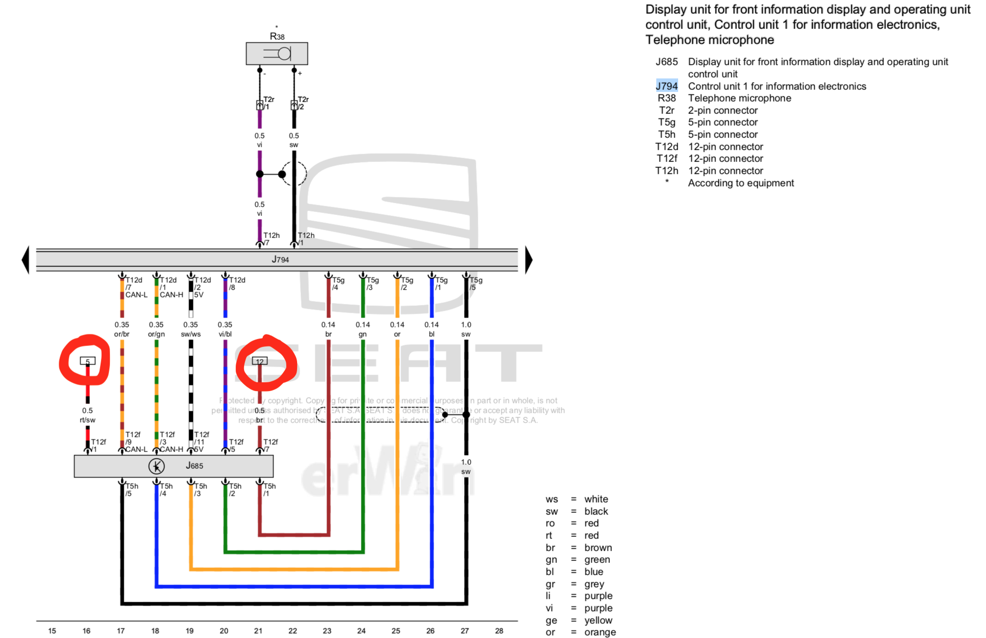

Connection references in wiring diagram

Required PQ to MQB qualock adapter

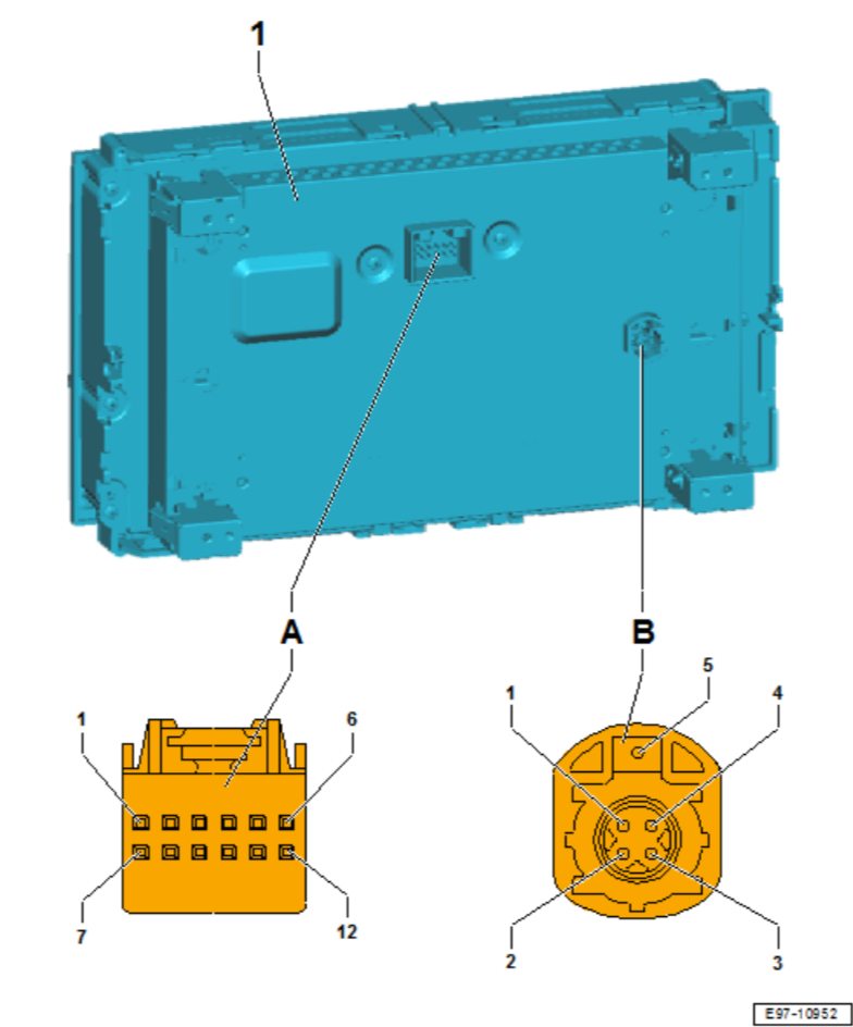

12 Pin CAN/Power from T12D/T12F (block D quadlock to screen) (J794). See Seat wiring diagram below.
Question: pins 5 and 12 on the screen look to be power and ground respectively. Where do these connect to in a factory application and what voltage is pin t12f/1?

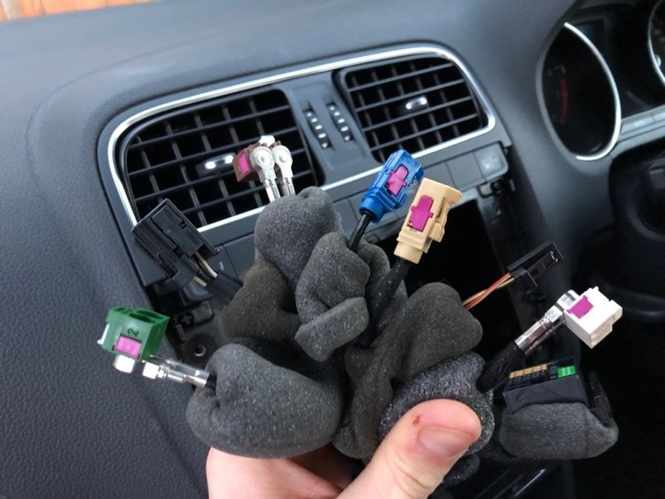

Reverse Camera: re-pinned into block B pins 6 and 12 of MQB quadlock adapter. Has FAKRA type I connector.
Question: Does someone have a picture of this on a factor install going into Block B of J794 qualock
Bluetooth: re-pinned to block B pins 1 and 7 of MQB quadlock adapter.

GPS: Plug and play if required. Blue Fakra present.
TV: Antennas not used in European systems

supporting images from previous post
Wiring labels.jpg (125.62 KiB) Viewed 3011 times
Screen Shot 2018-10-20 at 12.55.45 PM.png (227.99 KiB) Viewed 3011 times
Screen Shot 2018-10-20 at 12.52.34 PM.png (298.74 KiB) Viewed 3011 times
Patch harness.jpg (220.17 KiB) Viewed 3011 times
