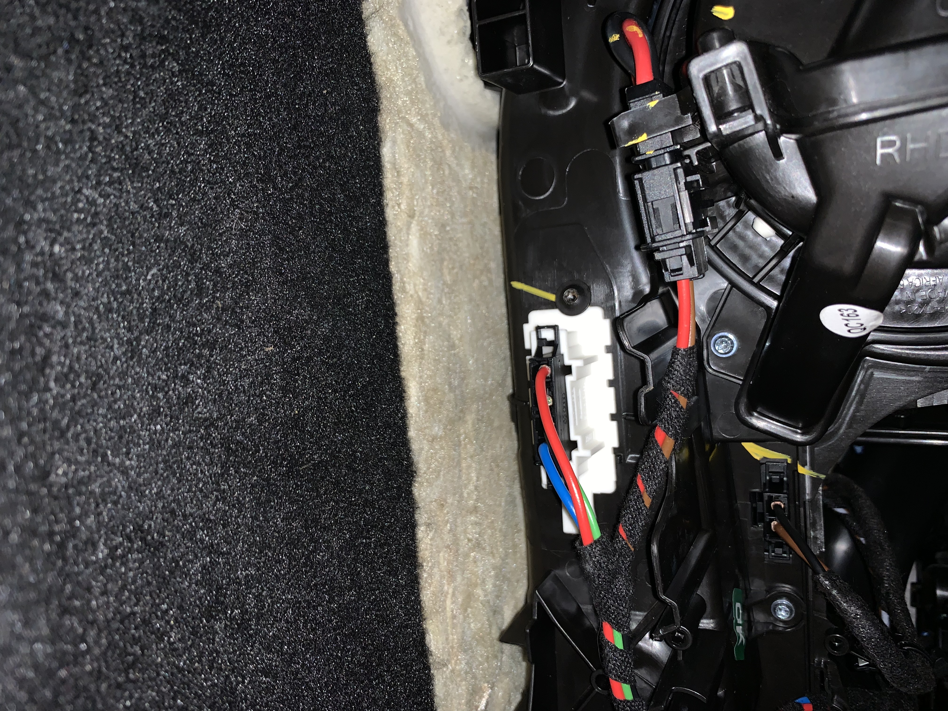

I also had a not so good photo taken, the blower motor is under the passenger footwell, quite accessible but requires a bit of contortionist movements
The resistor is the white bit on the photo. Hope this helps

Being a cynical sort of person maybe, it looks like "the fix/improvement" over the years has been to make it more accessible!
Always check the pollen filter and the cabin air inlet areas for blockages as a lack of air flow into the cabin will mean that this dropper resistance block will suffer from a lack of cooling air.
