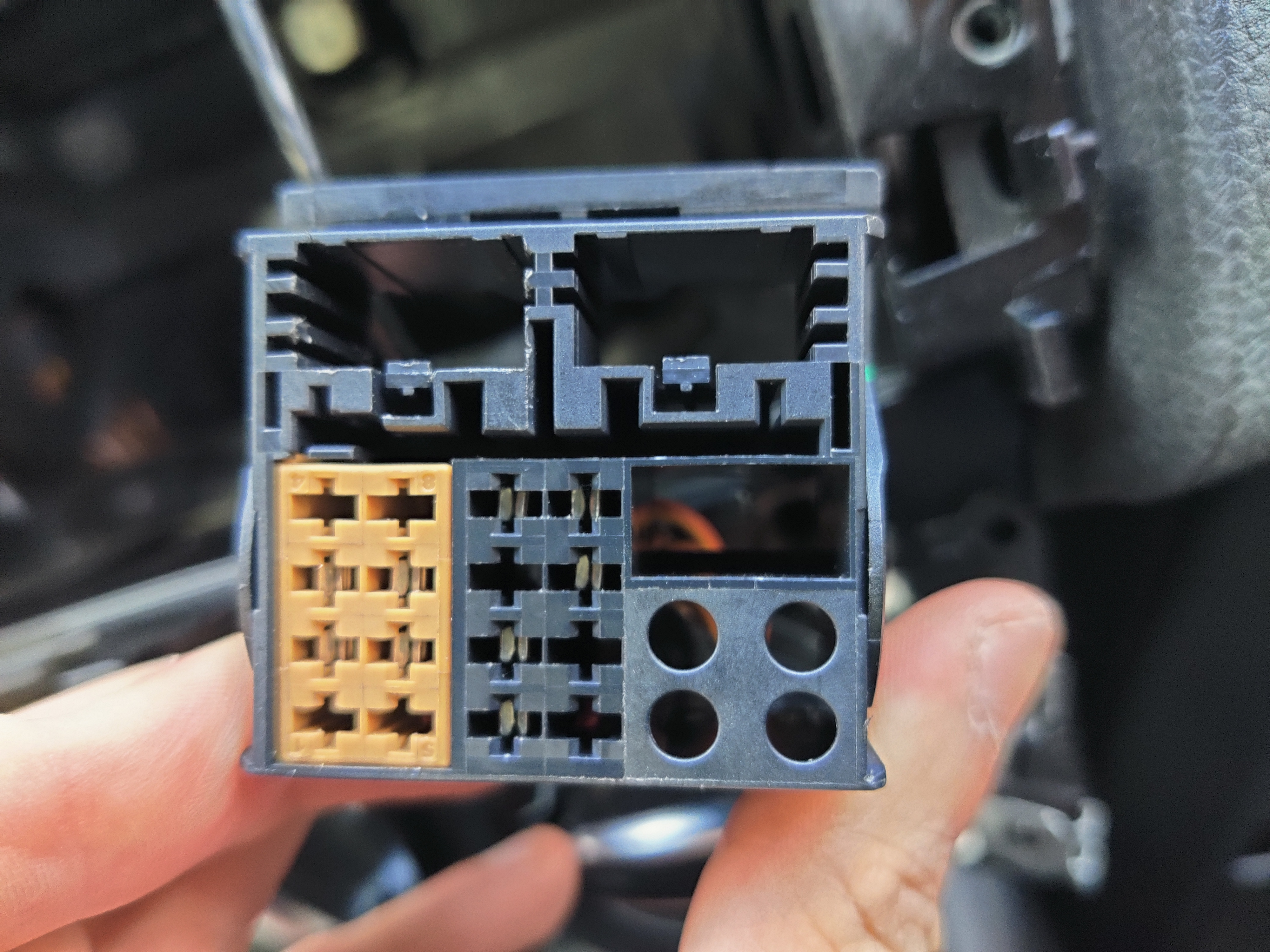

However the connector doesn´t fit into the Quadlock. I looked at a bunch of videos and noticed that the Quadlock on the cars in the videos are different and look like this:
Quadlock Type 1.jpeg (81.55 KiB) Viewed 1019 times
My Quadlock looks like this:
Quadlock Type 2.jpg (3.54 MiB) Viewed 1019 times
I´m looking for a solution on how to make it work with my type of Quadlock and this bluetooth adapter, or should I just buy a new bluetooth adapter, if so, which one would fit?

Looks like your bluetooth adapter and the top picture have the old quadlock adapter. The OEM VW part for the new one you need, is the blue 12 pin insert for quadlock, 8X0035447

Oh, great, I ordered one. Thank you so much!
