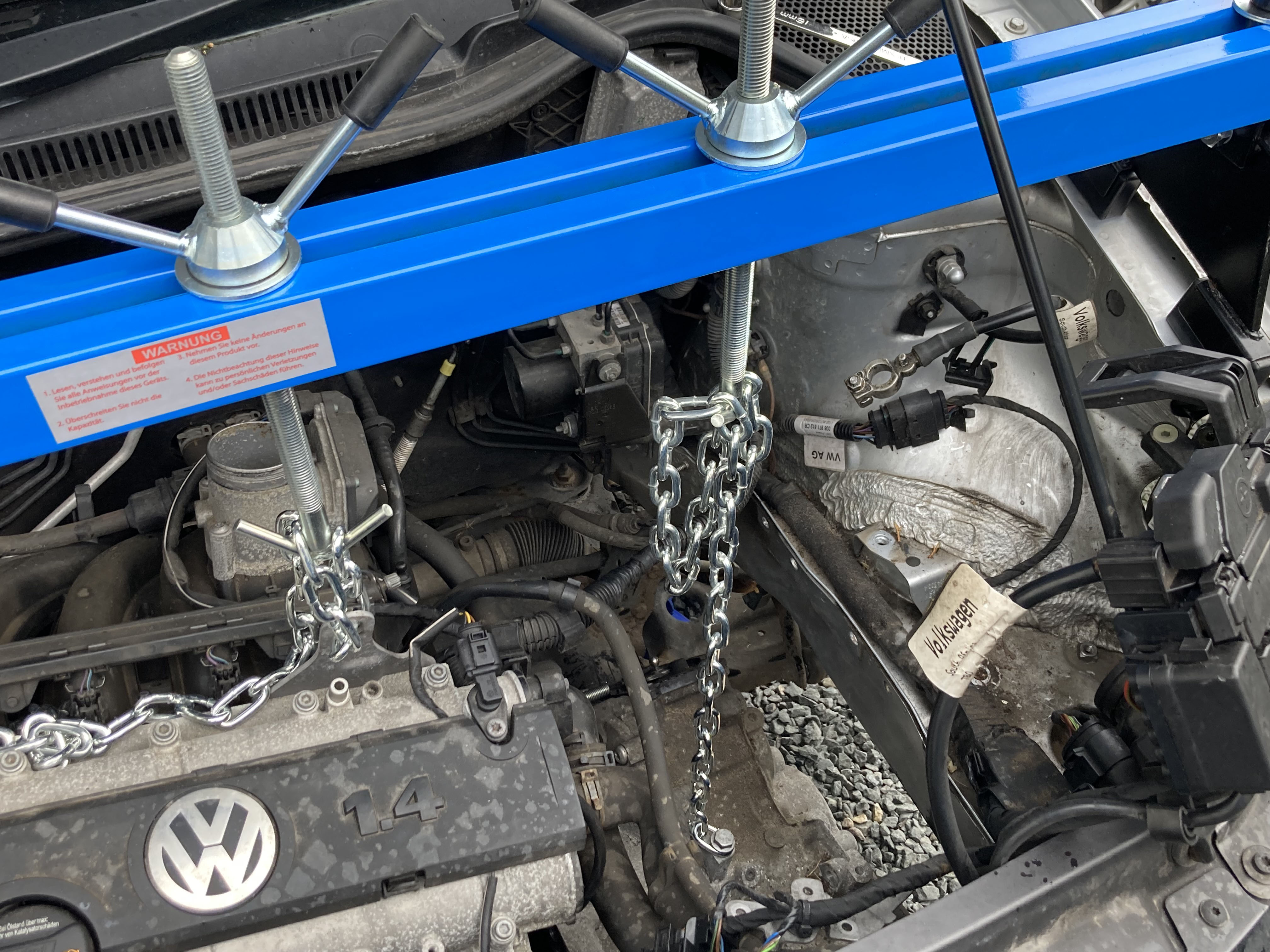

Managed to get the box off. Few pointers for folks:
An engine support beam with double hooks helps a lot! One for the engine, one for the box. That DSG is a heavy b*stard, very difficult to manoeuvre around the subframe. CarbonChaos above was spot on, subframe need not be removed for this job.

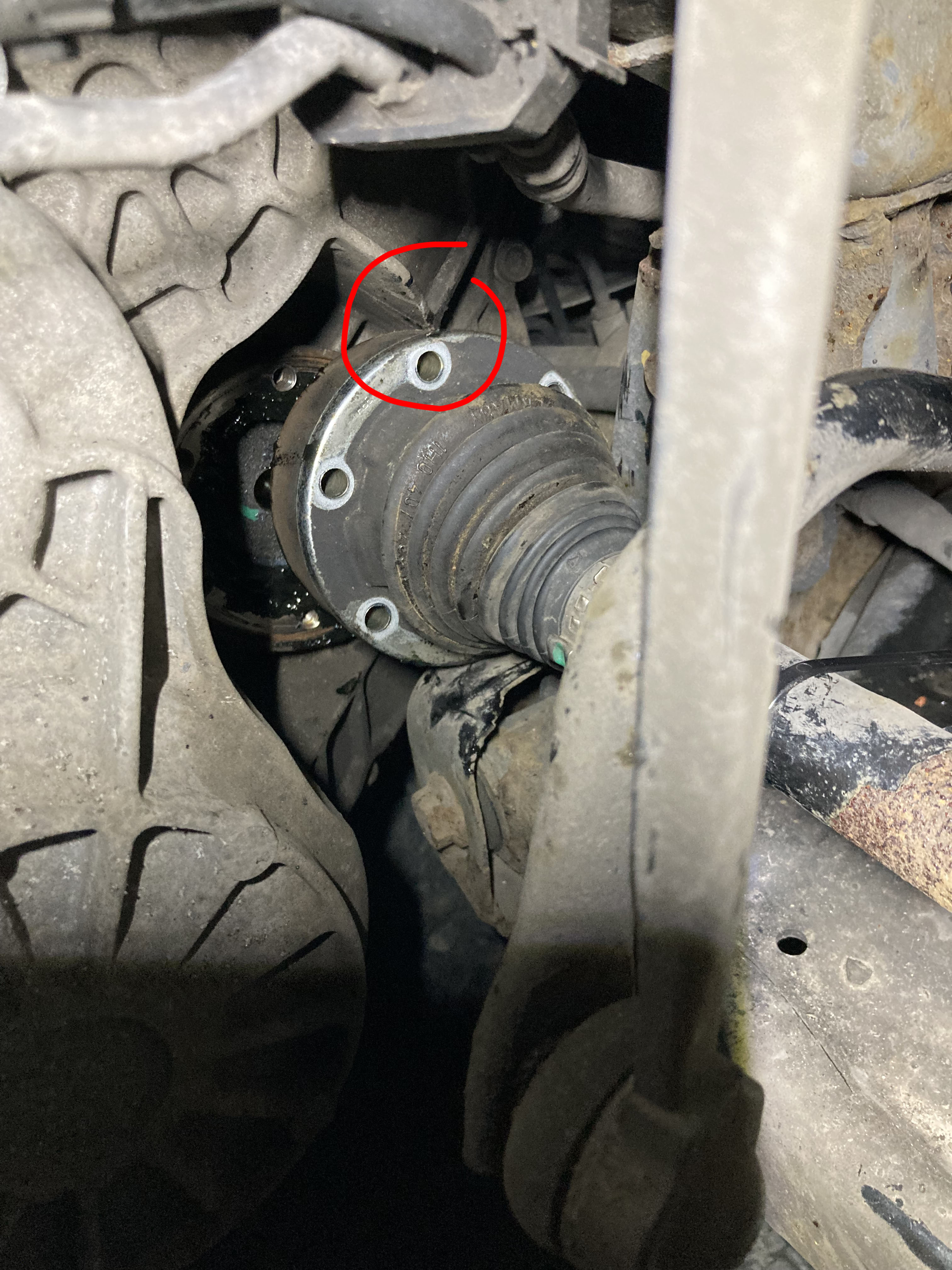

Left drive shaft has to come off completely, right one only has to be disconnected and suspended.
Left drive shaft flange can stay attached, right one has to be removed (I found that it's catching on the flywheel housing).

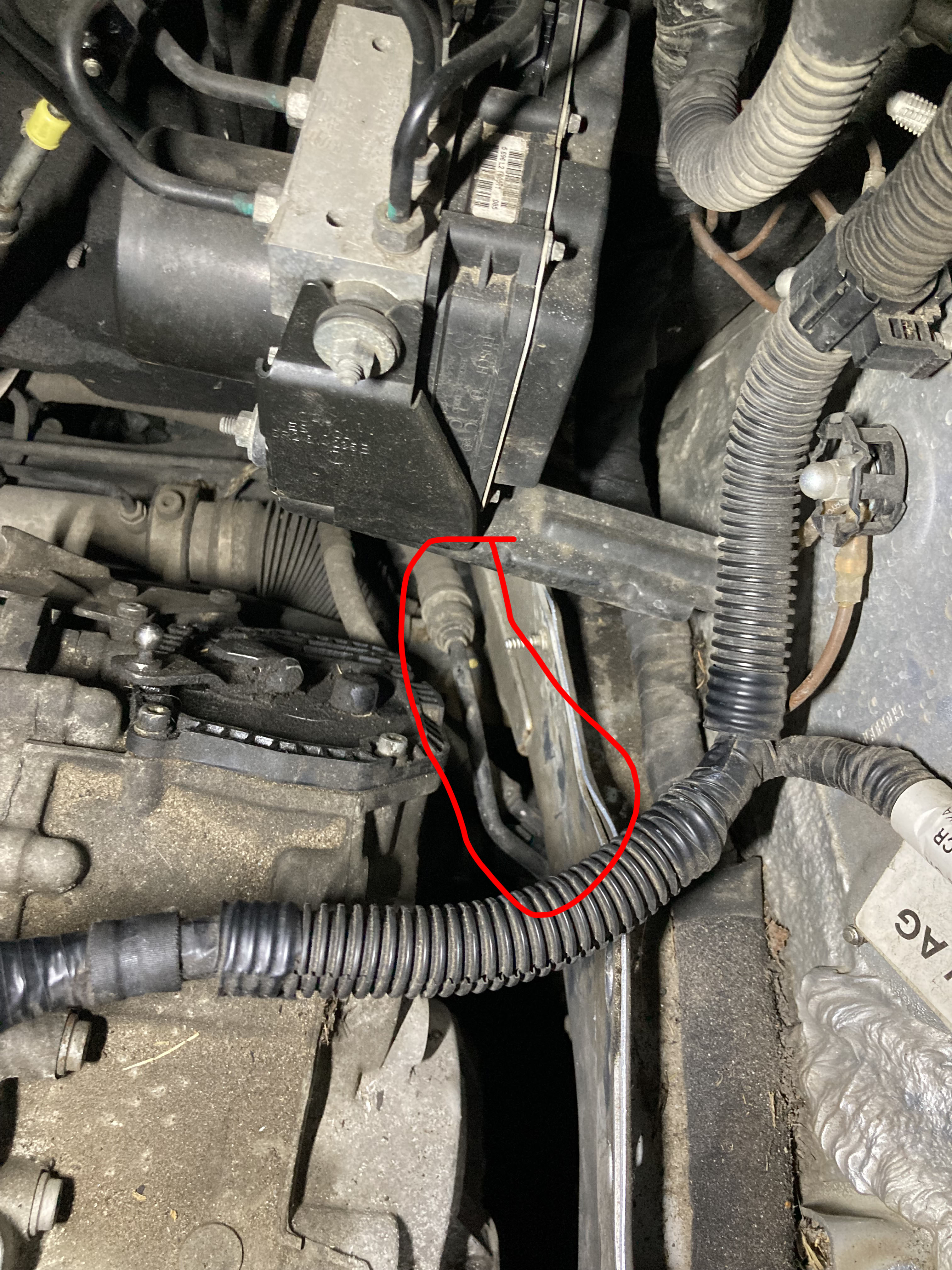

Power steering reservoir unbolted and raised to allow lines to be pushed out of the way.
