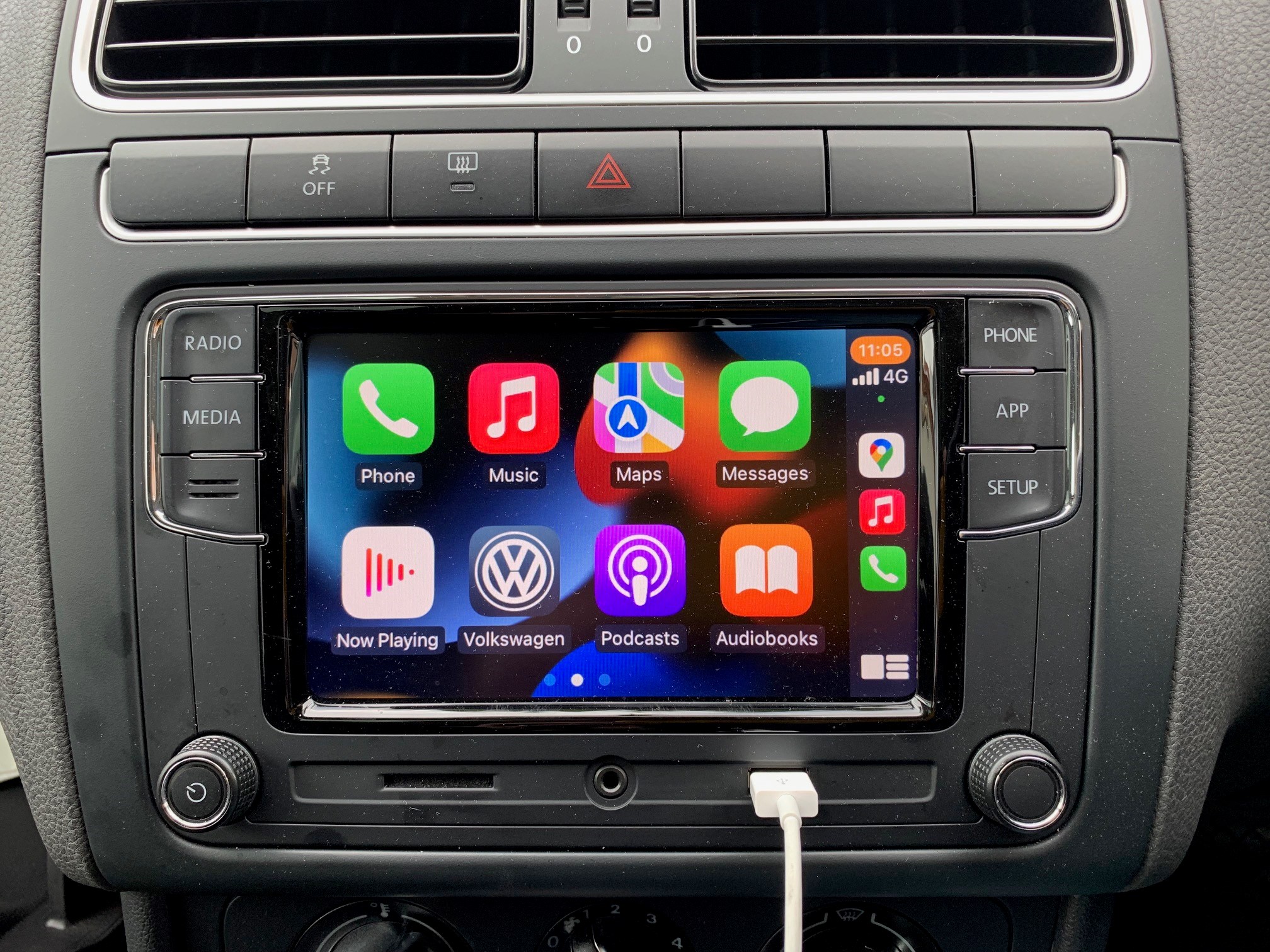

I fitted an RCD330 in my 2012 6R just under a year ago and have had no problems whatsoever with it.
It was a 10 minute installation, very simple and plug and play, fits the existing fascia cut out, no need for a separate Bluetooth module, everything is contained in the radio unit, you will need an aerial adaptor to plug in the back of the unit, but mine came with it.
I did a lot of internet research before buying and found RCD330plus.com very helpful.
There are a number of different versions of this unit and I believe a lot of poor quality fake units in circulation.
I ended up buying a Noname 187B from Aidu Auto on AliExpress, it cost me just under £250 delivered and arrived in perfect condition in just under 2 weeks.
After installation I needed to do a firmware update, but again, very easy to do using a usb memory stick.
I now have Bluetooth handsfree (mic built in the unit so no need for any extra wiring) which works great and is very clear, Bluetooth music, rear parking sensor visualisation work perfectly and Apple CarPlay which gives me sat nav (this is not Bluetooth, you need to plug your phone in to the front USB port).
The only downside for me is that there is no DAB, but overall I am more than happy with the compromise / price point / ease of installation.
I know its not the solution for everyone, but I would recommend.

Thinking of changing mine too, that looks a good option

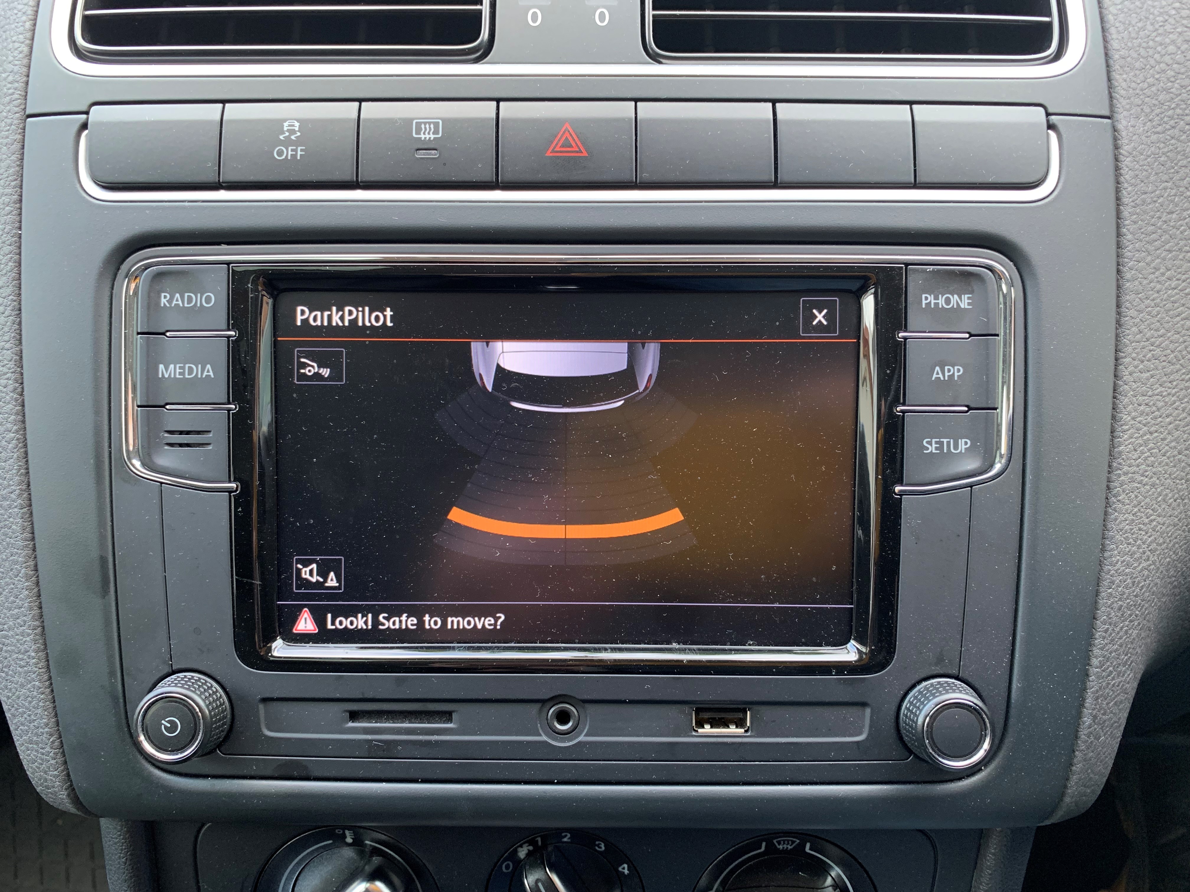

Looks a good option, have you got any photos of the reverse sensor working? Where did you get the update info that you mentioned?

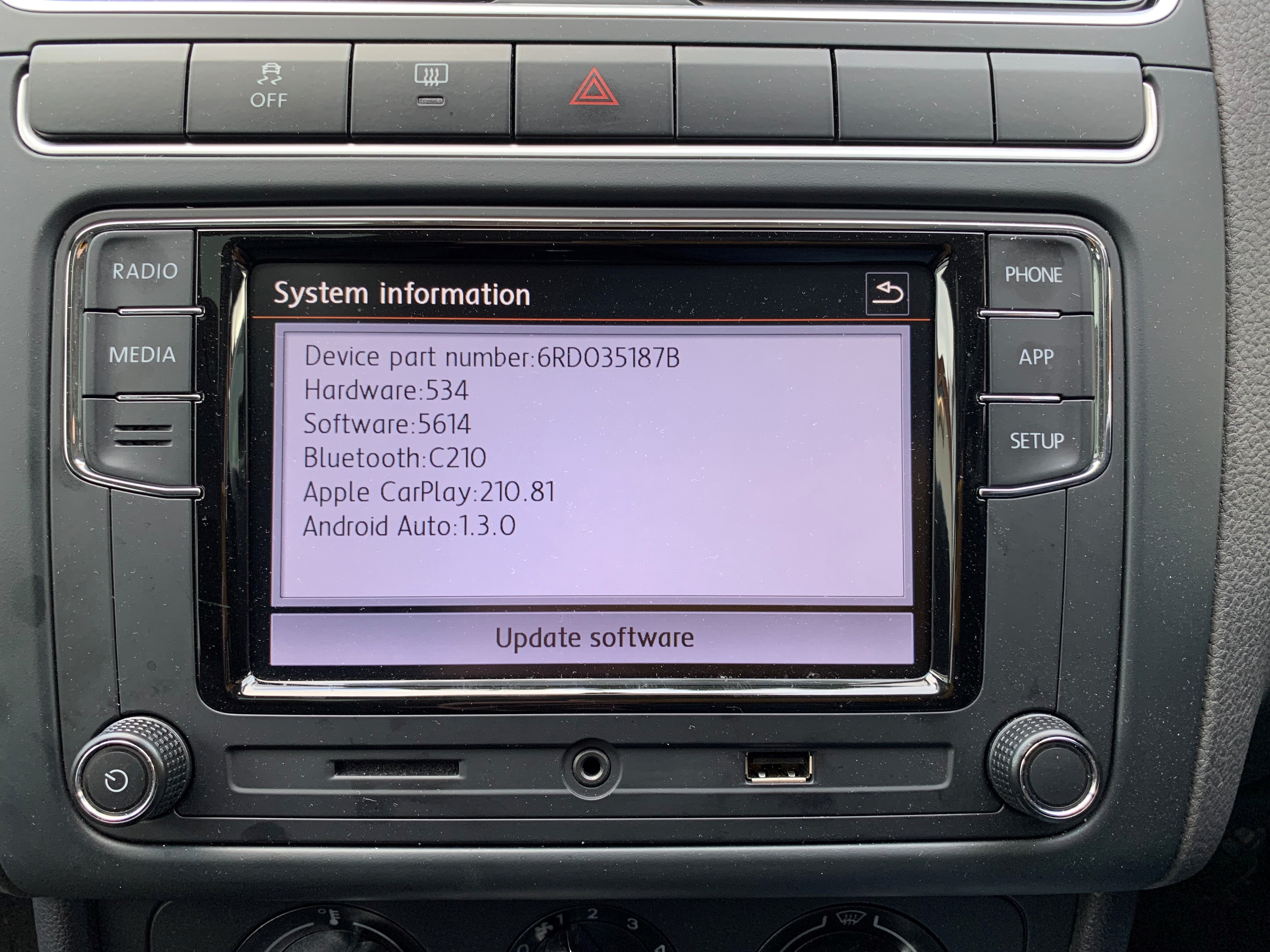

Hi Hpres,
couple of photo's attached.
The Parkpilot image is when parked against a wall, so orange bars are showing flat across, but the display is segmental so does work on angles, etc.
The other image shows the Firmware my unit is running, I downloaded this from the internet about a year ago, there may be newer versions in circulation if required.
Hope that helps.
Hope that helps.

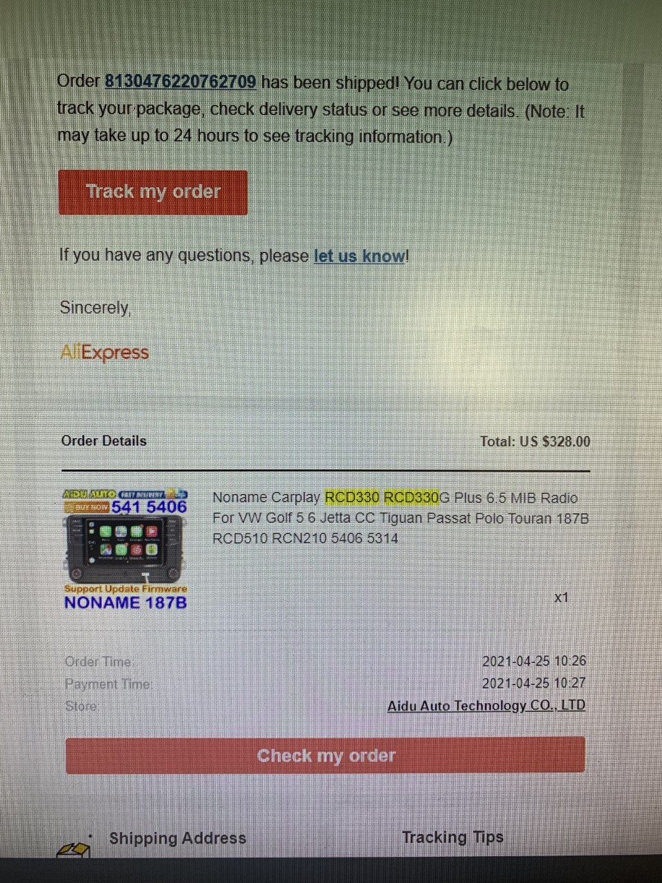

attached is my order confirmation, you can see the seller I purchased from towards the bottom.
I had to upgrade the firmware after installation, if you do buy one and have to do the same, drop me a note and I'll email you the file.
good luck!
good luck!

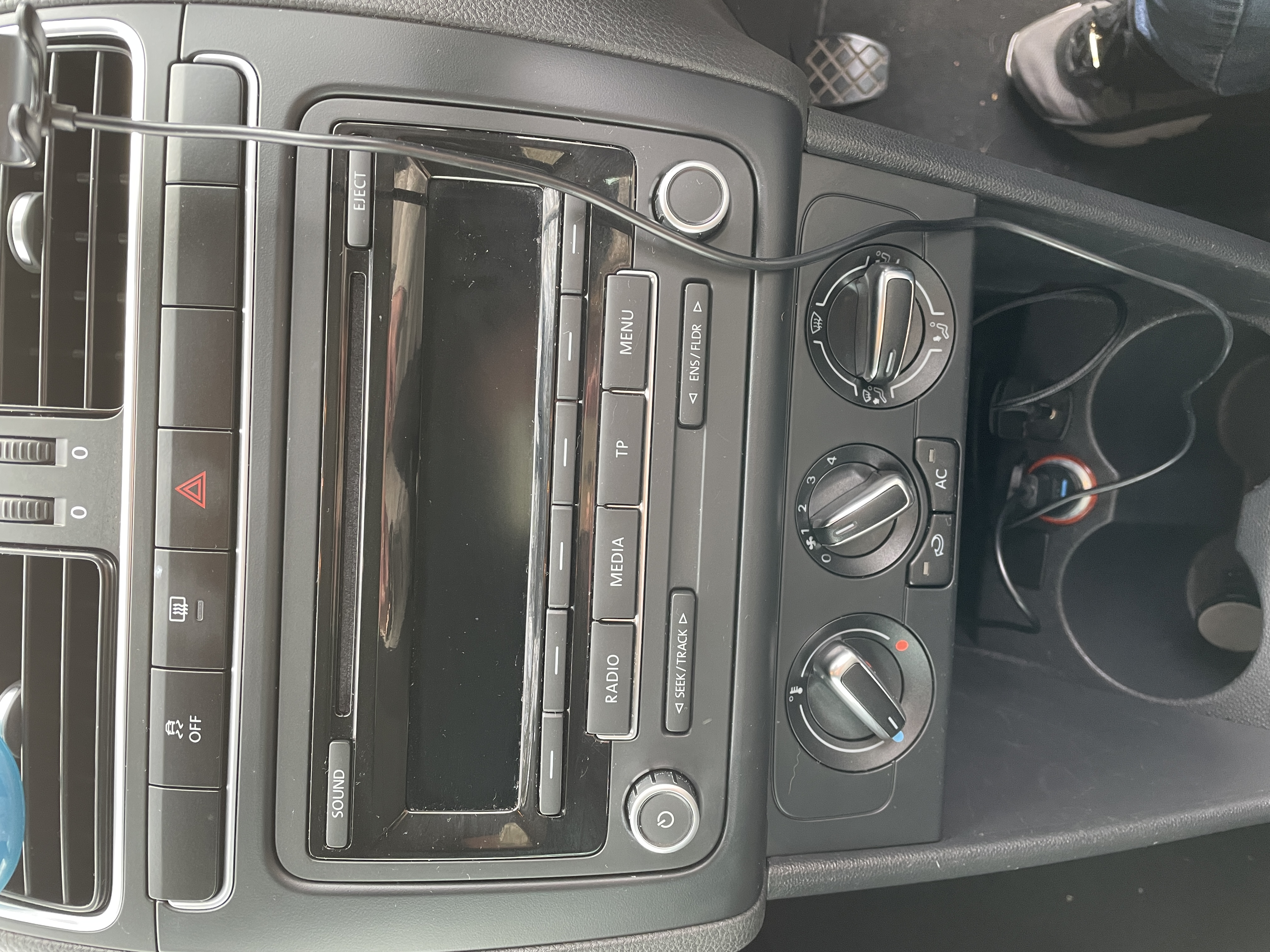

This is his current radio, just want to be sure it will be a straight plug and play and nothing else is required
£269.88 1% Off | CarPlay Android Auto RCD330 RCD340 Plus Noname Radio 187B C210 For VW Tiguan Golf 5 6 Jetta MK5 MK6 Passat CC Polo 6RD035187B
https://a.aliexpress.com/_mrE3xzo
Does this seem right? Just want to be sure before I buy as it is for my sons first car and he’s saved for it himself.

Re: 2011 polo head unit upgrade
Plug and play, but explore the (desay version google about it a bit) before he/you make a purchase.
