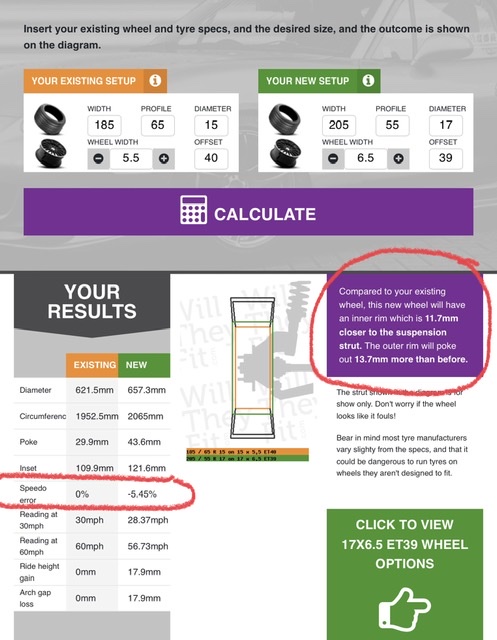

Based on the tyre sizes provided by @Lhzbwz, I think the wheel spec for their existing Polo’s alloys is 5.5Jx15 ET40 and for the T-Cross alloys 6.5Jx17 ET39 (these details were obtained from www.wheel-size.com). Plugging this information and tyre size information provided previously by @Lhzbwz into the calculator on www.willtheyfit.com gives the result in the first screen shot below. As well as a large speedo reading error, the existing high profile tyres would increase the Polo’s ride height by almost 18mm;

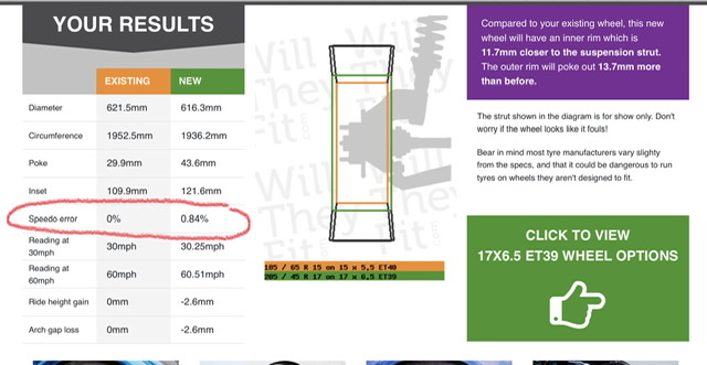

To rectify the speedo reading error and ride height issues, if those T-Cross alloys were to be fitted to @Lhzbwz’s Polo I think the tyres would need to be 205/45 R17. That would reduce the speedo reading error from -5.45% to +0.84% (so at true speeds of 30 mph and 60 mph the indicated speed on the speedo would be 30.25 and 60.51 respectively) and the change in ride height compared to the Polo’s existing ride height would be 2.6mm less - see below;
With 205/45 R17 tyres on the T-Cross alloys;
The changes in poke and tuck (purple box in above screen shots) are based on the assumption that the wheel width and offset details I’ve used are correct. If they’re not then the OP would need to change these for the correct details.
