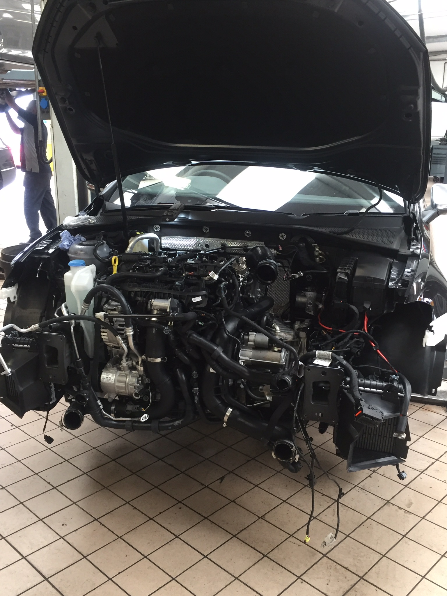

CarbonChaos
Posts: 471
Location: South west uk
Re: Engine replacement
Post by CarbonChaos »
You are correct in thinking the engine and gearbox should be removed as one unit, it’s the best way.
Remove the front bumper then the lights ,crash bar etc, this gives access to the radiator support,remove this completely.
You are now looking at the engine and gearbox once the front is removed, you can do this job at home if your good with the tools no problem
You just have to bite the bullet and remove the radiator support aka core support,use an engine crane to remove the engine and box.
Mk7 Golf R but basically the same process
