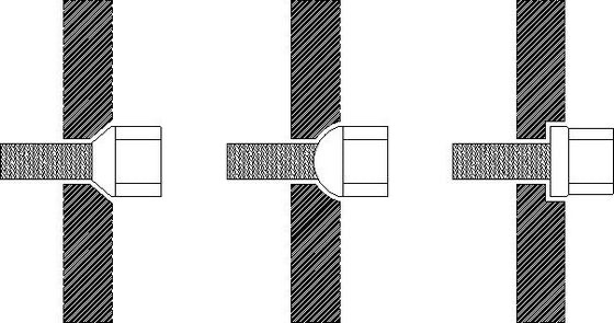

However, assuming your alloys are aftermarket rather than genuine OEM VW wheels, then most aftermarket alloys use bolts with a tapered seat (the bolt on the left in the picture below) whereas VW OEM alloys use bolts with a radius seat (the bolt in the centre of the picture below).
Always use the correct bolt type for the wheels - i.e. the bolts that match the profile of the bolt hole in the wheel - to ensure maximum contact between the seat of the bolt and with the mating surface in the bolt hole of the wheel. Use of the wrong bolt type could mean it’s not possible to tighten them to the correct torque setting and / or they could work loose.
If in doubt, then check with the retailer you purchased your wheels from - for safety’s sake, it’s really important your wheels are safely attached to your car using the correct bolt type, they’re tightened in the correct ‘star pattern’ sequence and to the correct torque setting.

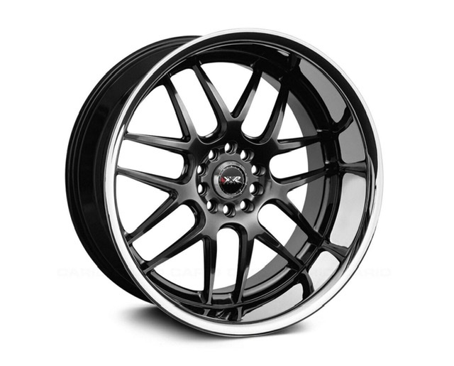

Can you just clarify the PCD of the wheels you’ve bought; in your original post you’ve stated it’s 5x100 / 5x114.3. The Polo’s PCD IS 5x100, so are your new wheels dual fitment? - i.e. do they have 10 mounting holes in the centre rather than five - like in the picture below - so they can fit vehicles that have a PCD of 5x100 and also fit vehicles with a PCD of 5x114.3?
yes they are dual. that picture you posted happen to be the wheels that I've purchased the xxr 530s
