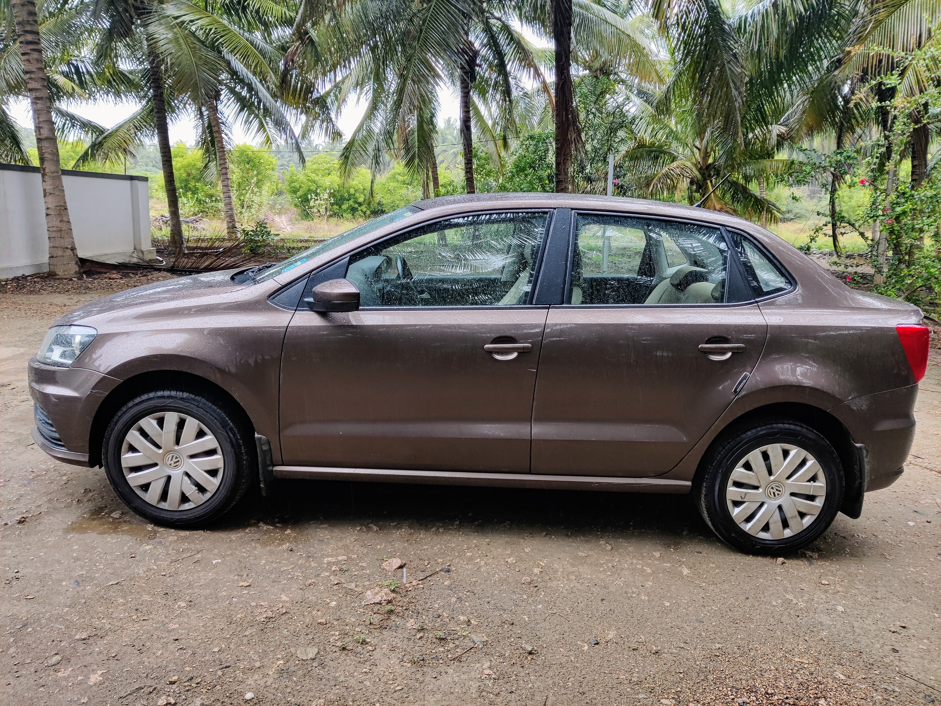

Hai All,
My daily drive is a VW Ameo, A car which is created specially to comply with a weird govt. rule wherein the cars which come under 4 meters in length will enjoy a lower tax slab.
The Ameo is essentially a shortened version Polo 6R Sedan with the wheel base of a polo 6R Hatch.
I have been amazed to see people doing crazy retrofits to their cars and I am delighted to be a part of this community.
I am new to this retrofitting world and have done some retrofits in my car:
1. Installed a MFSW Steering wheel.
2. Upgraded the Stock radio(RCD320) to a OEM Visteon RCD330 Unit and installed the OEM reverse camera.
3. A Maxidot Cluster from a Seat Toledo with SW0607 and HWH16(Installation In progress).
4. Cruise Control System.
Planned Retrofits as of now:
1. Gra-HIGH Activation(If possible)
2. 8k OPS(Parts are on their way)
3. BCM Max and associated retrofits like TPMS,etc.
and finally a DQ200 DSG/ AQ250 Torque converter in the future :D .

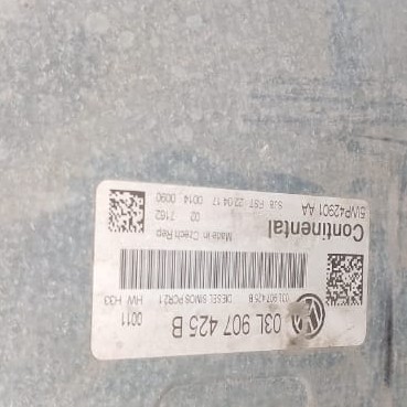

I Need some assistance in enabling Gra- High in my car,
my car has the following ECU:
Continental 03L 907 425B Diesel SIMOS PCR21.
A Seat Toledo Cluster with SW 0607.
Can the Gra-High be activated on the above ECU and the Cluster combination or do i need any emulator to do this?
Any assistance would be helpful.
WhatsApp Image 2022-07-04 at 11.41.03 PM.jpeg (37.59 KiB) Viewed 2697 times
Last edited by nithishsabapathi on Thu Jul 07, 2022 4:39 pm, edited 1 time in total.

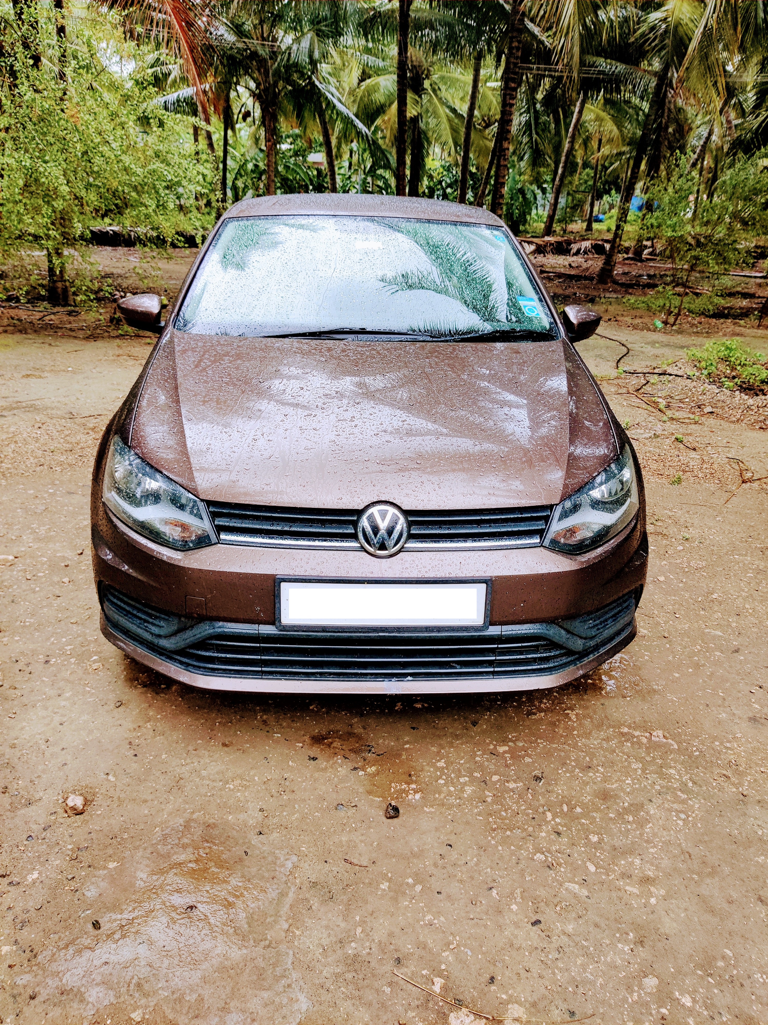

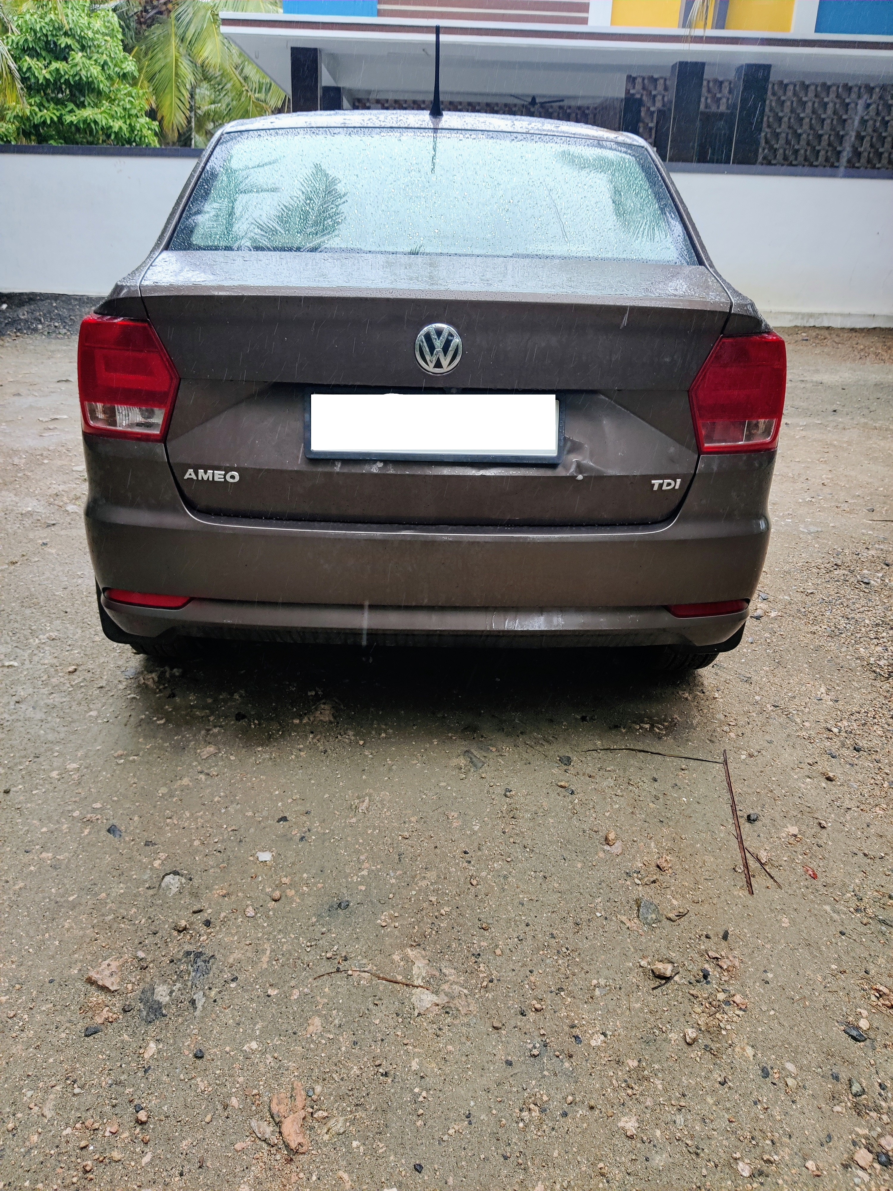

Sorry Guys! Bit caught up with work. Adding photos to the original post.

Regarding GRA high--
Your Simos PCR 2.1 ECU can be read by using tools like Kessv2, FGtech gelatto easily I guess. I am pretty sure there are tools to read and write your ECU without dismantling it. The biggest hurdle is to know if your ECU firmware supports GRA High, if yes then next hurdle is to know the exact address to activate it.
You must find a car having same ecu/engine having GRA preactivated from factory to begin with. You also request for help from Master Ciclo, Slavik, firegrafik... they have done extensive research and work on GRA activation. I think it's a tough job, but you can always give a try.👍
patil
Posts: 577
Re: Nithish's Polo 6R(Ameo) 1.5TDI
Post by patil »
I can say with absolute certainty that it is indeed possible to activate GRA High in your Simos PCR2.1 ECU without need of any kind of emulator.
Ofcourse with the help of right tools and right people. :wink:

you can use 0729 firmware from amarok 2h0.
just dit it on my toledo, I have an issue with my mfsw but it is SEAT related, otherwise it is ok
Also I have almost the same ecu , I am interested in GRA-High too
