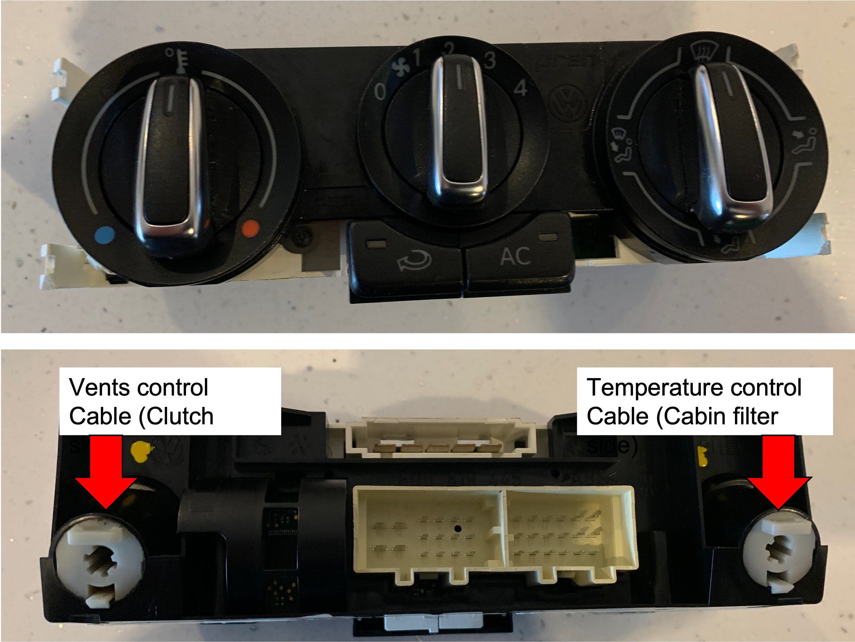

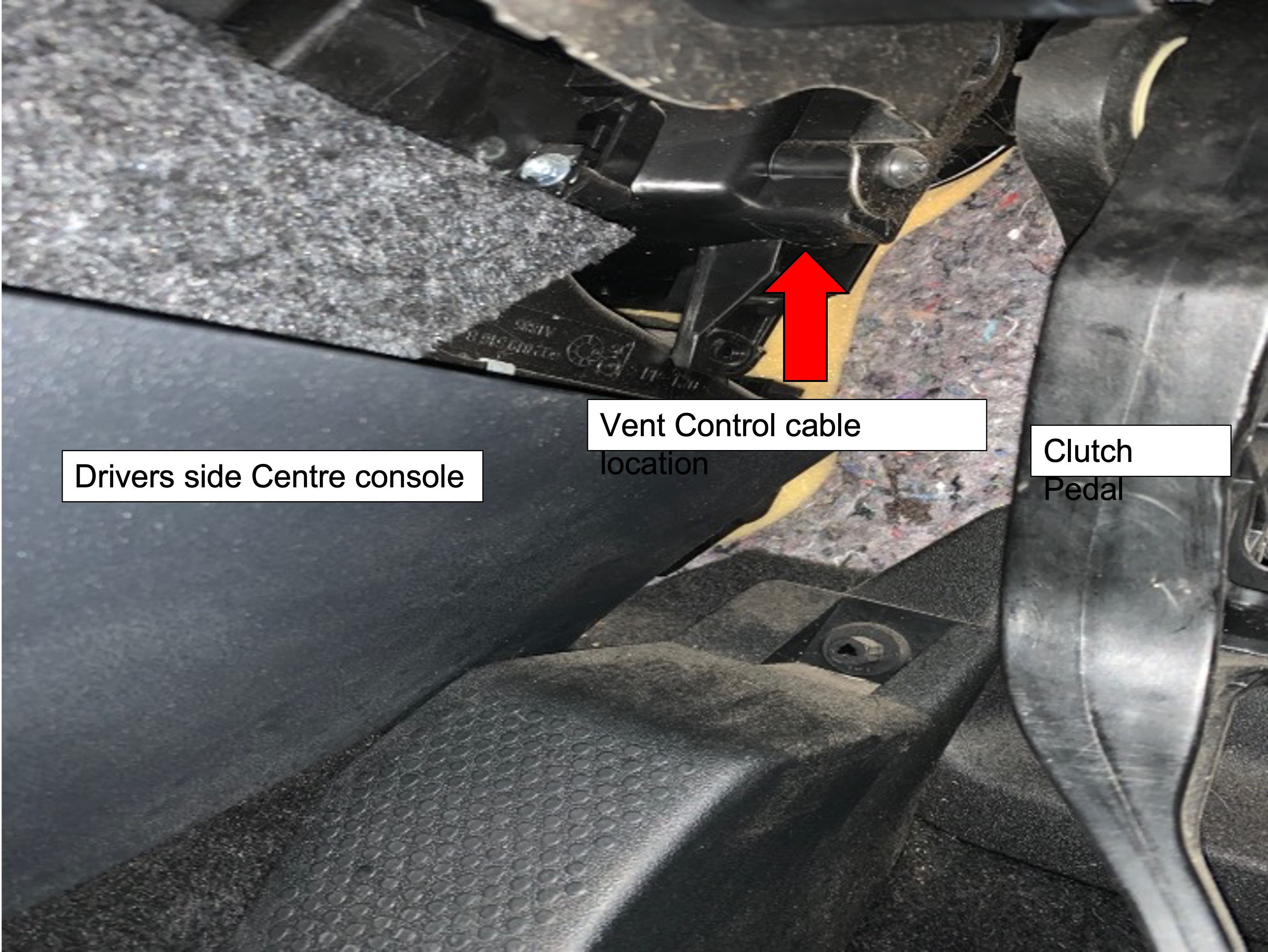

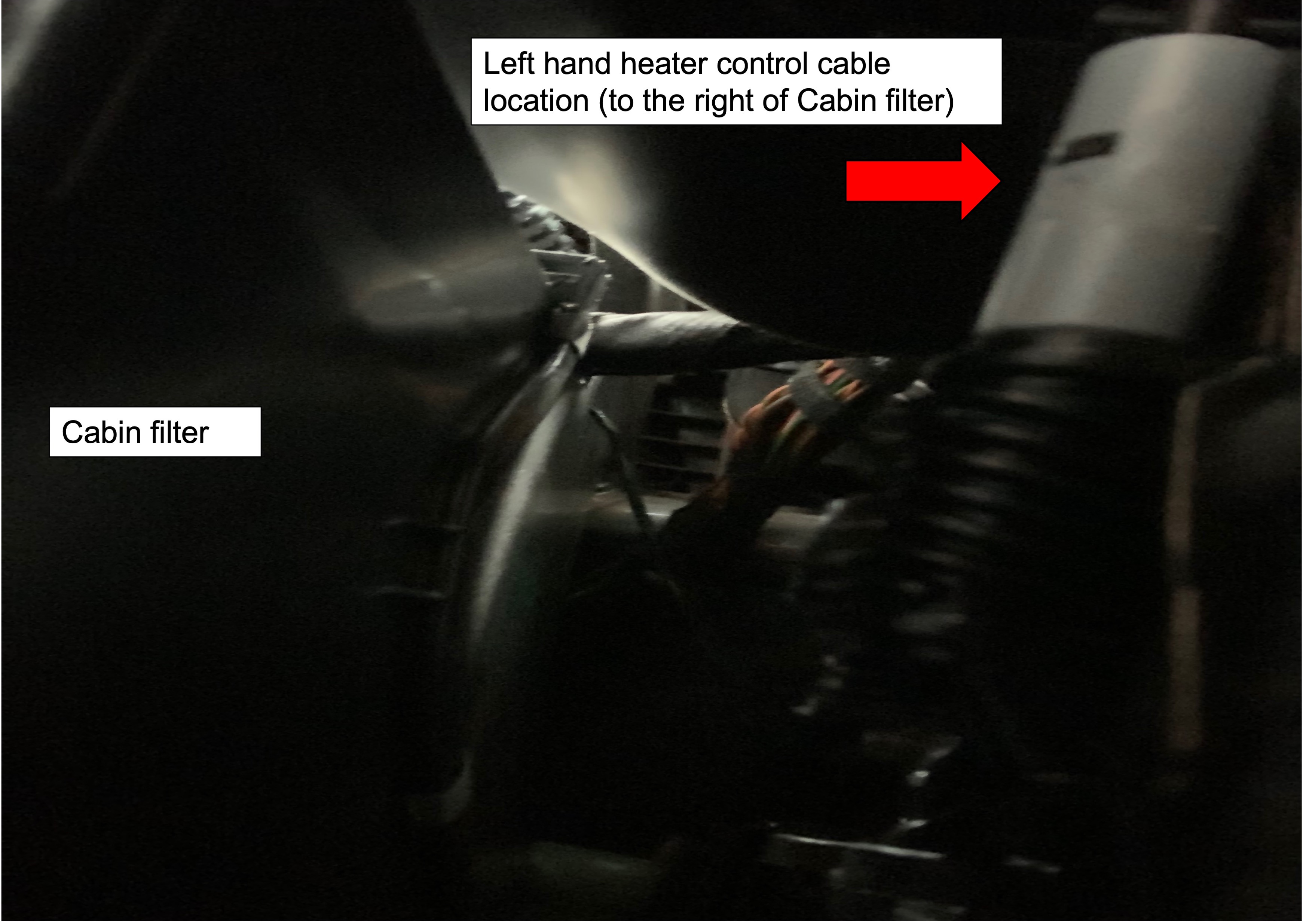

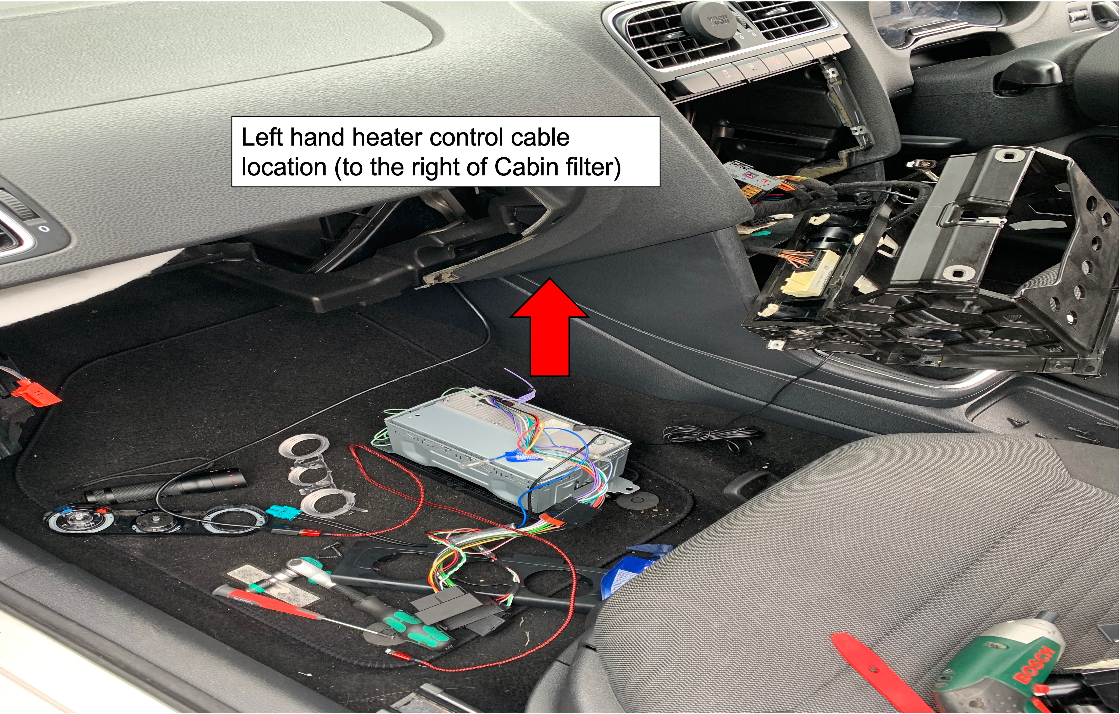

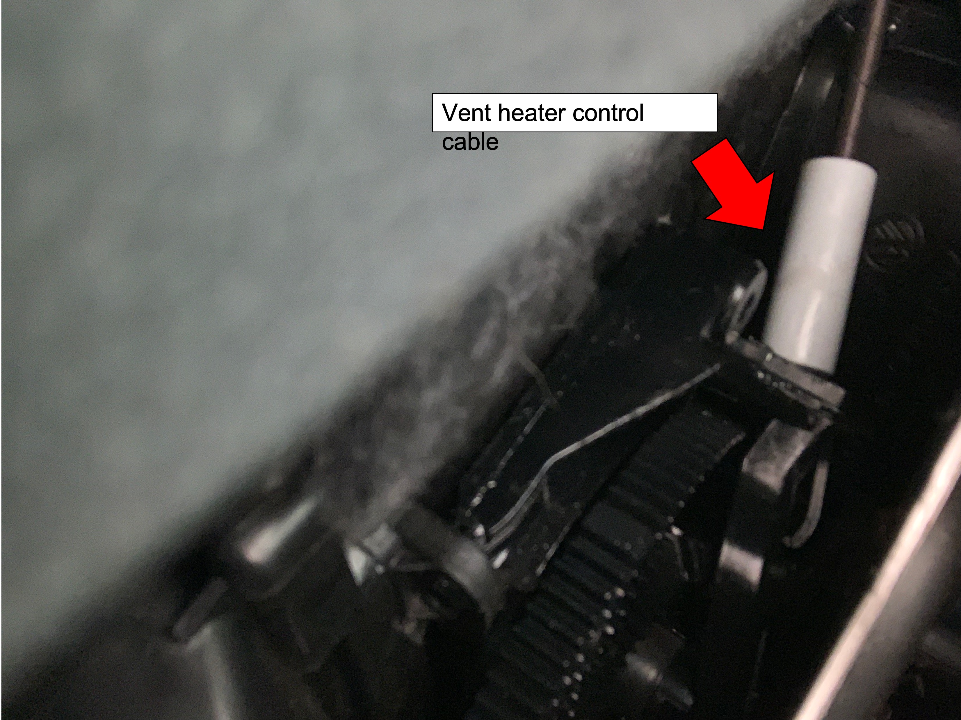

Just thought I'd post a couple of pics as I've changed the heater/AC unit in son's Polo 6R and I couldn't find any pics of the Control cable locations (opposite end of unit).
When I removed the old unit the cables came away and typically I didn't see where they came from.
Anyway after getting under the dashboard I eventually found them and have taken some pics so that hopefully it will help out others.
