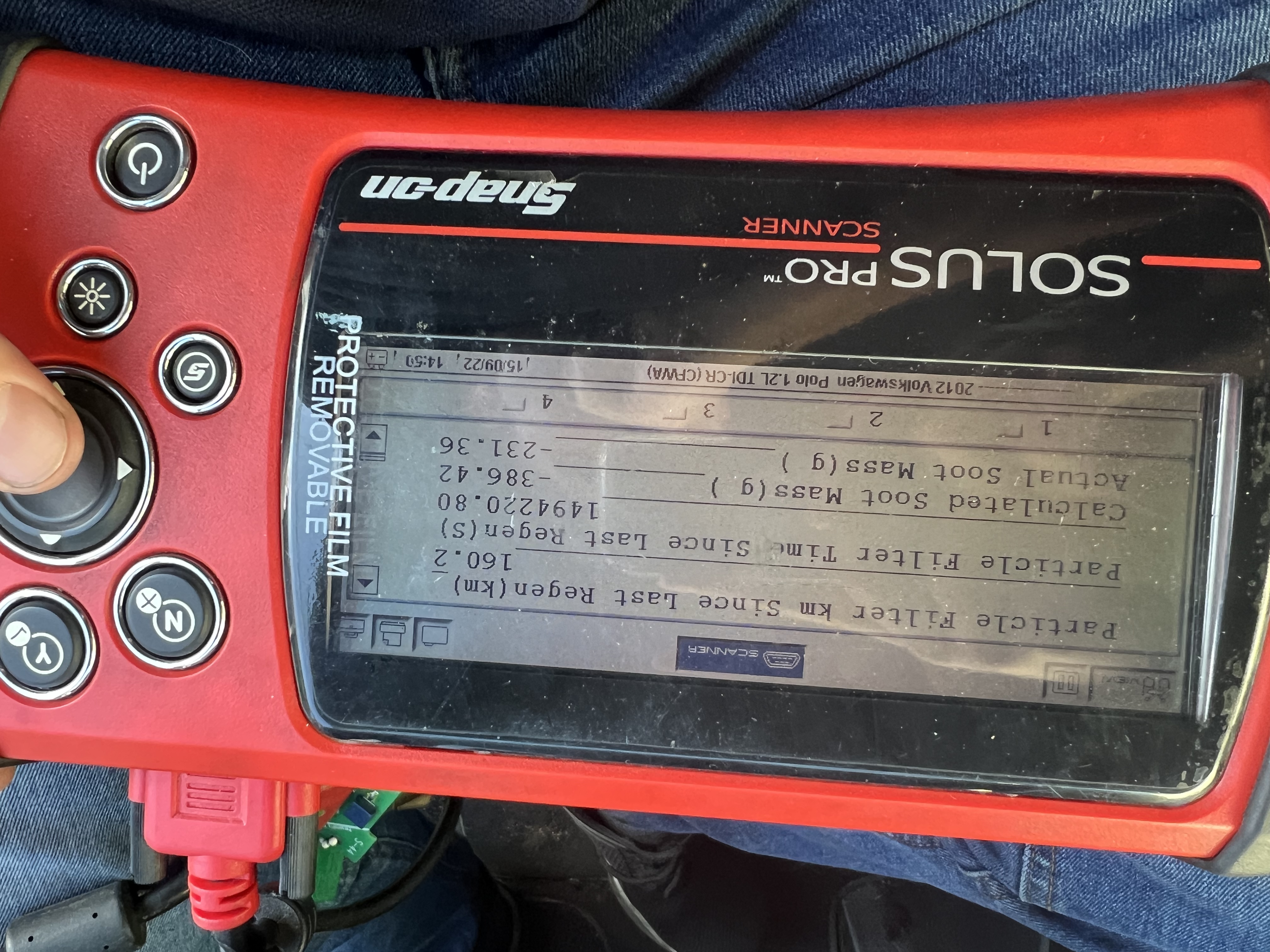

Also took this picture from the plug in if it’s helps Image
Re: DPF Light, Eng Managment Ligh, and Flashing Glow Plug Light
Negative soot masses do not sound plausible to me

Yeah I thought so to, I think I am going to replace the differential sensor first and go from there.
