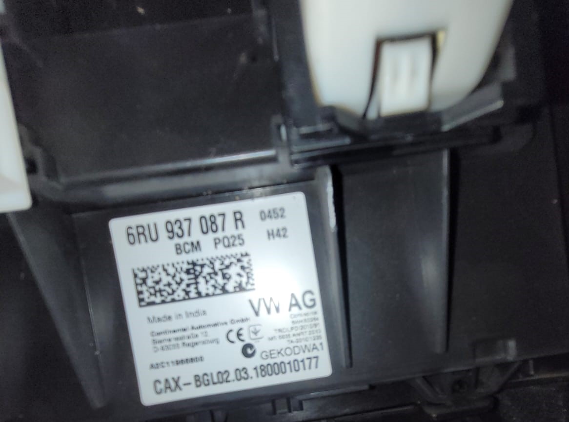

Hello,
I'm looking to upgrade my stock halogen headlight cluster to the OEM Bi-Xenon unit on my Polo 6R.
The Stock BCM is a 6RU 937 087 R
I'm fairly new to this scene and I'm reaching out for guidance and assistance on what I would be needing to procure and change.
Thanks in advance :)
P.S: I have attached a picture of my Stock BCM to this post.
Stock BCM - 6RU 937 087 R
Polo 1.2 TSI Stock BCM.jpeg (115.94 KiB) Viewed 2384 times

Your stock BCM doesn't support OEM bixenons. You need to upgrade your BCM High to BCM Max. And also need to do wiring for BCM Max and adaptation before installing OEM bixenons/ led headlights.
