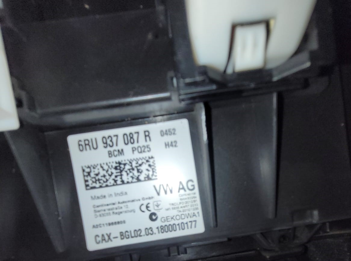

I'm looking to upgrade my stock halogen headlight cluster to the OEM Bi-Xenon unit on my Polo 6R.
The Stock BCM is a 6RU 937 087 R
I'm fairly new to this scene and I'm reaching out for guidance and assistance on what I would be needing to procure and change.
Thanks in advance :)
P.S: I have attached a picture of my Stock BCM to this post.
Stock BCM - 6RU 937 087 R
Polo 1.2 TSI Stock BCM.jpeg (115.94 KiB) Viewed 2383 times

Your stock BCM doesn't support OEM bixenons. You need to upgrade your BCM High to BCM Max. And also need to do wiring for BCM Max and adaptation before installing OEM bixenons/ led headlights.
Let me make you aware of the fact that, this oem bixenon retrofit is no ordinary feat if you intend to do it in a perfect way. You need to learn and understand many things, need to invest lot of time, lot more of money and dedication. It's a long journey for you if you are willing to endure and succeed. This forum has all the information you need for your retrofit. Definitely experts from the forum will lend you a helping hand whenever required.
