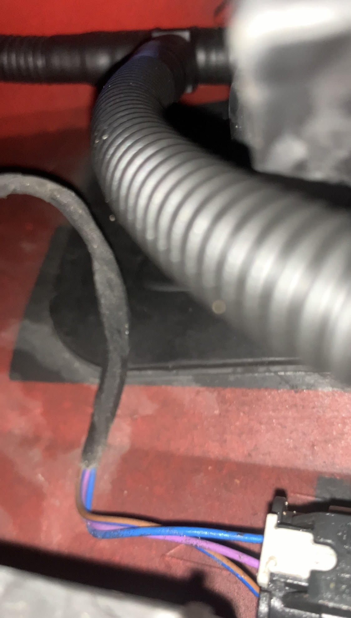

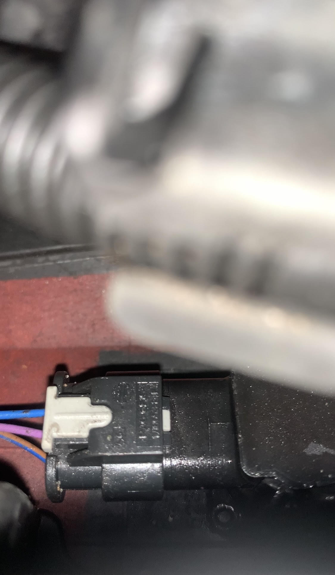

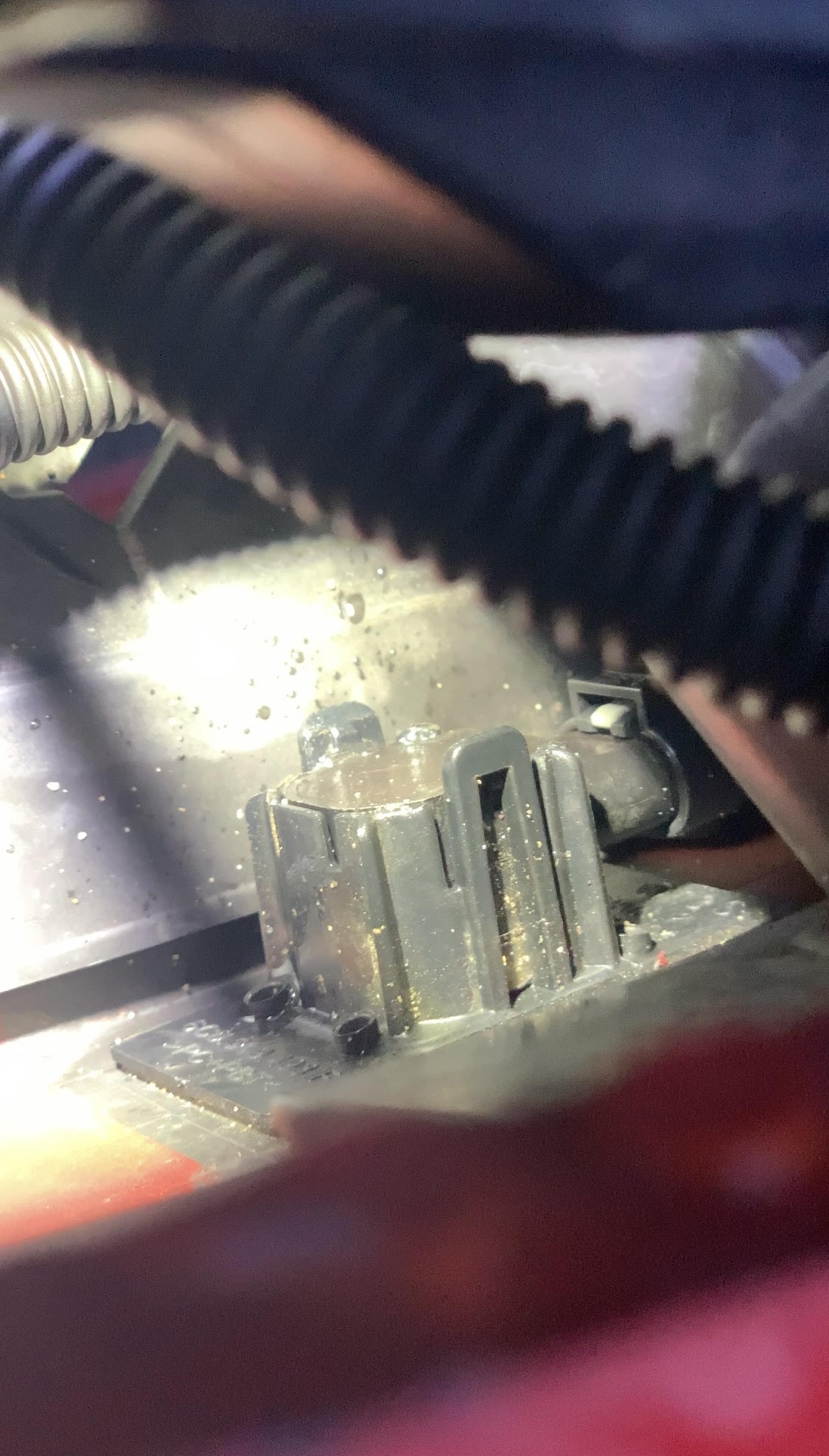

After giving it some time, it seems the short is caused by water ingress into the sensor. I've only had the fault return once in 10 days and it went away in the same drive within 5 minutes. Access to the sensor with the bumper still on the car is very limited so I think I'm just going to see if the issue happens more frequently before I decide to have a good go at sorting it.
I managed to shove my phone in the gap created by removing the headlight and saw that the sensor itself was quite wet compared to the rest of the inside of the bumper. As well as a place that looked like the wiring was in contact with the bumper without any protective sheath and could be susceptible to rubbing through.
For now, I've blown off the sensor with compressed air from the inside and outside of the bumper to try and get any trapped water out that may have gotten through the seal between the sensor and the bumper.

- Posts: 6089
Re: Parking sensor open or short to ground
Do you think that with the info these pictures have given you that you could remove that parking sensor, as you can see, the sensor is clipped into the mounting bracket at 2 points, so easing these clips up a bit and then applying a bit of pressure from the front of that sensor should allow it to come out of the bumper skin, I'd think that the connector just needs that white tang pulled back and then you could pull that connector off.
Edit:- the unprotected short section of the wiring will be normal and I'd doubt if there was much if any relative movement taking place.
Bepis
- Posts: 332
- Drives: 2017 6C GTi Manual
- Location: North West
Could be possible just depends on how much pressure is needed to open the clips to get the sensor out as I'm only able to get one hand in. Also doesn't help that I won't be able to see what I'm doing.
Annoyingly removing the fog light didn't really do anything for access or visibility as the bumper support/headlight bracket (visible in pic 2) makes it impossible to reach it from underneath.
