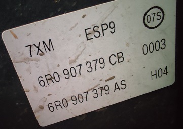

Hi Guys,
Recently I purchased an Amarok MFA+ cluster. and after connecting to my Polo 6R the immobiliser got active and it cleared my ABS coding. After reinstalling my stock cluster, I was getting ABS and traction control lights, After adding a new coding via a Bluetooth OBD connector. I added a ABS coding and now just the Traction control light is being displayed and one error persists saying something like "ESP basic Settings" which gives me doubt about the ABS coding isn't the right one.
I don't have a VCDS cable with me else I would have attached the whole scan along with the post. From what I have been able to gather I have an ESP 9 ABS module.
Could anyone please help restore the original coding?

Re: Polo 6R - ABS Coding Wipped off.
Sounds like your coding is fine and you need an obd scanner to finish basic settings of the esp unit.
Post by SanketM »
Thank you iichel, For coming to my rescue. I'll try and an obd scanner and try to completed the required setting. Could you please help me understand what I should be doing to resolve the issue ?
Start the engine, access the module with your scanner, security access 40168 (from memory), press the brake hard and releasy, basic settings, ESP function test or basic settings for ESP. The exact wording differs from scanner to scanner so I'm unsure.

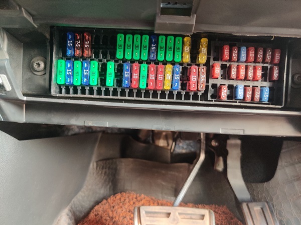

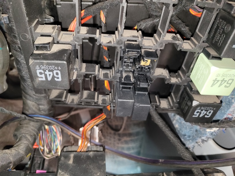

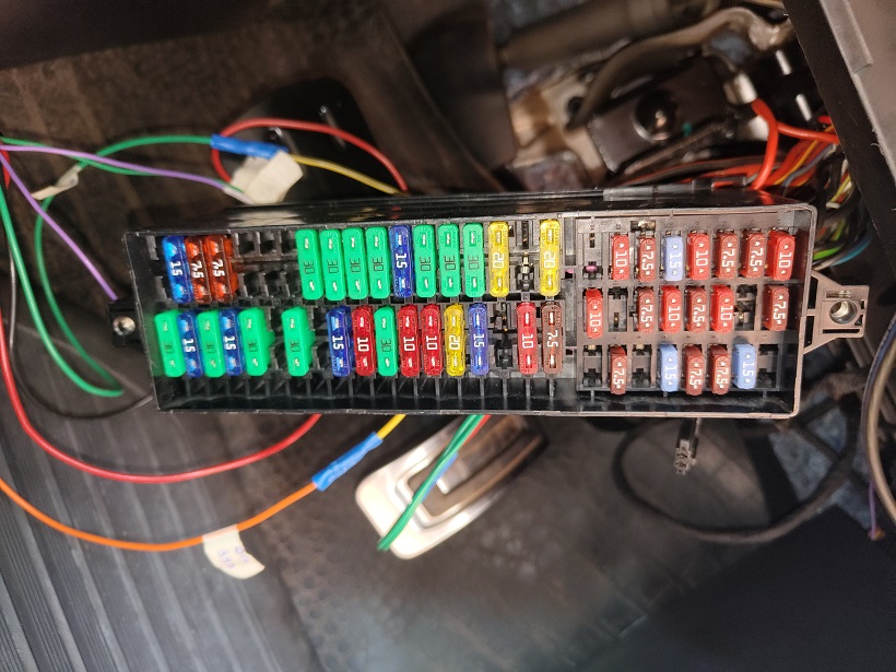

As of today, I am in a soup. I had purchased a BCM Max wiring locally and tried installing it myself over the last two weekends. I did finish the BCM Max installation yesterday and then went on to install auto headlight wiring which I had purchased from our fellow member sparrow77.
After completing the installation, when I connected the battery terminal. My Right side low beam came on when I connected the battery terminal.
But good news
1) The car is Starting :) a relief for me considering it was my first time taking on something of this nature installation. Of course learnt numerous things while carring it out. Damaged a few butt connectors broke a MQS Terminal and repaired it due to unavailability if it around the place I stay. (I'll replace this asap)
2) As soon as I put headlight switch to Auto, the low beams came on. Tail light, turn signals, and front fogs work fine. (Didn't get to check then SCL)
Issue which I am currently present
1) The right side low-beam remains on after locking the car. I have to remove the battery terminal to stop it from draining battery(task successfully ac).
2) The rear fog light also comes on as soon as I put the headlight switch to the parking light.
3) Both HighBeams don't come on.
4) Driver side power window switch seems to be inverted If I pull up the button meanT for fronT passenger window it ends up executing that command on driverside window and vice versa. (powerwindow switches on other doors work perfectly well)
5) As soon as the headlight switch is moved to parking, the Instrument cluster and Discover media buttons light up fine so do the MFSW button backlights. But backlight for door buttons doesnt come on.
6) HighBeam comes on when the light Stalk is pulled to flash. It also appears in the cluster when its pulled. But when its push to turm the high beam on it doesnt come up doesnt come up in cluster too.
Note: Dimmer connector T6/3 has been attached but the dimmer switch is in transit and will reach me by mid of this month
I am attaching autoscans with BCM High and BCM max.

Address 03: ABS Brakes (J104)       Labels:. 6R0-907-37x-ESP90.clb
   Part No SW: 6R0 907 379 CB    HW: 6R0 907 379 AS
   Serial number: --------------
   Coding: 62DD2463422403C4461D246D4259C0800808
   Shop #: WSC 12345 123 12345
   VCID: 000F35079B030A93C3-8054

Stock FuseBox
Stock FuseBox.jpg (115.37 KiB) Viewed 18223 times
After BCM Max Adaptation
FuseBox After BCM MAX Adaption.jpg (194.1 KiB) Viewed 18223 times
Relays After AWL adaptation
Relay After BCM MAX Adaption .jpg (227.25 KiB) Viewed 18223 times
