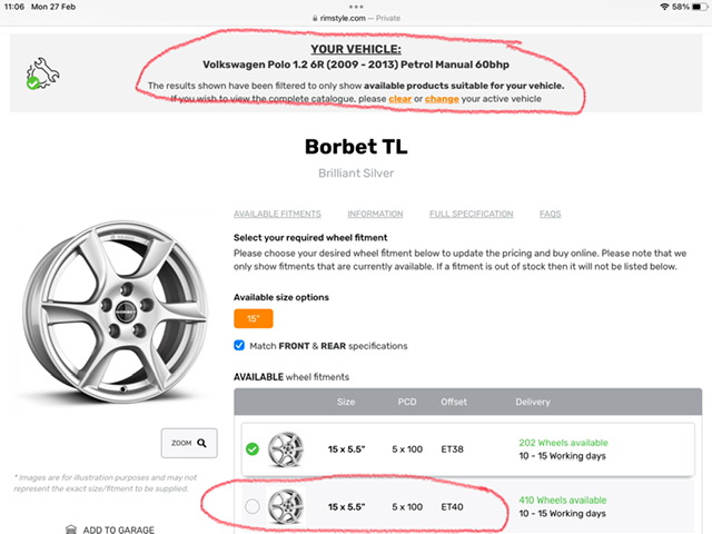

I’ve checked on one of the alloy wheel retailer websites (Rimstyle.com) to see if they confirm 5.5J x15 ET40 alloys are an appropriate size for your car and they do confirm they’ll fit - see screenshot below. However, the design of some alloy wheel’s spokes may mean that not all 5.5J x15” ET40 alloys will fit your car and could give brake callipers clearance issues.
You could fit spacers and longer bolts; if you do this, make certain any replacement bolts are of the correct thread and that they have a radius / ball head so the bolt head profile matches the profile of the bolt hole in the wheels. Also, fitting different sized / spec alloys and / or wheel spacers is a modification for insurance purposes, so you’d need to inform your insurance company and they may increase your premium (some insurance companies are more mod-friendly than others).
