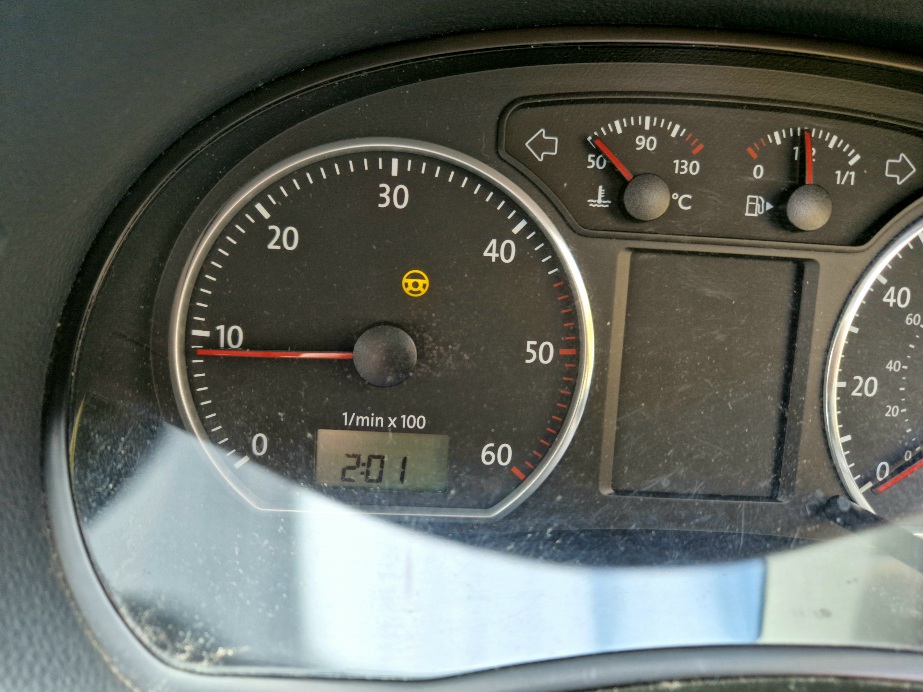

Hi guys.... so I've got a 2008 1.4TDi Dune... I'm getting intermittent power steering warning light coming on.... I've topped the fluid up but still comes on every now and then.... I'm also getting an intermittant, annoying squeak coming from the steering wheel, from somewhere in the column just behind the wheel.... any thoughts???

OBD says no fault stored in ECU 😖
Fault light just came back on, rechecked but no fault showing on OBD 😖
Fault light
Fault light

Nothing in adress 44?

A basic obd reader will ONLY read the engine ecu
Maarten
Posts: 557
Location: The Netherlands
Re: Power Steering Warning Light
Post by Maarten »
I did not know that.
Power steering fault should not be stored in the engine ECU memory.
Usually in adress 44 Lenkhilve/steering aid
I would suggest to go to someone that does have a full OBD2 scanner/reader.
Faults like this will most certainly be stored in the controle module as at least intermittent fault
