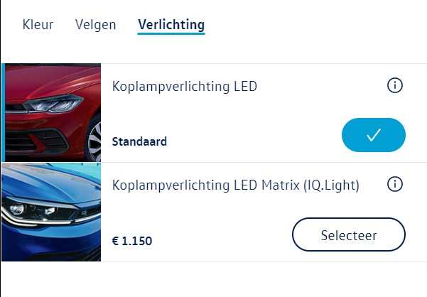

AFAIK all polo AW have LED headlights.
Only difference is normal LED or matrix IQ LED
Translation:
Headlight LED (standard)
Headlight LED Matrix (IQ.Light)
Translation:
- Posts: 3850
Re: Led lights on a polo
In the UK, all facelift (BZ) Polos have LED headlights but with the pre-facelift (AW) model, only the GTI+ model had LED headlamps as standard; they were an extra cost option on all other trim levels other than the entry level ‘S’ model where they weren’t available.Maarten wrote: Tue Mar 21, 2023 1:18 pm AFAIK all polo AW have LED headlights.
Translation:
@RealInsky; your forum signature shows your car as a 2021 Polo in Comfortline trim. If those details are correct, then a 2021 model Polo will be a facelift car in which case as @Maarten has said, your car should already have LED headlights.

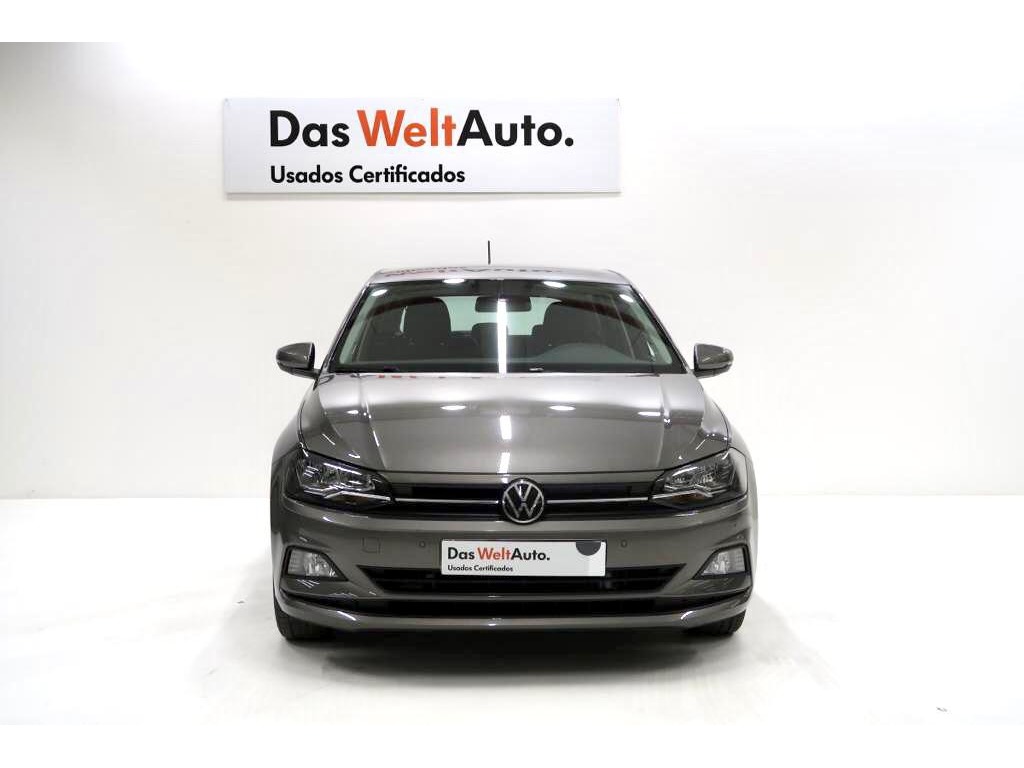

Its the same as this oneMaarten wrote: Tue Mar 21, 2023 2:40 pm Probably Halogen, but please share the pictures later today.
- Maarten
- Posts: 557
- Location: The Netherlands
Yes that's a halogen lightunit
