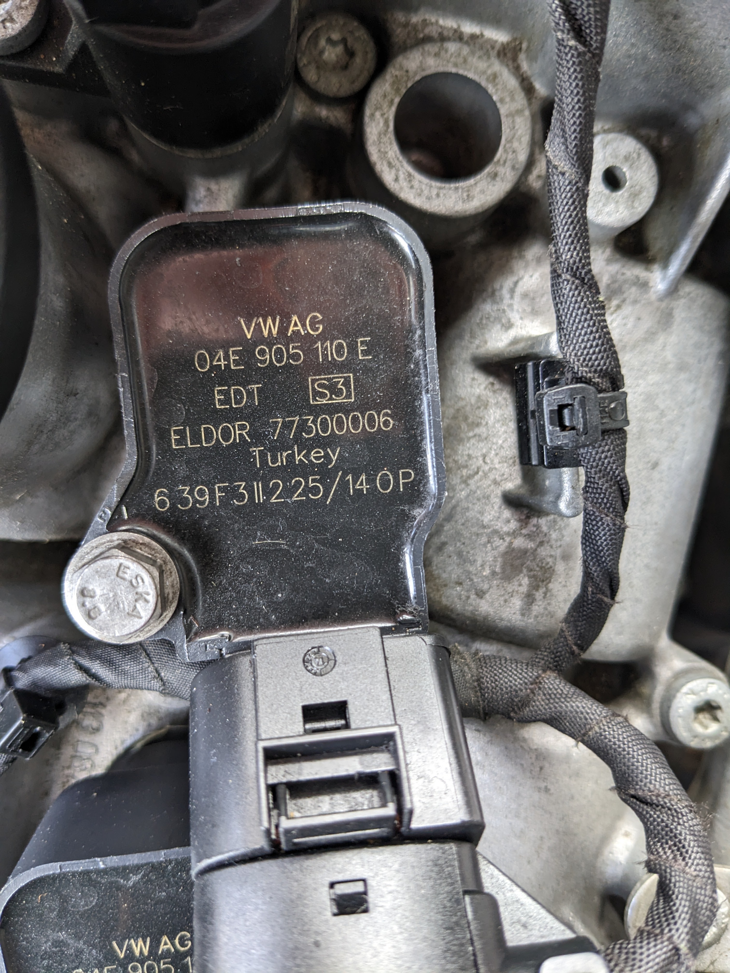

This is the coil igniter model I currently have:
Original ones because VW change for an other Part Number: 04E905110P

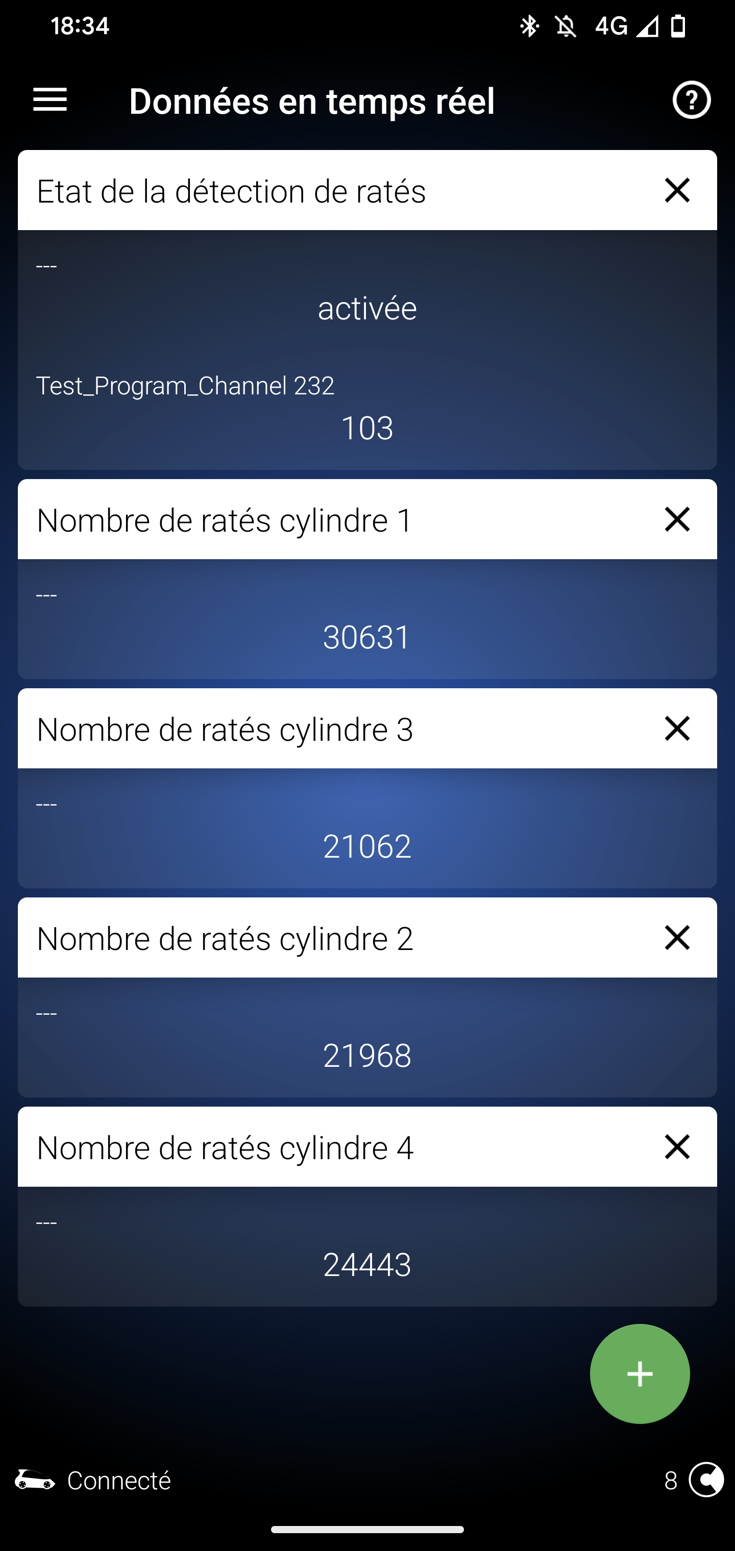

My OBDeleven record some few missfire on all pistons but nothing to worry about because on full throttle and daily drive the car feels nice.

Yup, but at 60 euros the coil ignition: it's quite expensive :v
If I buy it will be ELDOR (original brand put on my car) or BERU.

On OBDEleven you can see all cylinders missfire. It's like a counter.RUM4MO wrote: Fri Mar 31, 2023 5:02 pm I would hope it this was a coil issue, then a proper scan tool would provide details as to which cylinder coil or cylinders coils were causing a spark plug firing to be missed.
These coils do not have a recommended service life, so they only need replacing when they or one of them has failed and this is getting recorded by the engine controller.
Also, I seem to prefer Eldor as a coil manufacturer.
As said already, this could be spark plug failing to fire, they need replacing every 4 years or maybe 60k miles.
Finally there can be other reasons why a cylinder misfires at light load or lower throttle openings, for instance failing injectors or failing Lambda sensor, the control one is the one nearest the engine end of the exhaust system.
Car is daily drived at 90% on highway. Only weekend few kilometers on city but over 400 on highway each week.
So I don't think engine is dirty.
The gap for the spark plug (brand new) is about 0.7mm.
However, injectors have been never cleaned (ultrasonic for exemple).
Missfire count on OBDElven since the begening of the life of the car:

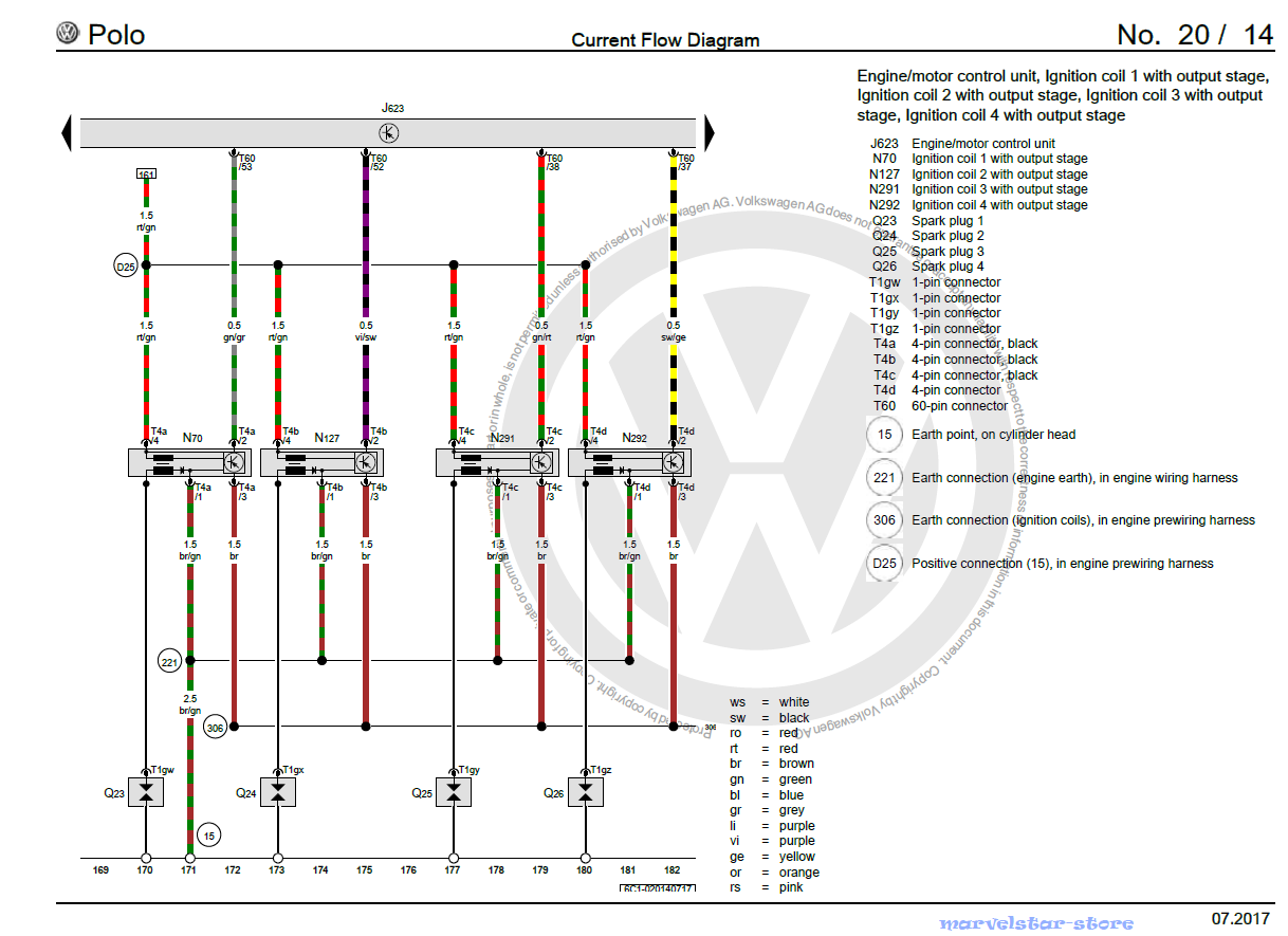

The only thing that I can think of that might cause these coils to missfire, could be the earthing lead that is associated with the coil firing cableform, I seem to remember that there is a heavy brown lead connected to the cylinder head, if I am correct, is it still looking okay?
- Le_Combattant
- Posts: 513
- Location: France
Re: 1.2 TIS Coil Igniter life time
This is the Wiring Diagramm od my car:
So yes, I have to check the wire "15", at least, the state of the ground connector.
