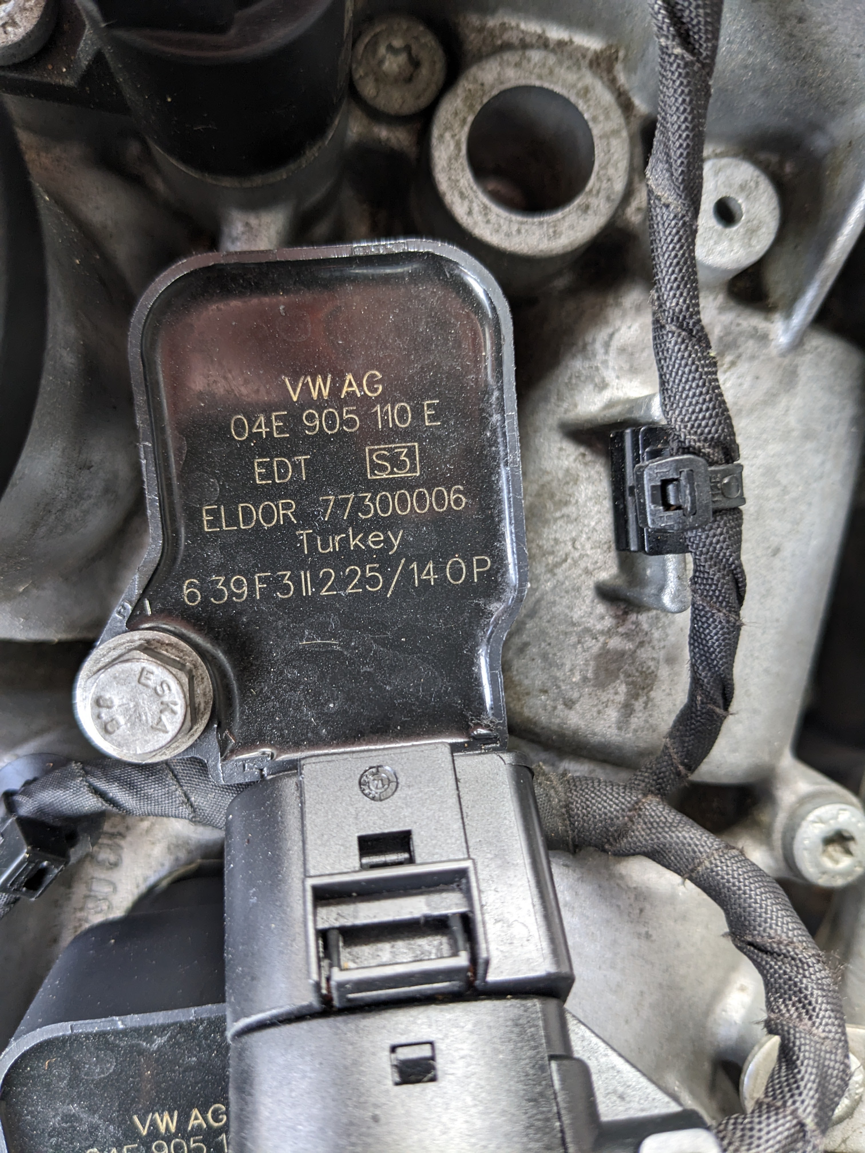

This is the coil igniter model I currently have:
Original ones because VW change for an other Part Number: 04E905110P

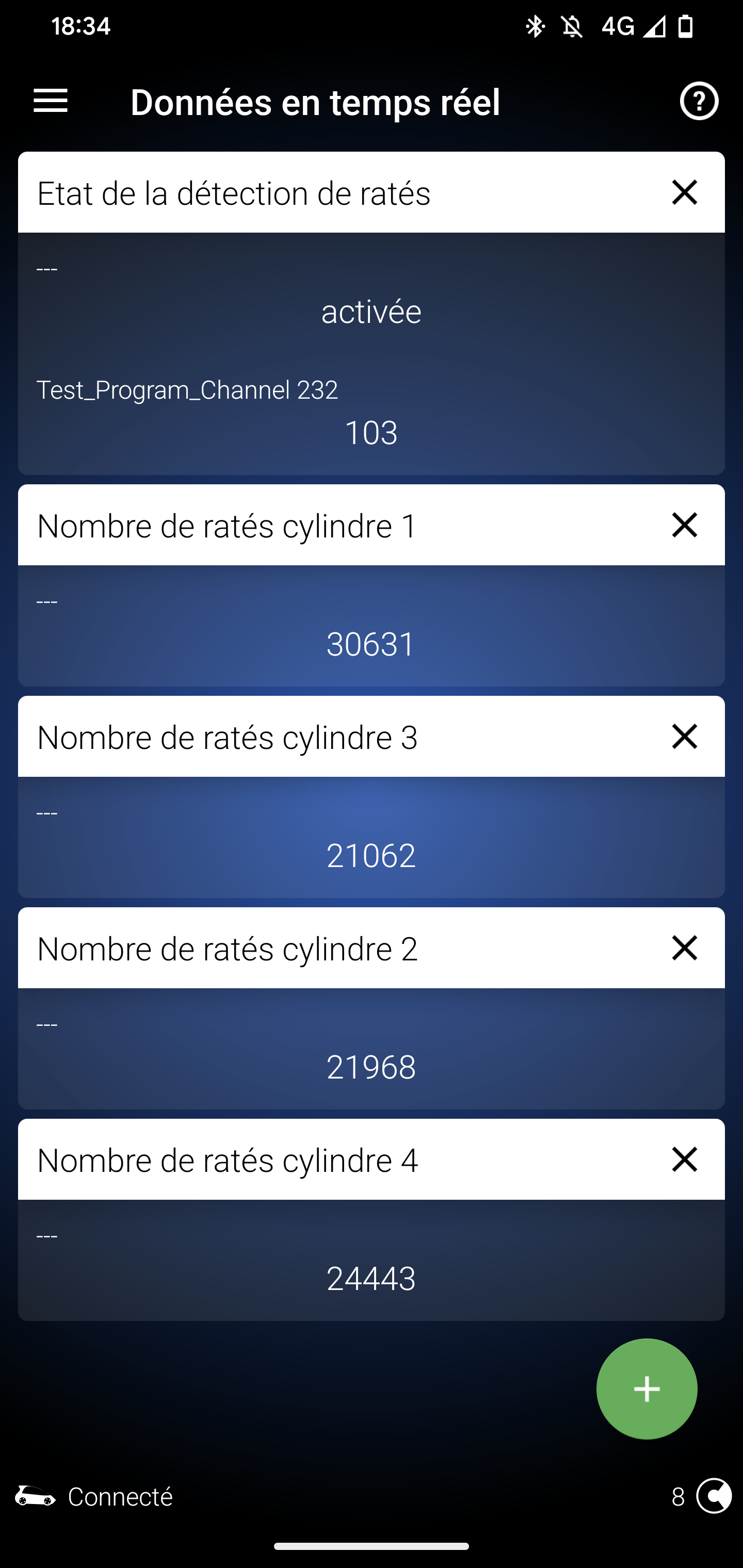

On OBDEleven you can see all cylinders missfire. It's like a counter.
Car is daily drived at 90% on highway. Only weekend few kilometers on city but over 400 on highway each week.
So I don't think engine is dirty.
The gap for the spark plug (brand new) is about 0.7mm.
However, injectors have been never cleaned (ultrasonic for exemple).
Missfire count on OBDElven since the begening of the life of the car:

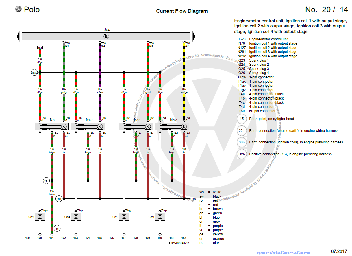

This is the Wiring Diagramm od my car:
So yes, I have to check the wire "15", at least, the state of the ground connector.
