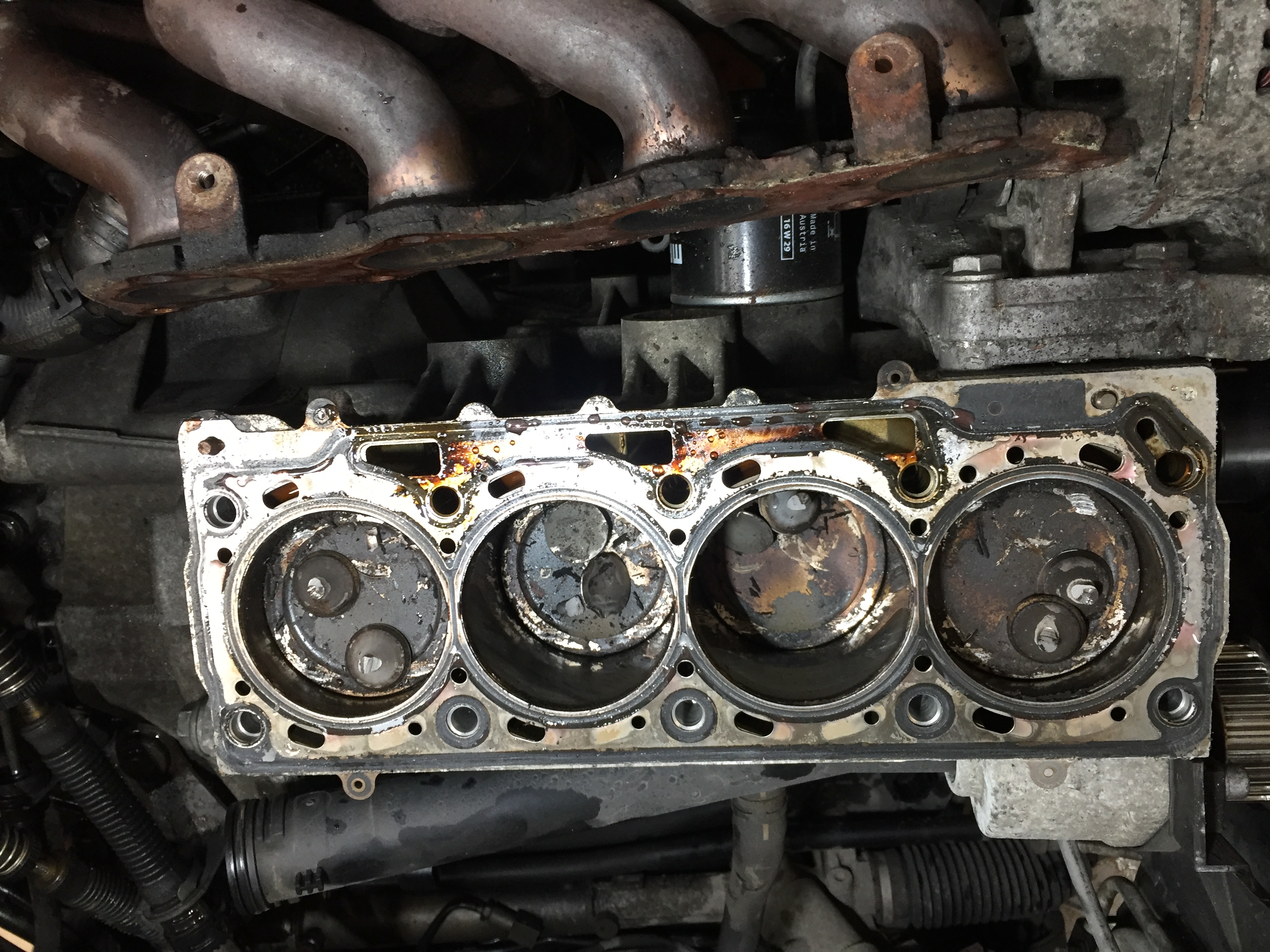

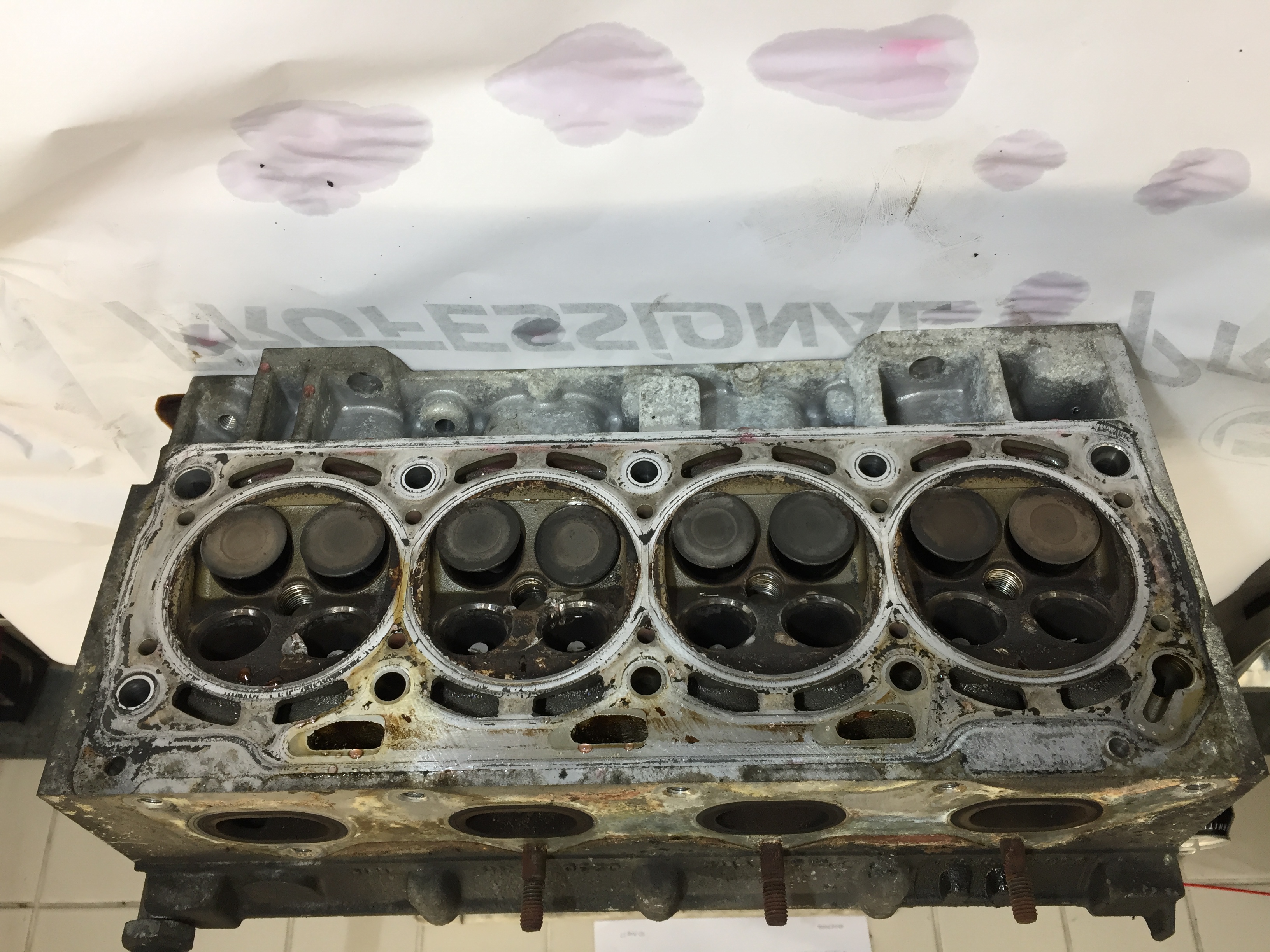

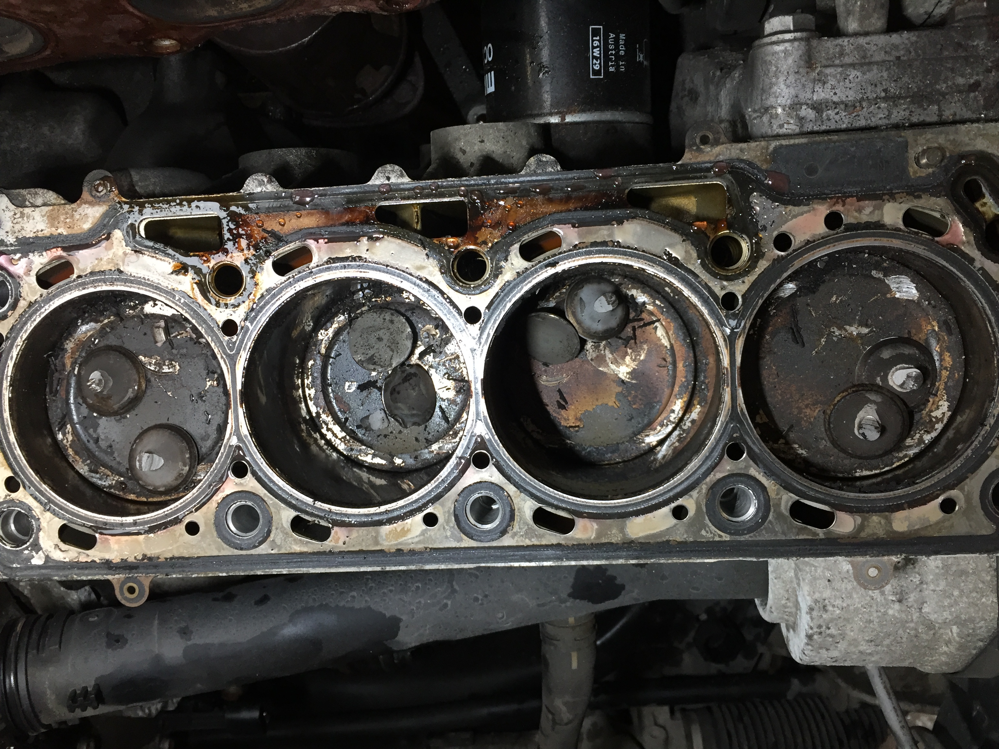

Same engine , totally destroyed this when the belt snapped

CarbonChaos wrote: Tue Apr 25, 2023 6:01 pm Same engine , totally destroyed this when the belt snapped
Wow... The valves actually broke.
Was the fixing of this costy? Did you have to replace the piston as well?

The head was damaged as you can see in the photos, so scrap. The bores also damaged from bits of valves smashing around in there,so scrap.
we fitted a reconditioned engine to this vehicle.
