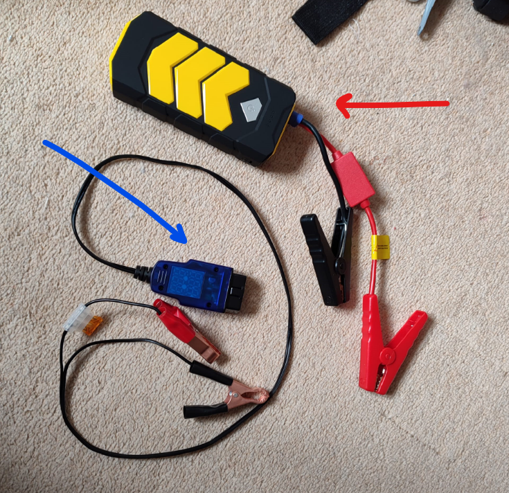

First of all - you NEED a memory saver and a power source for it: If you don't keep the car's memory powered you will lose all sorts of settings you have made for the car and the Radio security code etc. See photo of my kit below... An OBD plug for the OD socket (blue arrow) and something to power it - My 12v car starter battery (red arrow) was perfect and I knew it could keep the power going long enough to last the battery changing time.
memory saver.png (1.06 MiB) Viewed 4496 times

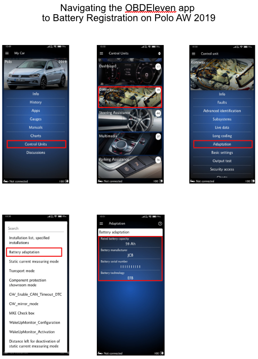

from other YT video... It seems there are a few different ways of battery adaptations out there for OBDEleven app. some require you to enter the three sets of data in one line separated by a single space and others are a lot simpler Just four fields to enter battery data. I didn't know without looking first and it put me off doing it myself at first; for two reasons.
The battery I bought does not have the OEM type code on it and I would not be able to input the single line adaptation code without that information. So.. check with the app FIRST just so you know what you are letting yourself into! If you check after it is fitted and you don't have OEM coding on the battery you won't know what to enter. and second .. It would be frustrating to get all the heavy work done only to stall at this point.
However IF (as in my case) you have the simple adaption method.. it won't matter either way.. all the information you need will be on the battery - AMP Hour (60 in my case) Manufacturer (I put YUA for Yuasa) Serial number. (it was already, for original battery) 10 x 1s in my case so i entered 1111111112 to register a different battery) then the type of battery (it was already EFB so I left it as it was)

remove the Memory saver (presuming your new battery is not flat!) LOL
Now put your battery details into the adaptations section of the app. Phew!

forgot OBDEleven app route to battery adaption .. on my version.
battery registration.png (252.86 KiB) Viewed 4494 times

Regarding the battery booster... I guessed there would be some capacitance in the ECU but i was already anxious about doing it and 'if' the battery didn't come off as quick as expected, didn't want to risk it; not knowing the full implications. I will say check the output of the booster... I found mine has timed out in the past after 20 seconds on the 12v utility socket unless there was a certain draw on it.. whereas the jump/crocodile leads were, on a similar low draw load, able to keep live for 20 minutes.

With regards to your capacitive jump starter, my lack of knowledge of what exactly it was offering was why I was questioning using one of them, but it seems that it offers a "12V support" output, so okay. Really just a better safe than sorry way of thinking for others to consider before using one of them.
One question on that capacitive jump starter, can or do you check it for its ability to boost a battery now and again, I'm asking that question because I'm sure that I've read maybe on another motoring forum of someone ending up being let down by his one, when trying to give another car user assistance! So, as his father also bought a similar but not the same brand one at the same time, he thought that he'd check that one out, it too failed, both maybe 4 years old. Root cause of failure was unknown. They do seem extremely handy and compact things to own though, I've just not bought one yet.

My booster: I have used it on my neighbour's car many times last winter when the battery on his diesel let him down. I had it for a year before actually needing it so did wonder what was going to happen when the neighbour knocked the door 8 am Sunday morning and asked if I had jump leads.. (I don't) It spun the engine so fast a few seconds after hooking it up!.. from the few times I used it without charging it back up I guess I could have used it up to 7/8 times esp as it started quickly rather than labouring. I did start my brother's 2.5 straight six, petrol, BMW.. that turned over well but took at least three seconds of turn over before coming to life. So perhaps just 4 times for that scenario before recharging it.
This pack has jumped in price, as has everything else, since I bought it.

My unit (Lithium ion) has an enclosed switch on the side and you can turn on the device after connecting up...
