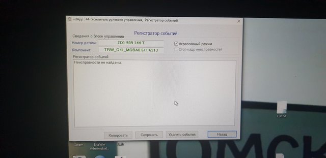

Works perfect! Retrofit 1S1909144R --> 2Q1909144T is sucсessful. The next stop is lane assist =)

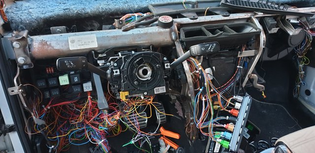

I am doing this conversion on my toledo at the moment, but I am facing a calibration issue.
I already had a TRW steering column with part number 6R1423510BE and with 6R1909144R electronics and I bought a 2Q1423510AH column with 2Q1909144M electronics from polo AW.
To install it I had to reuse my old rear column mount because the new one is slightly wider and it didn’t fit to the support bar of the dash, also the shaft that the steering coupler attaches to the column is a bit shorter, but it wasn't an issue.
Everything else was a direct swap without removing the dashboard.
I flashed it with PQ software from 2Q1909144M to 2Q1909144ZT_BOOT and then to 2Q1909144T using VCP, after that I used parameters from UP! GTI that VCP has available, but I have the following errors.
I don't know if something is wrong with the parameters or if I did something wrong in the procedure.

Address 44: Steering Assist (J792)       Labels:* None
   Part No SW: 2Q1 909 144 T    HW: 2Q1 909 144 F
   Component: TRW_G4L_MQBA0 611 6213
   Serial number: 1076627CB4K0662
   Coding: 000000000000000000000200010001000000010000
   ASAM Dataset: EV_SteerAssisZFGen1PQ12PA 002002
   ROD: EV_SteerAssisZFGen1PQ12PA.rod
   VCID: 43D34F116B1626C2529-8016
3 Faults Found:
10531840 - Steering angle sensor
          B1168 54 [137] - Missing Calibration / Basic Setting
                    Fault Status: 00000001
                    Fault Priority: 4
                    Fault Frequency: 1
                    Reset counter: 121
                    Mileage: 113114 km
                    Date: 2024.09.08
                    Time: 17:17:16
                    Engine RPM: 780 /min
                    Vehicle speed: 0 km/h
                    System status: Driving mode
                    Terminal 15 status: On
                    Voltage terminal 30: 14.13 V
                    Power steering current consumption: 0.5 A
                    max.value: 31.0 A
                    End stage temperature: 36 °C
                    Steering assistance: engine output: 100 %
                    Engine angle: 52 °
                    Electric motor speed: 0 /min
                    Steering assistance: target engine torque: 0.0 Nm
                    Steering torque: 0.0 Nm
10529280 - Data Set Missing
          U1118 00 [009] - -
          [DEM_NO_INITIAL_VW_DSDL_FAULT]
                    Fault Priority: 6
                    Fault Frequency: 1
                    Reset counter: 121
                    Mileage: 113114 km
                    Date: 2024.09.08
                    Time: 17:17:16
                    max.value: 31.0 A
                    Engine angle: 52 °
10512640 - Steering End Stops Not Learned
          C10AC F0 [137] - Unknown Error Elaboration
          [DEM_BOTH_ENDSTOP_NOT_KNOWN]
                    Fault Priority: 4
                    Fault Frequency: 1
                    Reset counter: 121
                    Mileage: 113114 km
                    Date: 2024.09.08
                    Time: 17:17:16
                    max.value: 31.0 A
                    Engine angle: 52 °

I fixed it using only VCP ! :P
parameters from vcp were ok but I was doing it wrong, unfortunately vcp support is close to non-existent and the correct way to do it is not documented in their manual.
I am sharing what worked for me for anyone interested .
after flashing with 2Q1909144T,
Download parameters from library and unzip the file, you will have 2 files for GTI and 2 for Standard UP! Choose what suits you but do not mix them.
from now on you have to do everything in VW EOL mode using 28183 login code.
go to flasher and select dsdl2 option and flash system parameters
after off/on ignition repeat the procedure with steering maps
After off/on ignition again go in adaptations and change
Plausibility check to Disabled
Characteristic curve of steering assistance to Dynamic
Driving profile switchover to Direct: controlled over threshold value
Code using VW UP! coding and adjust accordingly : 000000000100000000000200010001000000010001
Then go to basic settings, steering angle sensor with the steering wheel as centered as possible and click Start, wait for a few seconds click Stop and then Done.
Close session, turn on engine and turn steering wheel lock to lock from left to right pausing for a few seconds on ends and then bring the steering wheel to center.
All errors should be gone by now !
set plausibility check to active in adaptaion then
Open measuring values and using the steering angle-angle option check that wheel is on 0 degrees. Close session and do not touch steering wheel.
Go to 03-ABS , and in basic settings select steering angle, Start, wait until it finishes, Stop, Done.
Clear errors on other modules and enjoy !
