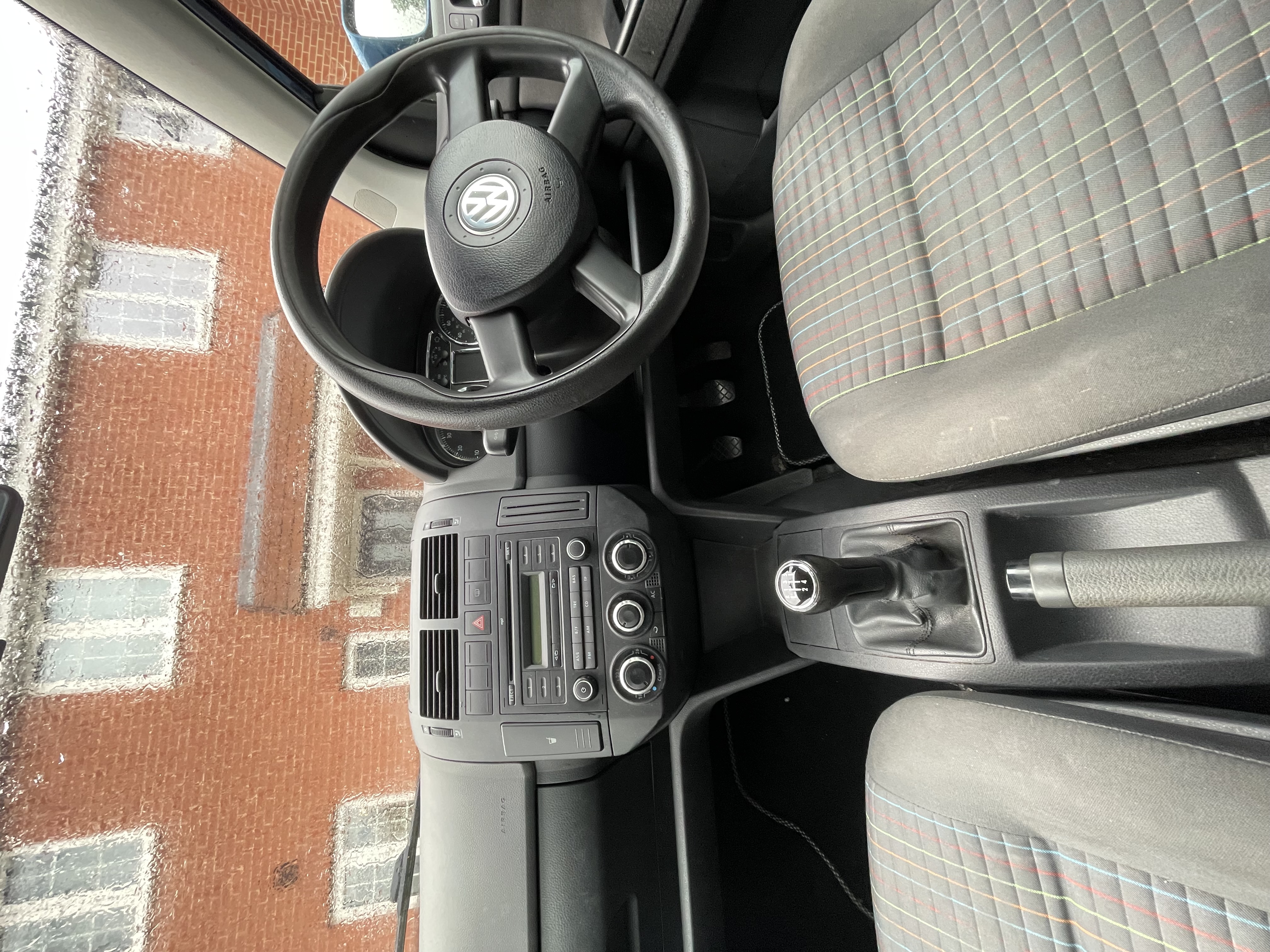

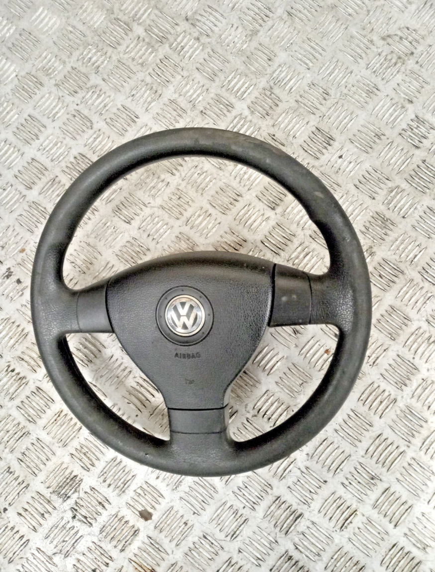

I would like to change my steering wheel that looks like this

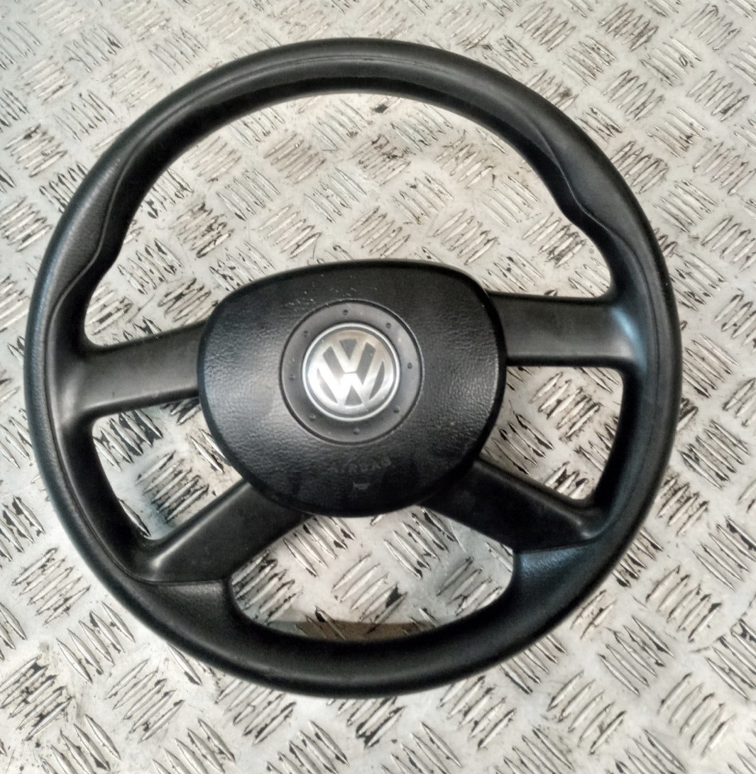

for one that looks like this
how possible would this be?
for reference my polo is a 2007 1.4 16V petrol with engine code BUD and the steering wheel I want is from a 2006 1.2 with engine code BMD

Both 9N3 wheels, should fit.
Just needs a reset of adres 15 probably after fitting.

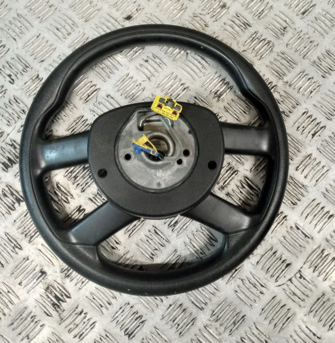

so I’m assuming the one locking mechanism on the older wheel will work fine without using the other
but what about the extra cable on the older wheel, is leaving it loose not going to give me any problems?
and what is a reset of adres 15, I’m not too caught up with electronics in cars
Re: Changing steering wheels
the connector is the same
you might get an error light for the airbag, the airbag module is known as module 15, that's the digital address of the airbag module

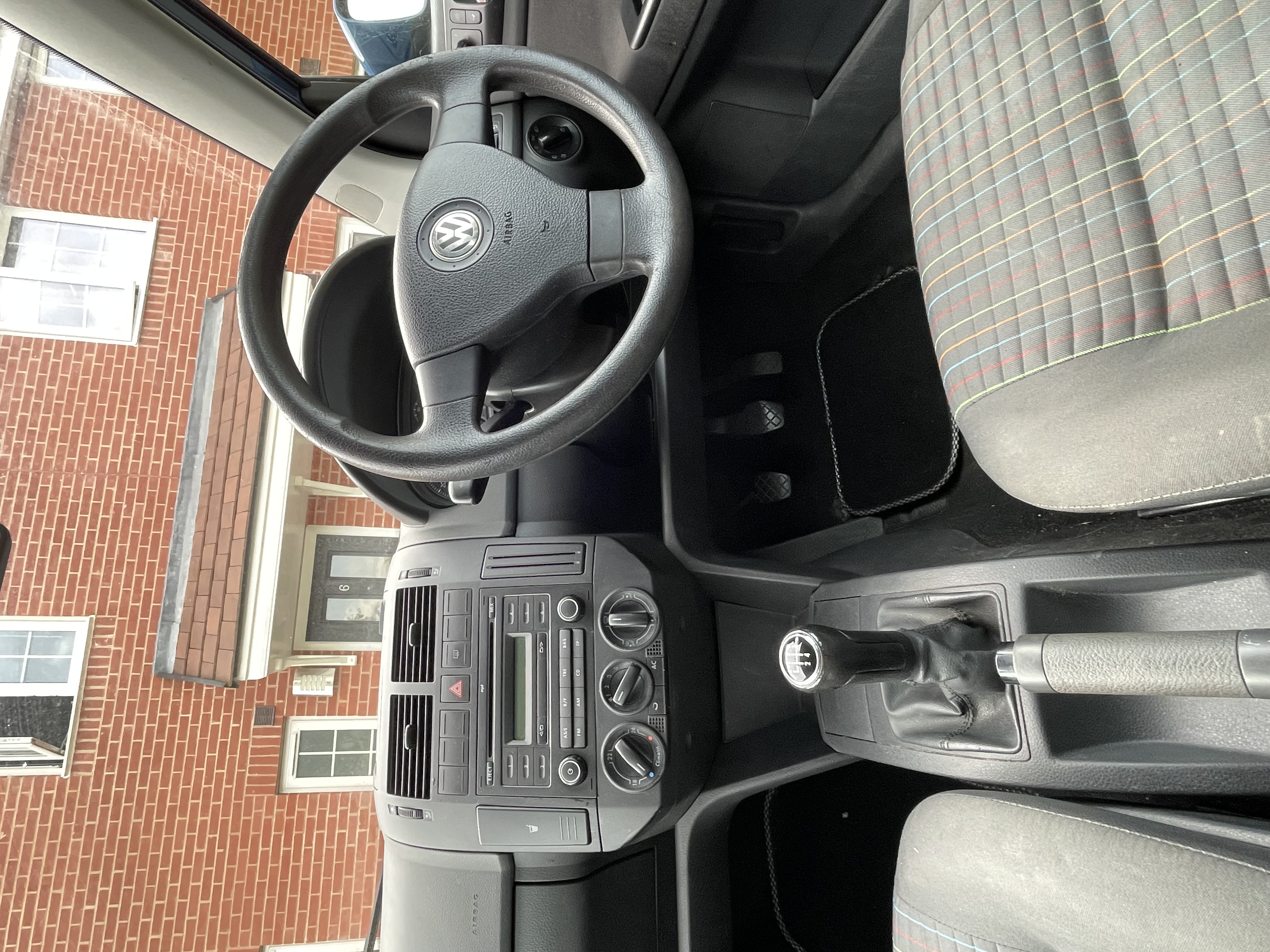

Incase anyone is interested the steering wheel change is super easy and makes the inside look so much better, as long as you disconnect the battery you should have no problems
here’s the before and after
