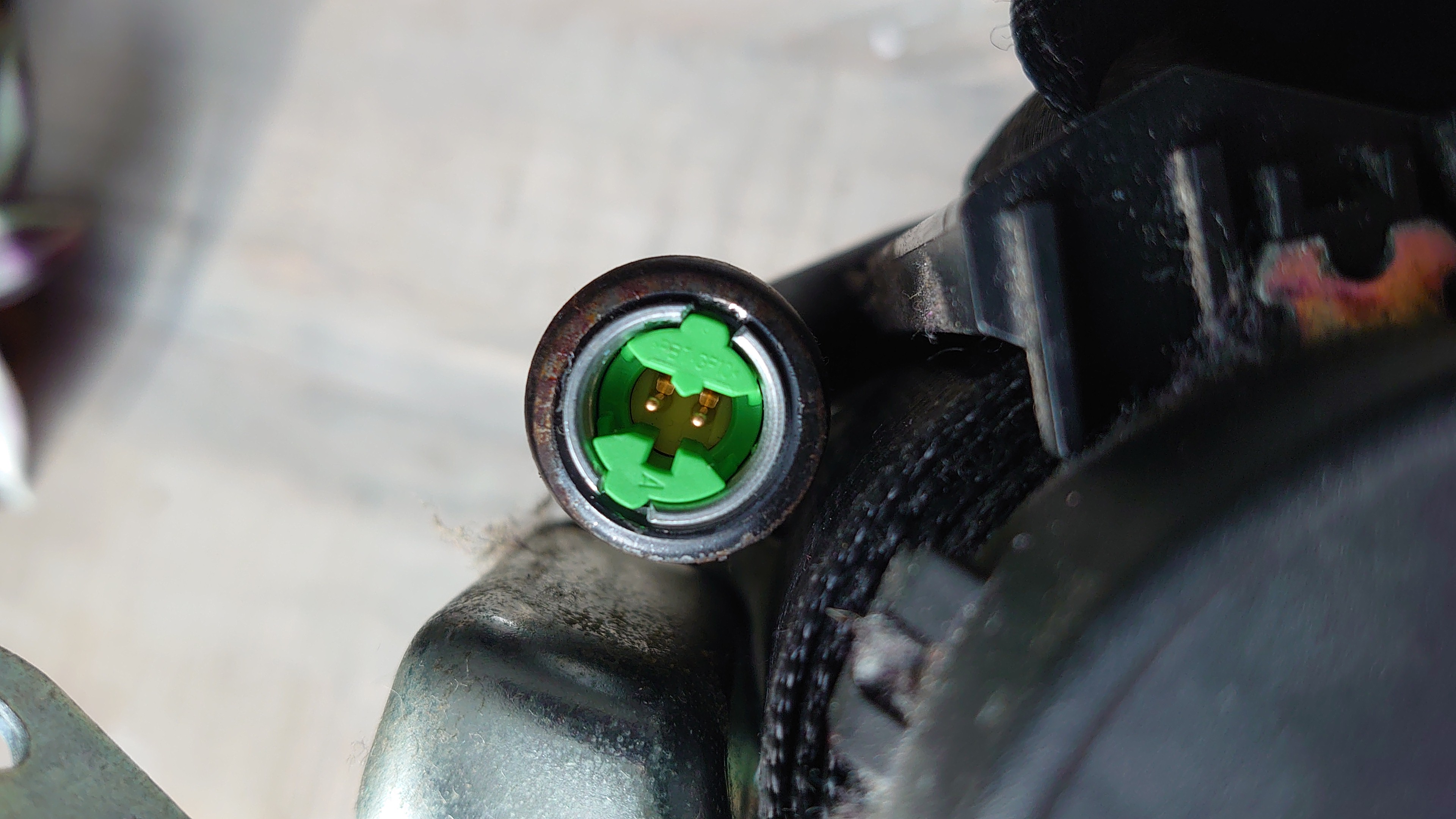

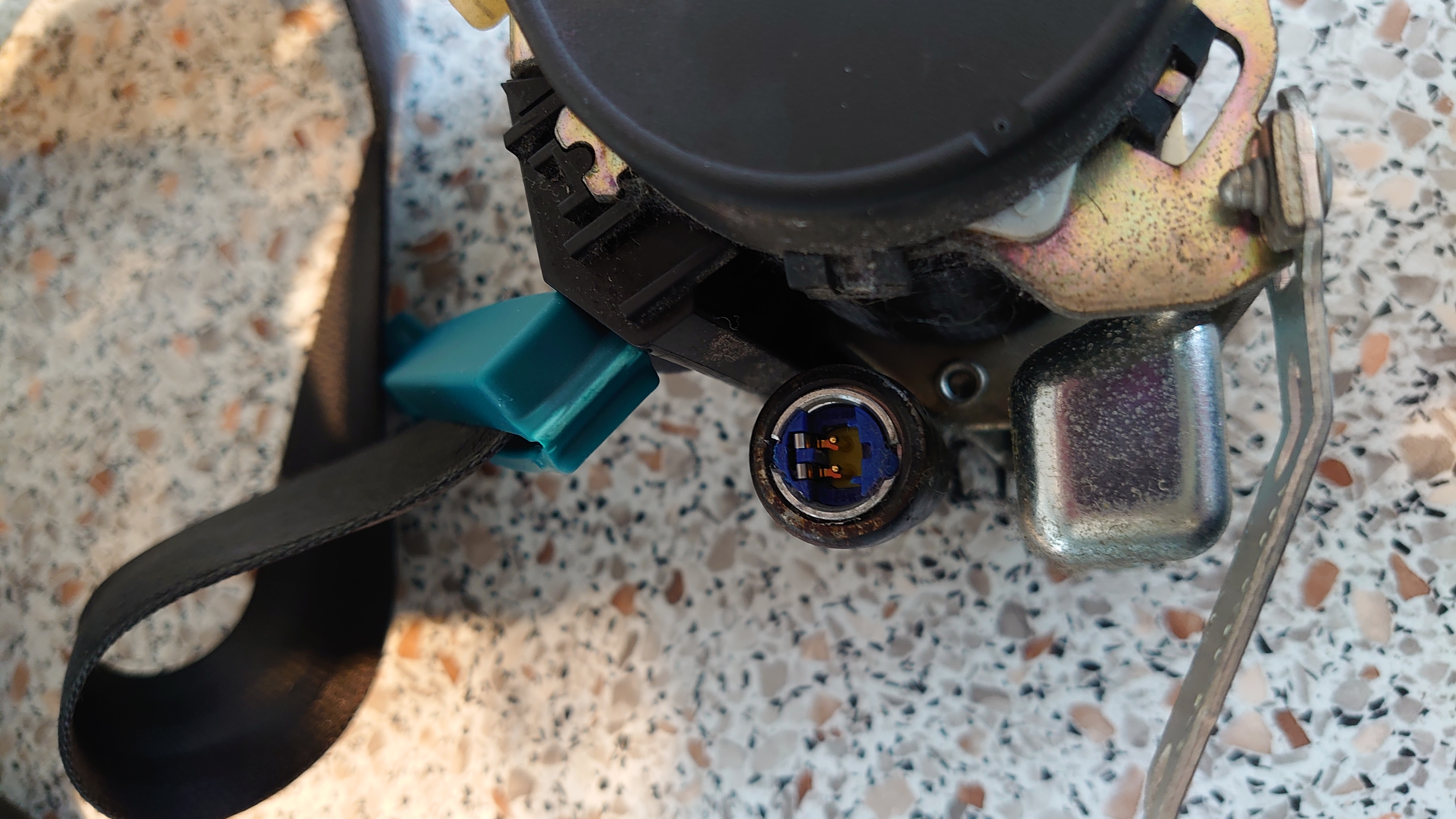

But pay attention, I replaced a seatbelt for my wife her car.
Ordered one of a Polo that was 2 months older, connector insert didn't fit.
I solved this by removing the insert en replacing it with the insert of the connector from her car.
After that I could fit the seatbelt to the existing wiring.
Good luck

Only last letter varied.
One I bought was J, I can't remember the other
But when changing the inserts it still could be fitted.
No clue why vw would change that in 2007

There are only 2 pins.
Blue insert and I believe the other one was green of red insert
