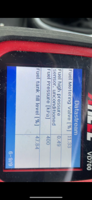

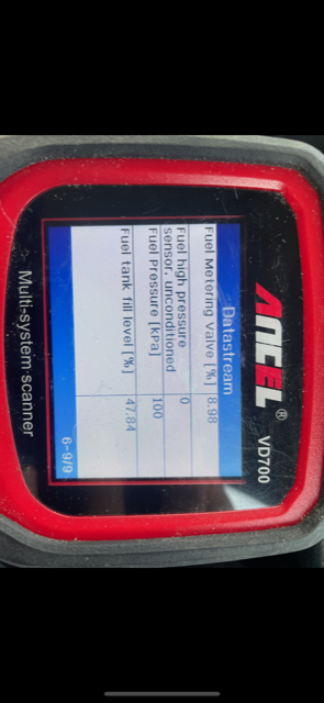

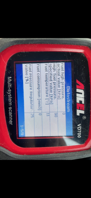

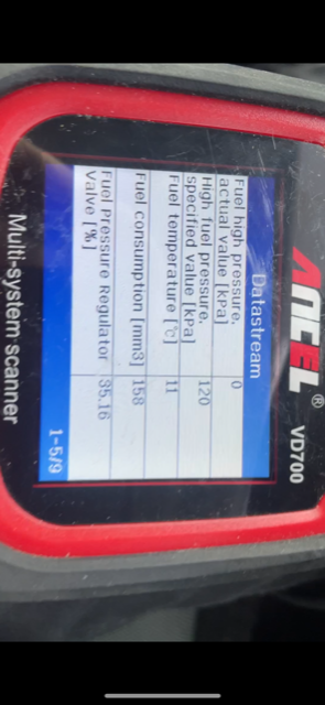

Plugged my diagnostics tool in and all seemed normal except for the high pressure fuel actual value which sat nicely at 0.
Attached are some pictures of live data of the fuel system with no cranking and then during cranking.

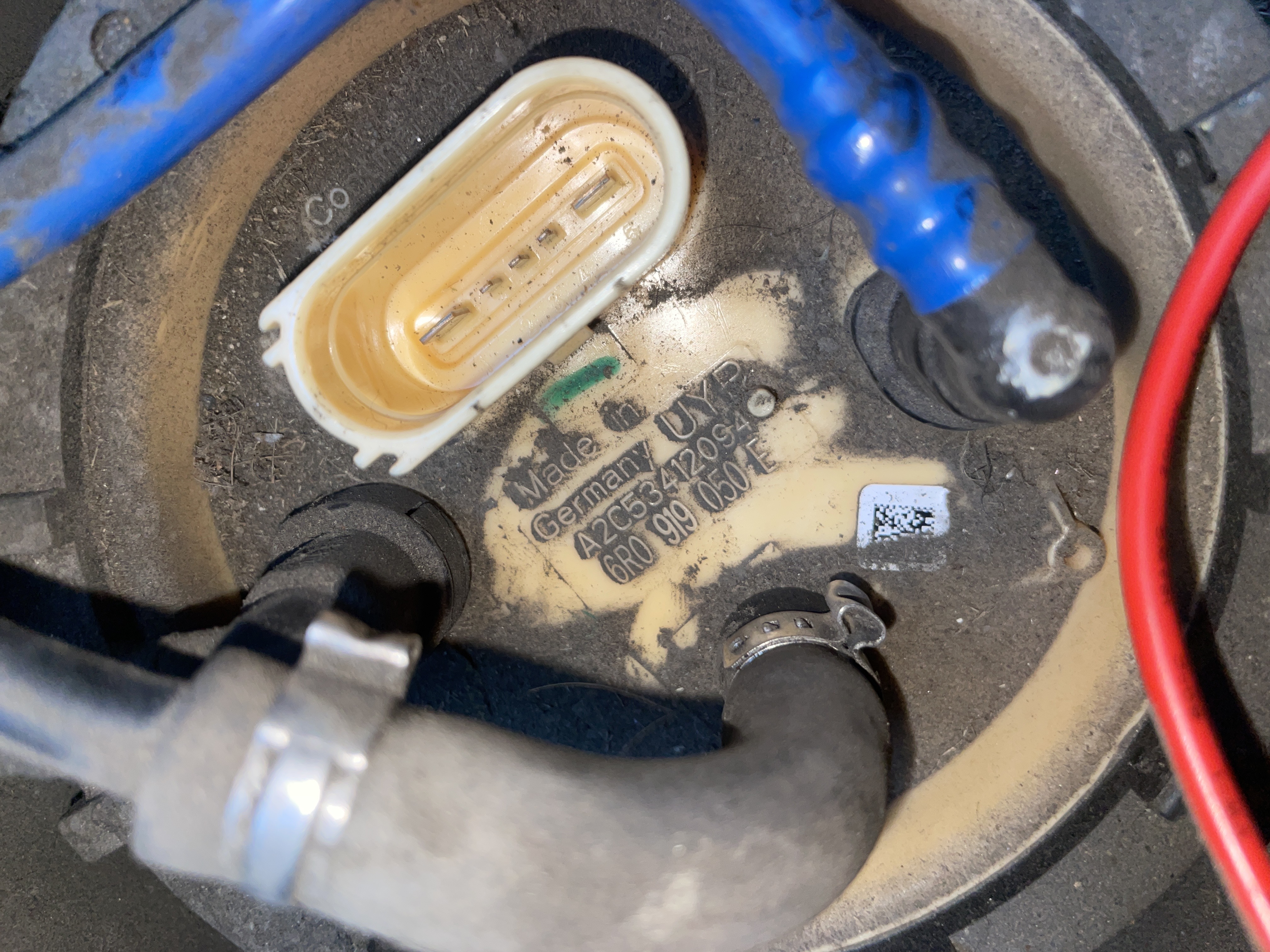

Fuses are all good, testing the fuel pump im getting no continuity/resistance across the two large pins on my fuel pump but i am getting resistance across the smaller ones, does anyone know what the designation for the pins are on the pump?
Cheers
Posts: 6089
Re: Crank but no start
It's very easy to to guess, I shouldn't I know, but, as you have considered, there will be a large +ve and a large -ve supply and return for the pump motor, and the typical fuel level device will be a resistor with a moveable (wiper) contact, so could explain the 3 smaller contacts.
So, I'd expect a low resistance across the 2 large contacts - like you seem to expect.
