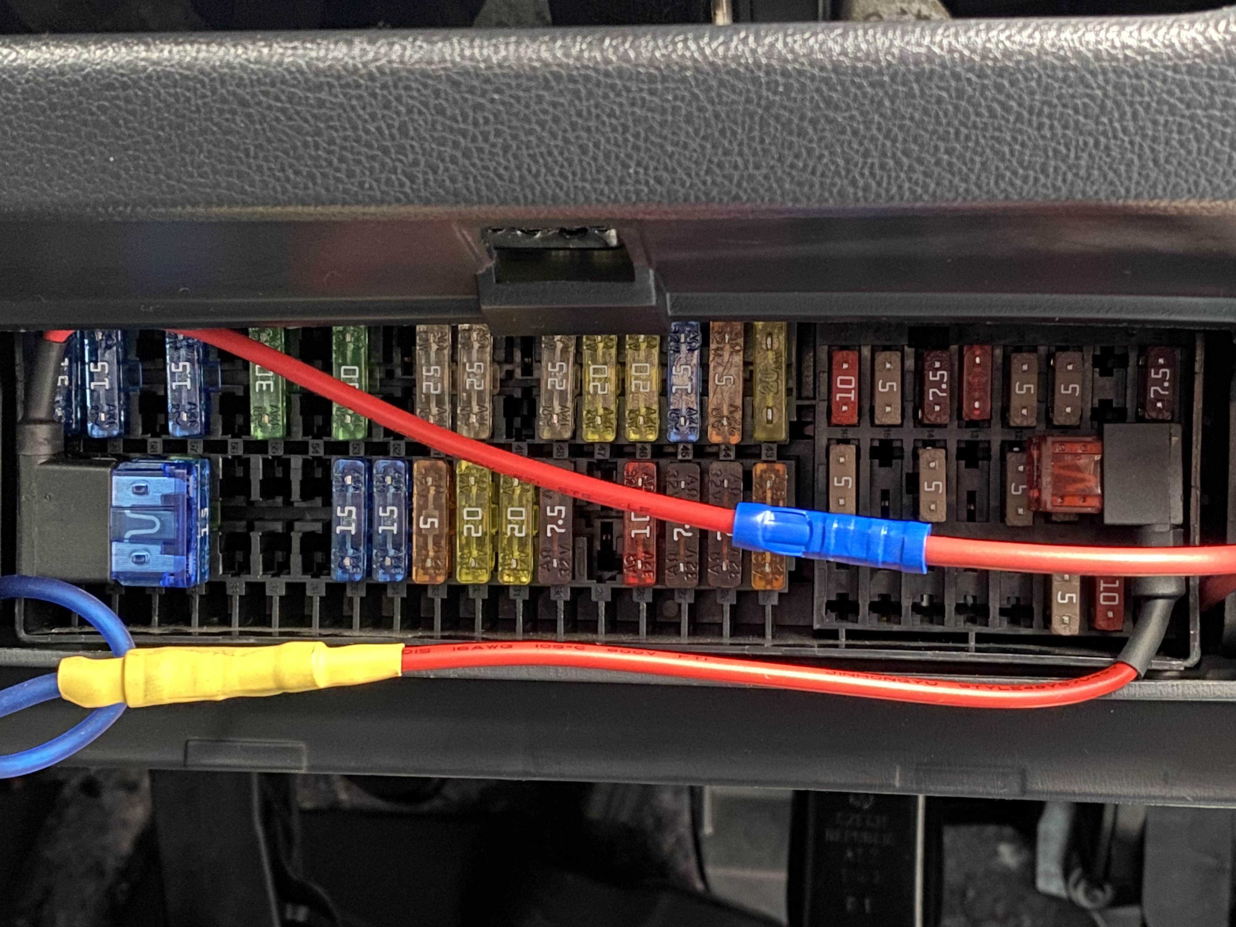

The power for the amp goes direct from the battery. I don't think the blower control unit is the problem as it has been tested and everything worked as it should do, when power direct from the battery to the blowers was made. There is something that is stopping the power from reaching the blower motor/control unit. I do however have a spare blower control as I bought a used mint one for a good price. I haven't been able to test the other things yet as it has been raining on and off for most of the weekend! I do have a photo of the fuses though:
- Posts: 8992
Re: Blowers not working
That overhead fuse is one of the worst ways to take power, in addition to being unstable because it can come out of the SB40 slot at the first bump in the road or by inadvertent manipulation of those exterior wires... plus it is overloading an important supply circuit (75). What powers that overhead fuse?
Did an electrician do that? really? Is the electrician who did such an installation the same one who told you that the problem with the climatronic is in the BCM?
Do a test, remove that overhead fuse, put in the original fuse (30A) and check if climatronic works.

The overhead fuses were either done by the company that fitted the front & rear dash cams, or/and the first guys that fitted the new head-unit and amp (that placed too much load on one power feed that caused the headunit to stop working). The place that said they thought it could be the BCM is a local VW specialist near the proper car audio place who got the headunit working again. If it's not the BCM, it most be something that has happened to the wiring between the fuse and the blower motor or blower motor control unit. I'm not sure what power feed the guys that first fitted the headunit have tapped into.ciclo wrote: Mon Oct 30, 2023 4:52 am That overhead fuse is one of the worst ways to take power, in addition to being unstable because it can come out of the SB40 slot at the first bump in the road or by inadvertent manipulation of those exterior wires... plus it is overloading an important supply circuit (75). What powers that overhead fuse?
I'm pretty sure I already put a replacement same amp fuse into No.4 and tested it, but will try again when I get chance when it will ever stop raining!

Any 'specialist' or 'Superman' who doesn't know how to diagnose and fix these little problems on your 6R has no credentials.
Perhaps they could have used these free spaces/slots for new installations with original/appropriate fuses. ...and not compromise other electrical installations.
Removing the fuse box is a piece of cake. Working little and earning a lot of money without deserving it has become very common nowadays.
Most likely, your BlueGT does not have the SB18 fuse from the factory, don't buy it yet until we see the requested images.

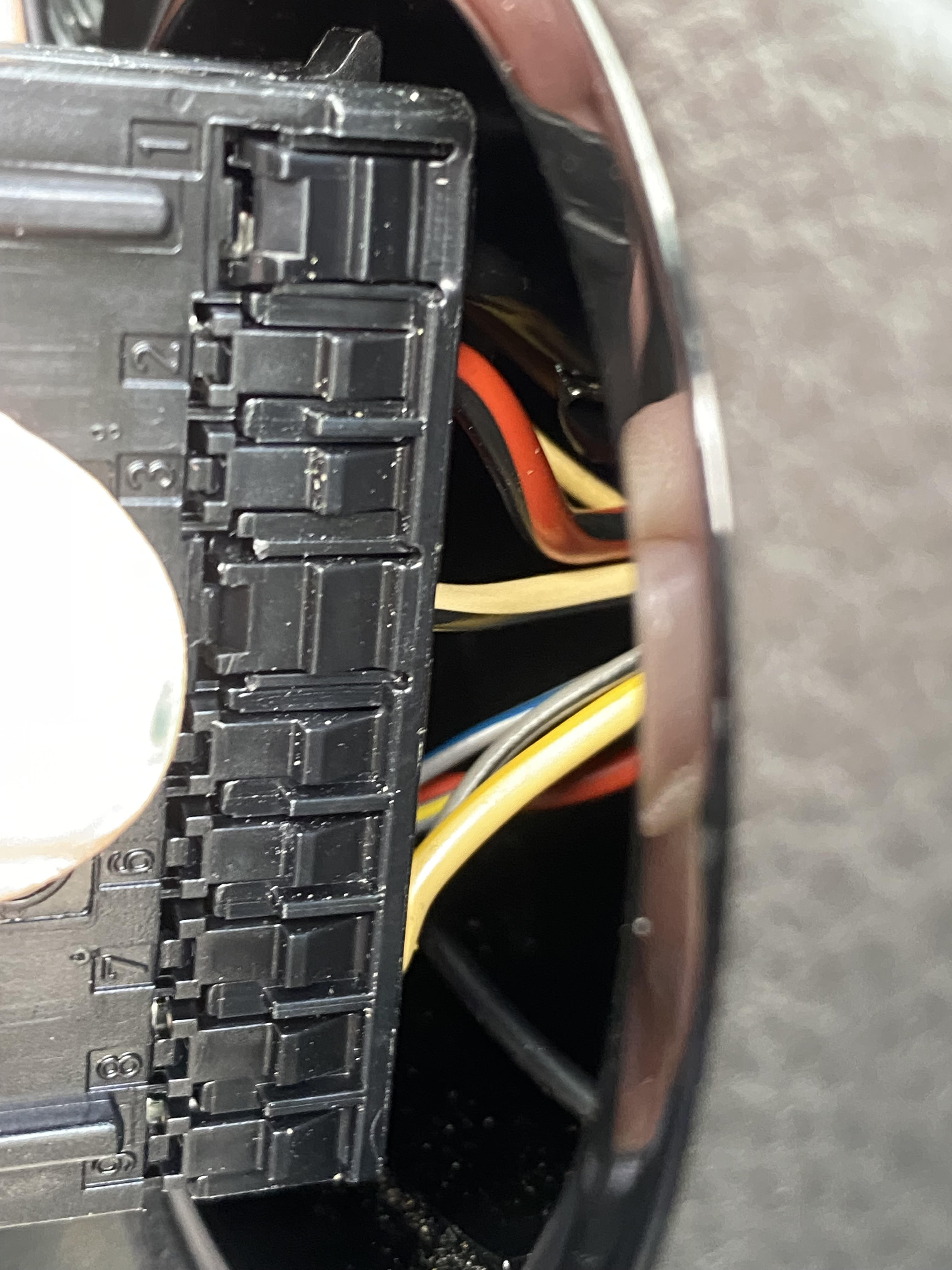

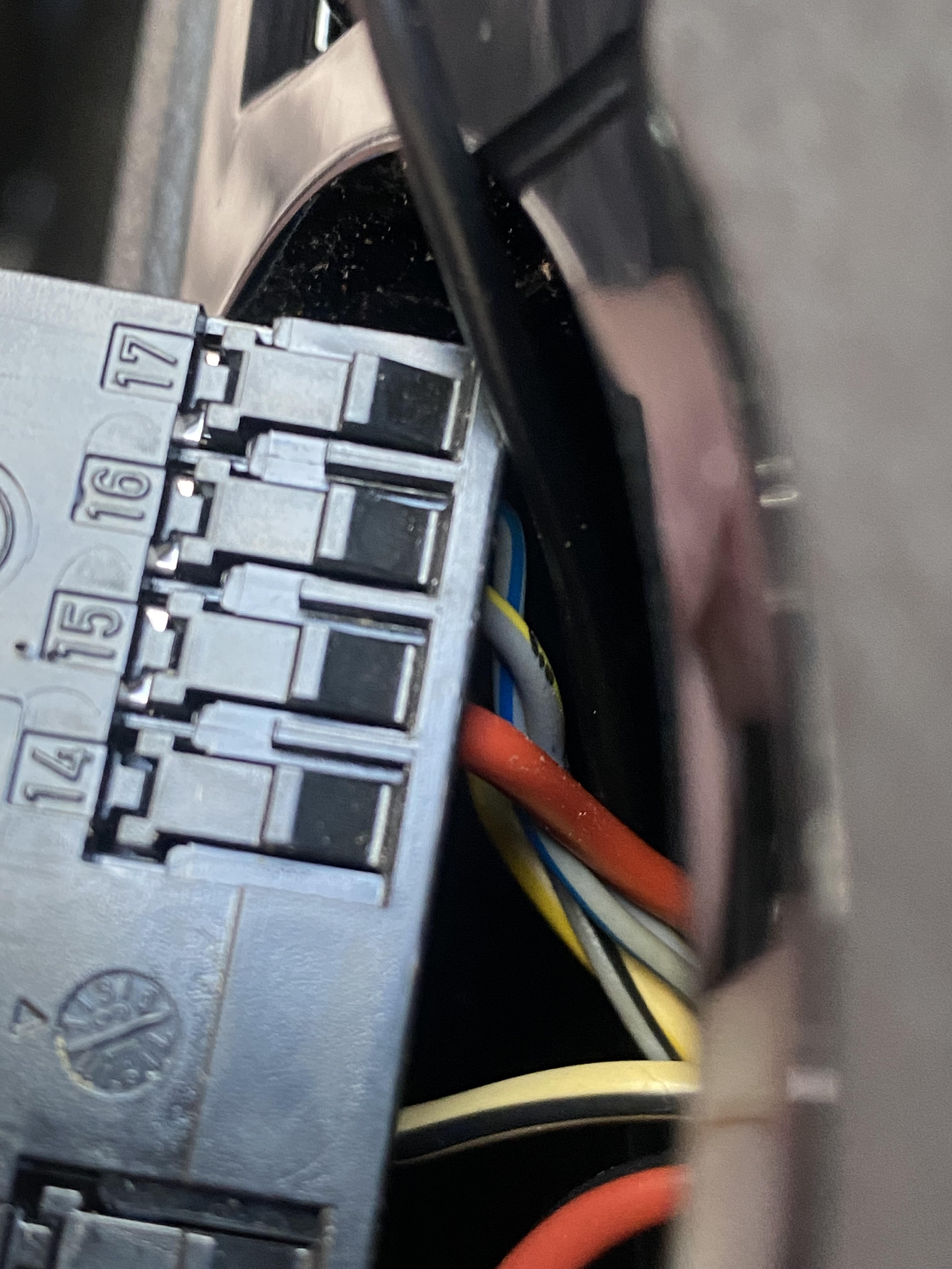

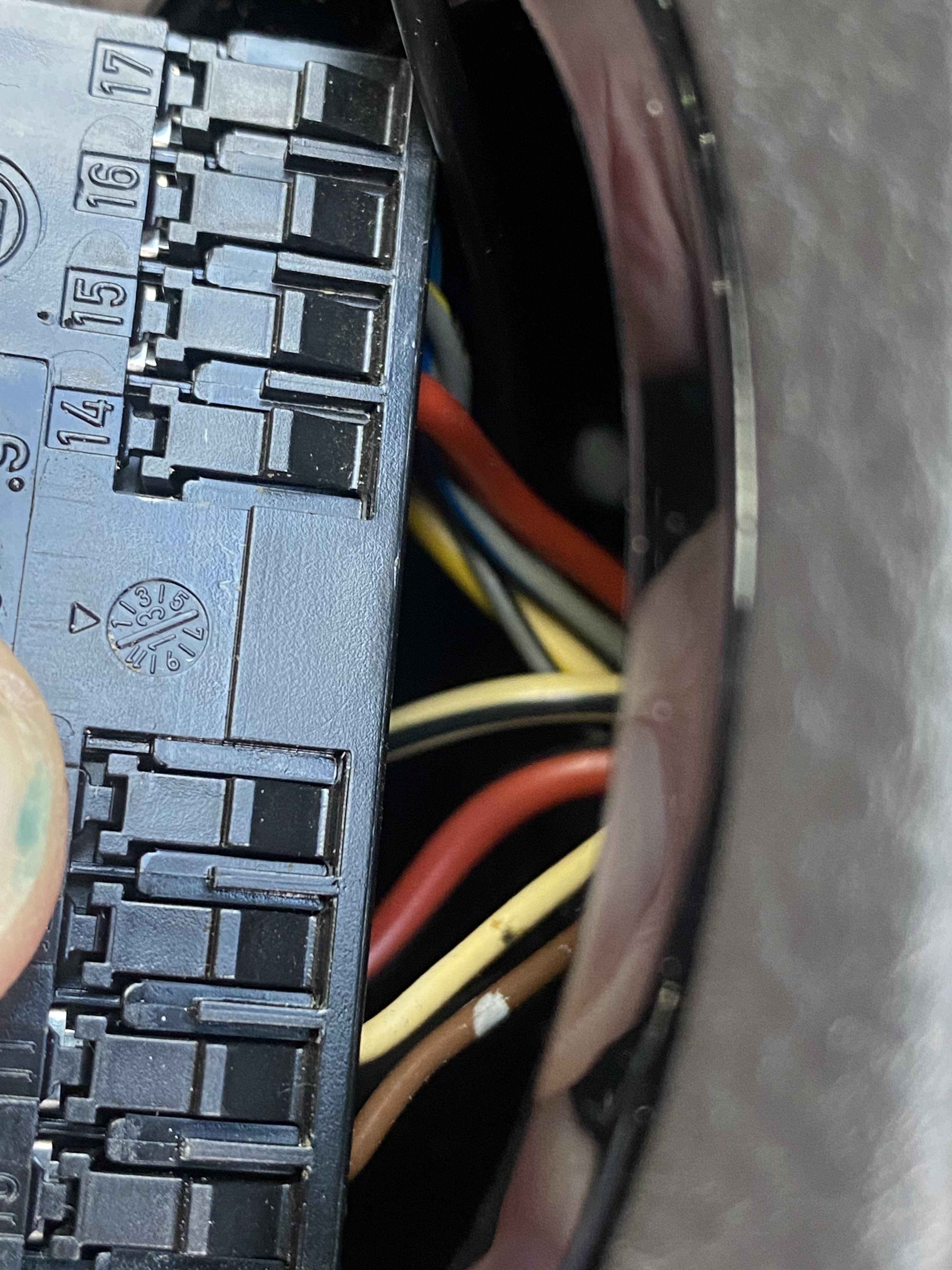

I got some photos of the light switch, but they are not so clear of the wires, as it was impossible to pull the plug out any further to get any clearer shots. I think there were wires in numbers 1,2,4,8,10,12,15,16,17
- wire3.jpeg (1.03 MiB) Viewed 4180 times
- wire2.jpeg (876.58 KiB) Viewed 4180 times
- wire1.jpeg (843.4 KiB) Viewed 4180 times

It is enough
, it is appreciated that the T17/9 wire is not 1.0mm2 thick, but 0.5mm2 thick, so the original diagrams are not correct for your 6R RHD.
That is, the rear fog light in your 6R BlueGT RHD is under control/managed by the BCM.
So, with the multimeter and with the rear fog light activated you must check if power/current reaches the ORIGINAL connector (right side) in position T6/6, ... if yes, the problem could be either in the adaptation wiring that your friend made later or on those aftermarket LED taillights for 6R LHD. Use the multimeter to find out how far the power/current goes.
