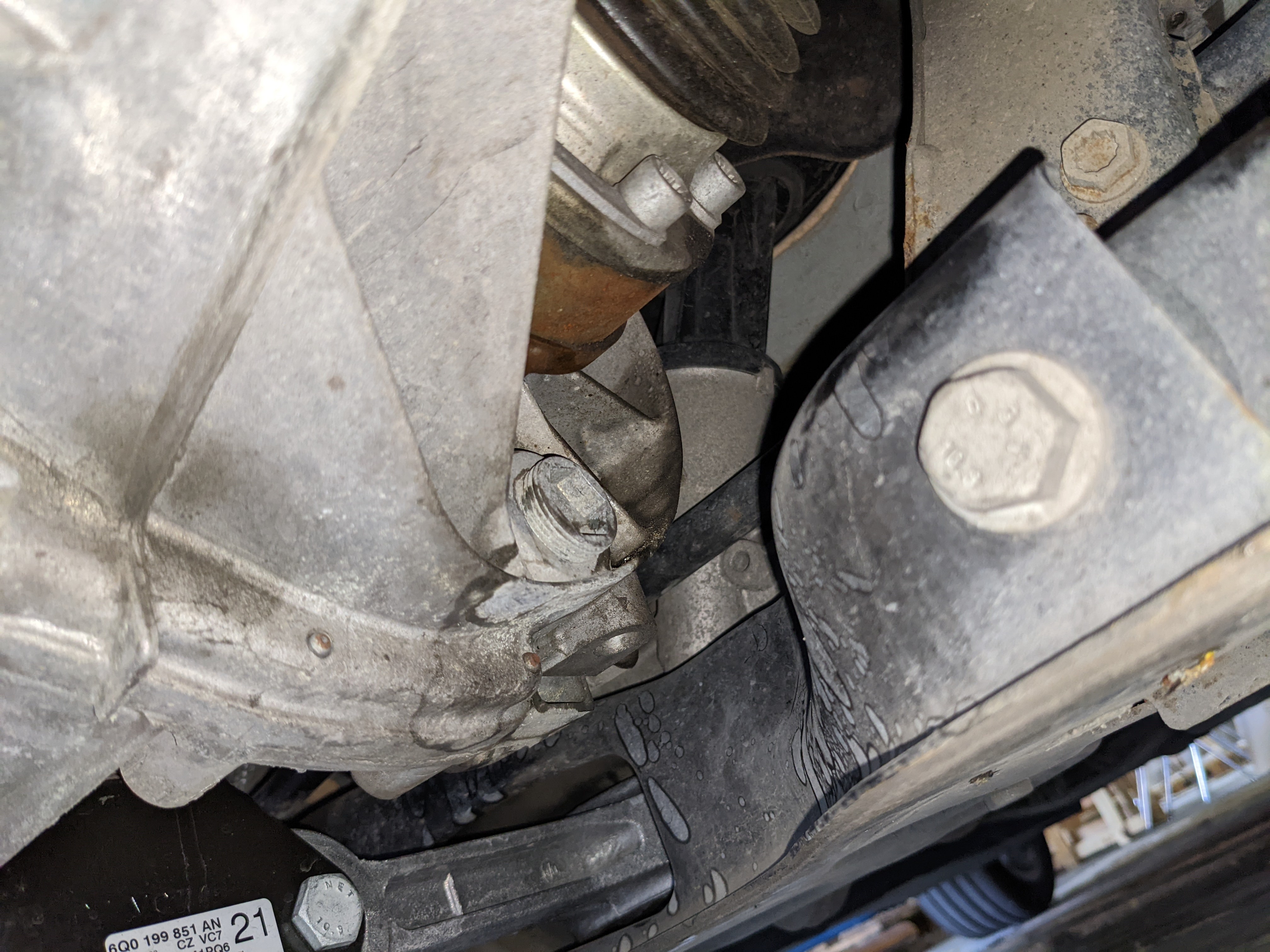

I replaced is two years ago but before replacing the gearbox mount. So, because of that I think it's again in bad condition because of the stress due to the (now replaced) old gearbox mount.
The part number is 6Q0199851AN and it's no longer available.
According to some website there is a 6Q0199851BB, shape is the same but no more information.

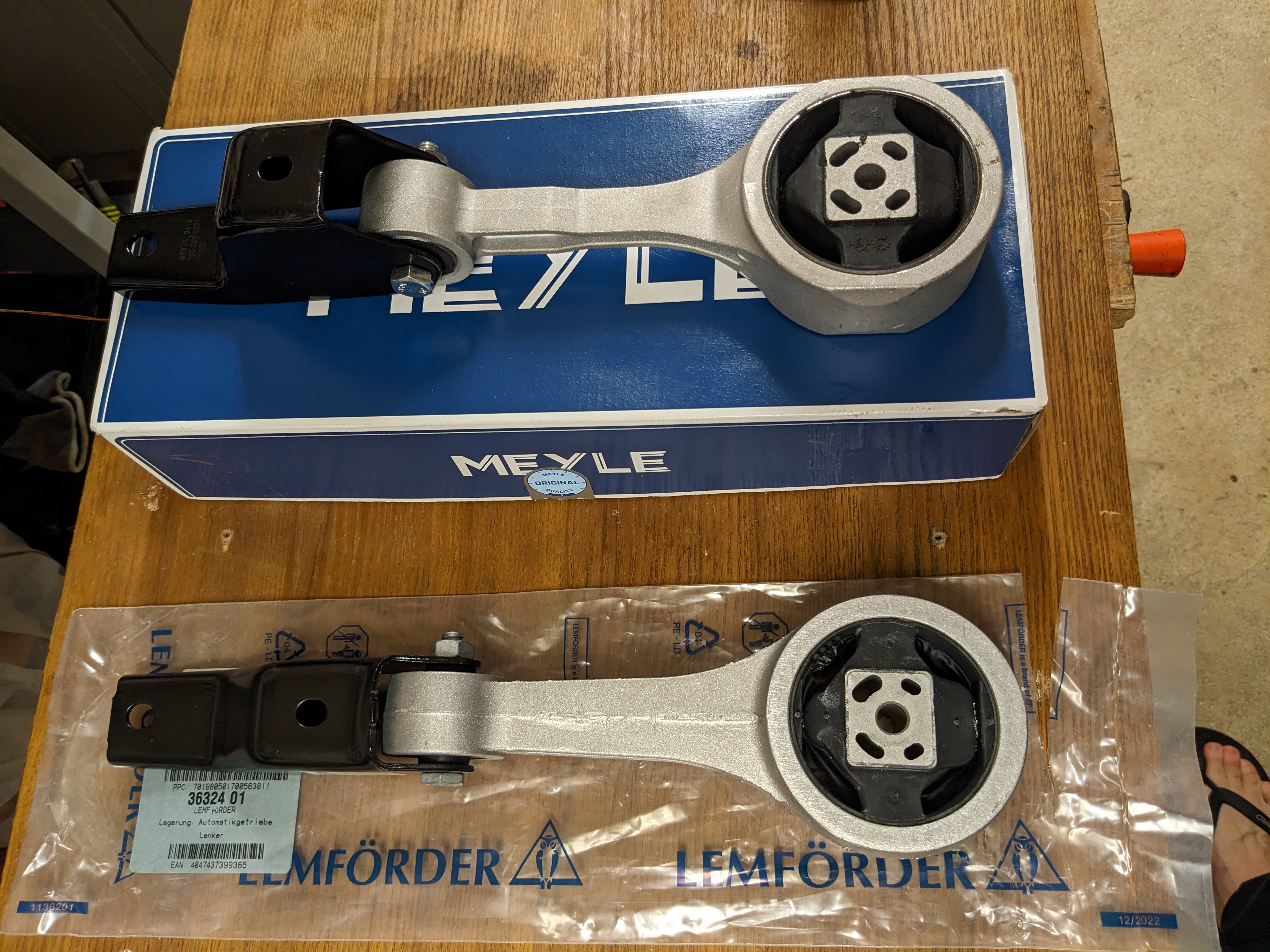

So, some updates:
I ordered two new holders of different brands for my car.
The basic part number is no longer supplied by VW (6Q0199851AN), manufactured by Lemforder and currtently on my car.
It would have been replaced by 6Q0199851BB, which is fitted to 1.6 TSI abroad. But there's no official confirmation.
This is the Meyle, I didn't take the official 140-euro version....
Engine jerking recurring problem on the Polo 5. The silent bloc for petrols are too weak and VW has ended up using those designed for diesels (I've already changed the gearbox support silencer).
The reference for diesels dogbone mount(1.6 TDI) is 6Q0199851AP.
Many owners have made this kind of modification, just change the black bracket.
It's Lemforder, the official supplier, they just filed off the VW logo.
The problem is: the diesel version (lemforder) is softer than the petrol version (meyle).
So it's hard for me to understand.
Softer=more jerks?
Less soft=less jerks?
