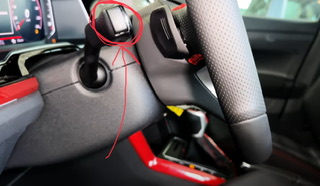

Posts: 3848
Re: Polo GTI won't retain settings!
From what I’ve seen on other forums, switching off Lane Assist is a simple two step process that takes literally a few seconds (I can’t try it in my 2020 GTI+ as my car doesn’t have Lane Assist). This process works on the mk8 Golf so I’m assuming it also works for the facelift Polo GTI.
  • press the button on the end of the indicator stalk.
  • the ‘Assist Systems’ menu appears in the middle of the digital dash. I think Lane Assist is the top item in the menu list and is pre-selected. Press ‘OK’ in the centre of the haptic touchpad on the right hand side of the steering wheel to ‘untick’ Lane Assist.
  • Done!
Needs to be done on every ignition cycle, but it’s no real hardship to do as the simple two step process is quick and easy, and IMHO would soon become second nature to do as part of the engine starting process (like switching off stop start is second nature for me 🙂).

Hey SRGTD, thanks for the visual representation, i'll give it a look this evening, i pray its there!

Ok, so you were right.
You have to press that button, then press the ok button on the steering wheel.
like you said will take some getting used to but should be come second nature.

SRGTD wrote: Tue Nov 21, 2023 4:16 pm From what I’ve seen on other forums, switching off Lane Assist is a simple two step process that takes literally a few seconds (I can’t try it in my 2020 GTI+ as my car doesn’t have Lane Assist). This process works on the mk8 Golf so I’m assuming it also works for the facelift Polo GTI.
  • Done!
That’s exactly how it’s done. I don’t even realise I do it now when I get in the car, it’s become automatic to just turn it off and takes two seconds, if that.
