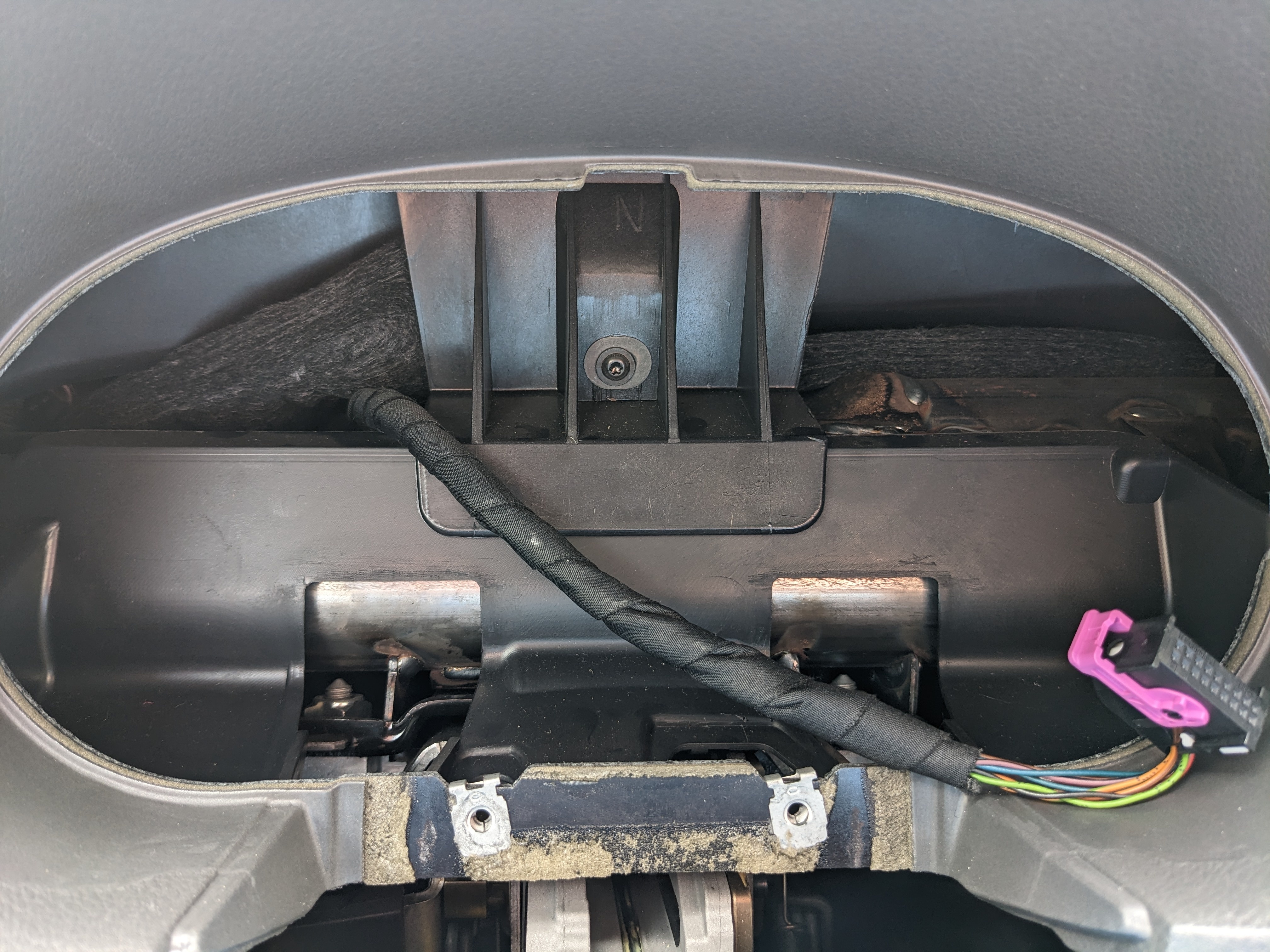

I have a solution for the cluster noise. I will share you some pictures later.
I had this issue. It make me crazy during winter. Rattle on poor road surface.

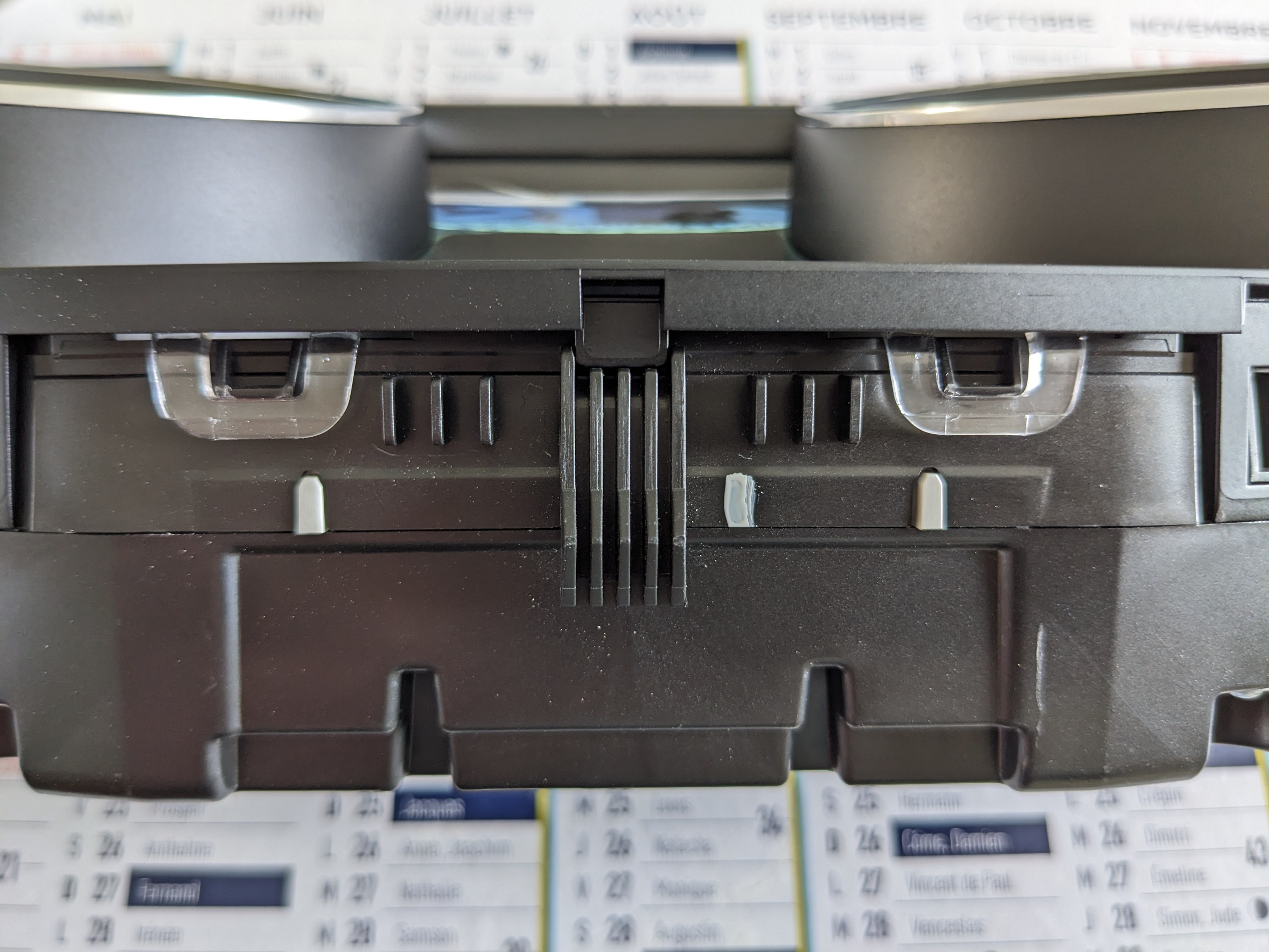

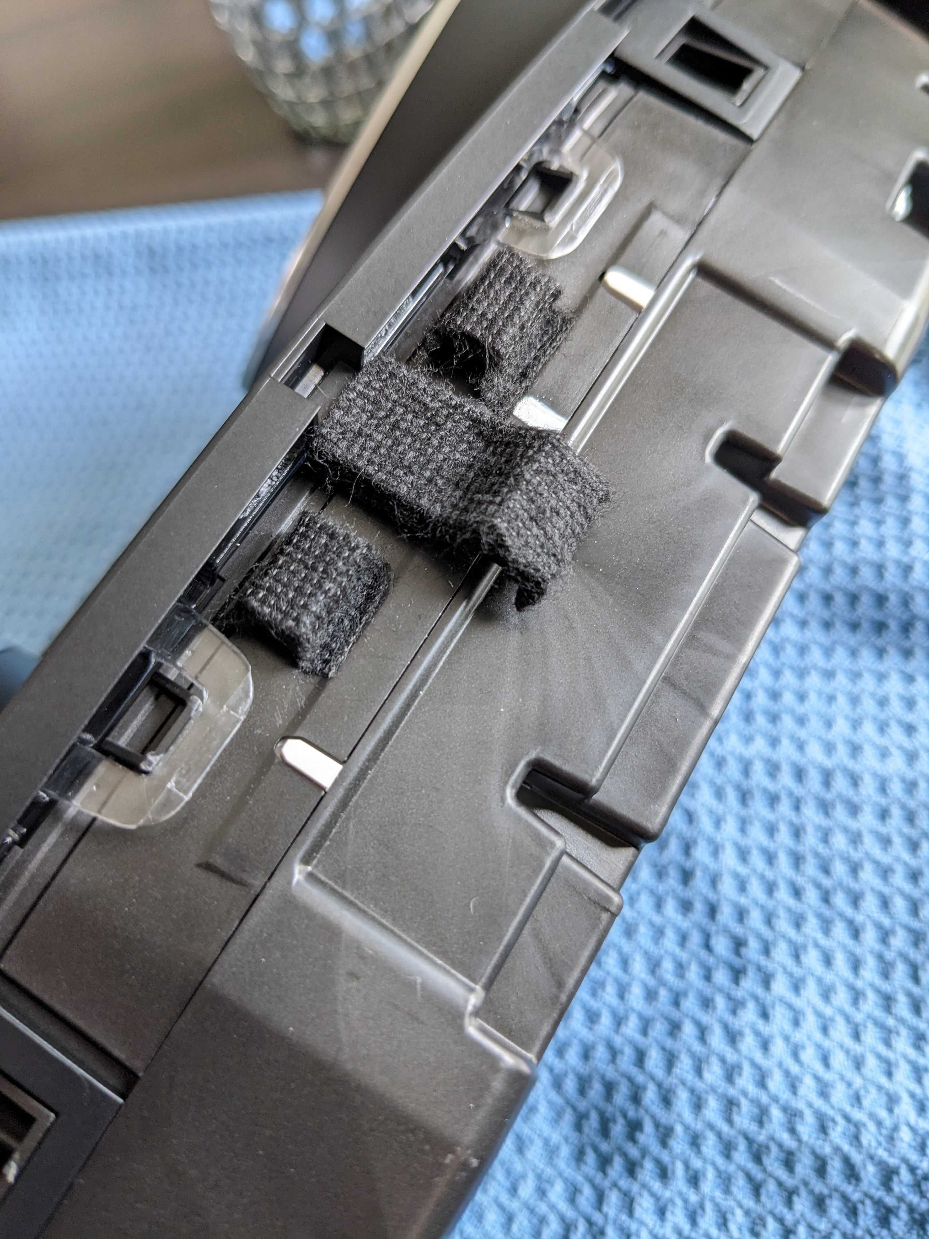

For cluster rattle, you have to remove it from the car and put felt on this part (two lawer):
With the felt on this parts you remove the play between the cluster and the dashboard. Be very carefull when you install is back. Because of the play is reduce, you have to "play" with the cluster assy to put in back in place.
Torque for the bottom screws (x2) is 2.5Nm.
