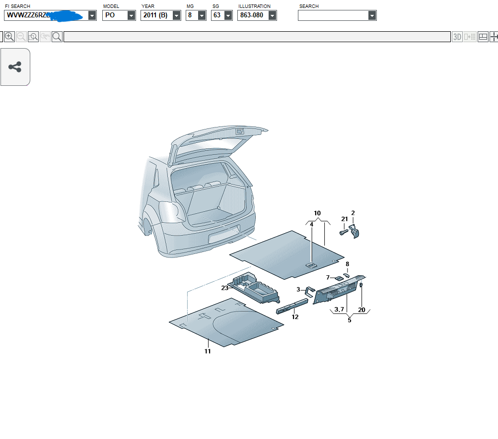

Polo 6R 2011.
Looking for a 'false' floor panel (6R0858855) The panel that flips up to access the spare wheel- No 10 in the picture
and the related left and right support brackets to suit- No2 in the picture.

No longer required, as I managed to locate all that I needed from a very helpful online breakers. For those in a similar position, having the base S model with no 'false floor' it might be worth noting that (at least on my 2011 example) there were threads present in the existing metalwork to accept the four (two each side) M6 x25 T30 fixing screws to secure the left and right support brackets. Fitting being as simple as making holes in the trim 'carpetting' in the appropriate positions
