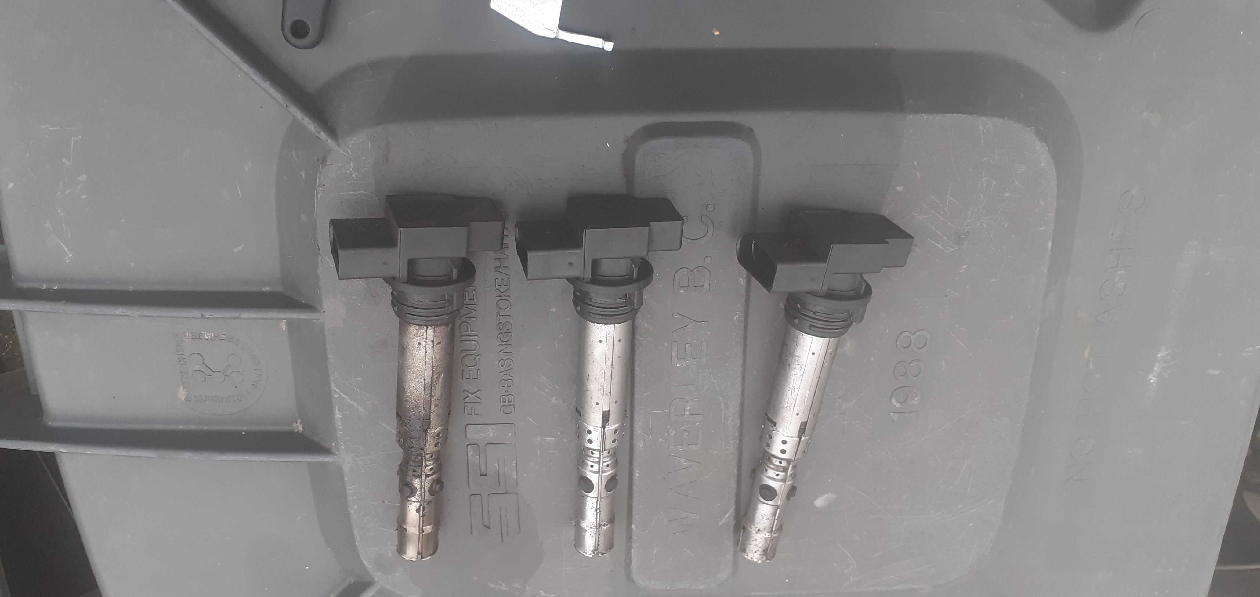

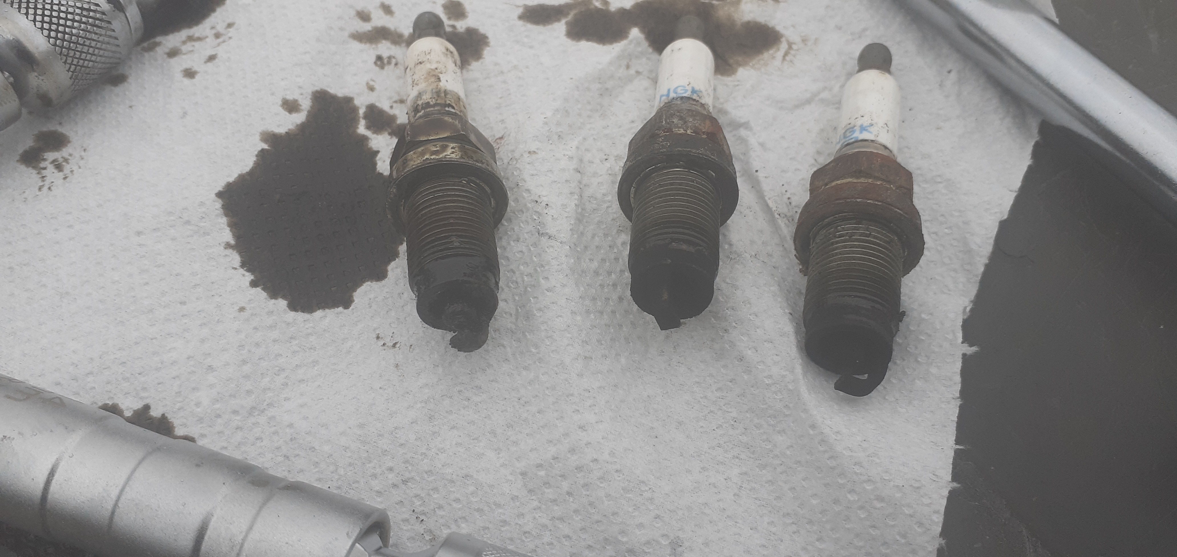

Re: Engine wont Rev past 2000 RPM
just changed the plugs today , they certainly needed changing but the problem is still there
- coil packs.jpg (1.84 MiB) Viewed 22835 times
- polo plugs.jpg (2.35 MiB) Viewed 22835 times
Those have a lot of oil on them.
That's not normal
That's not normal
