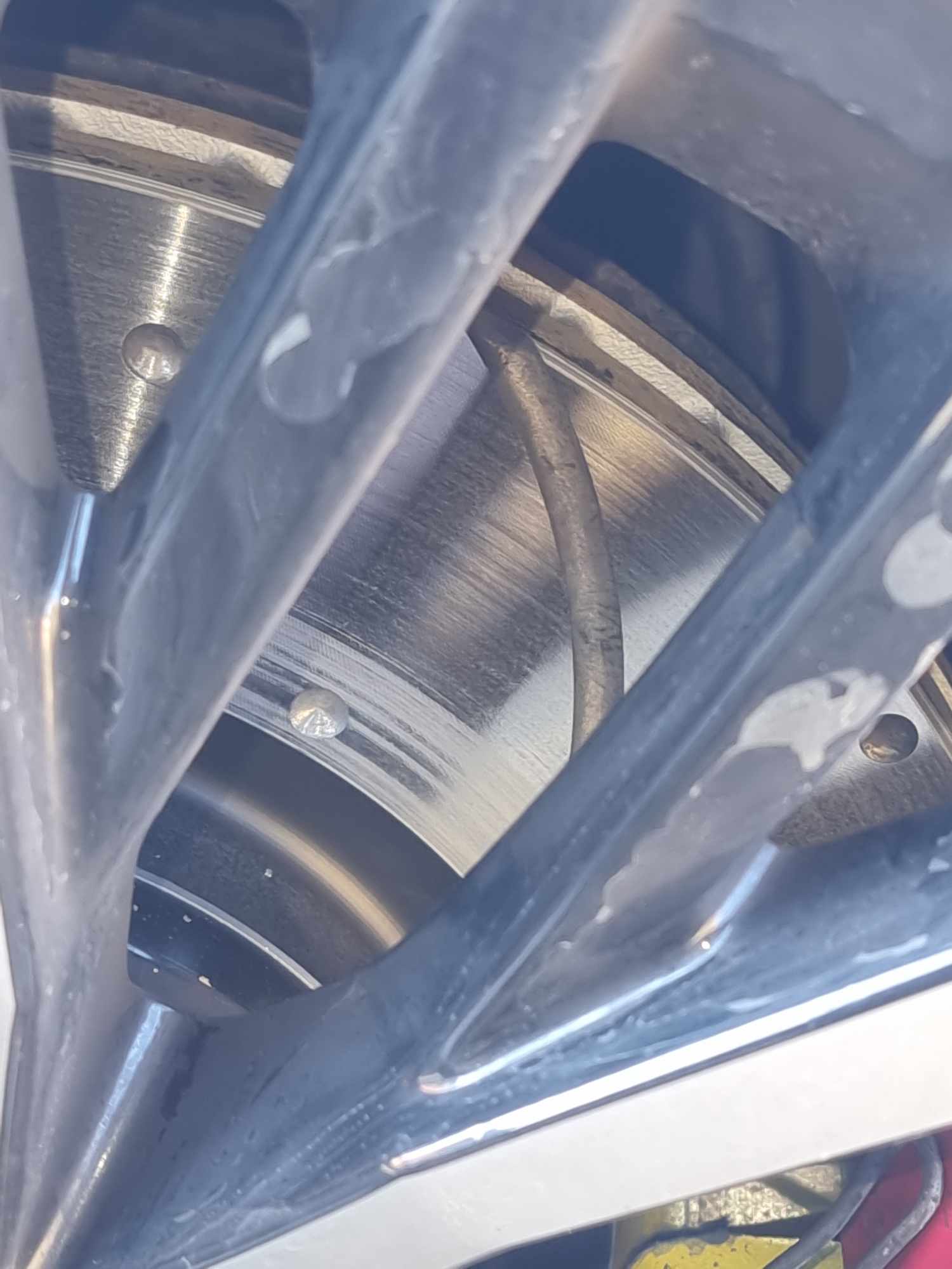

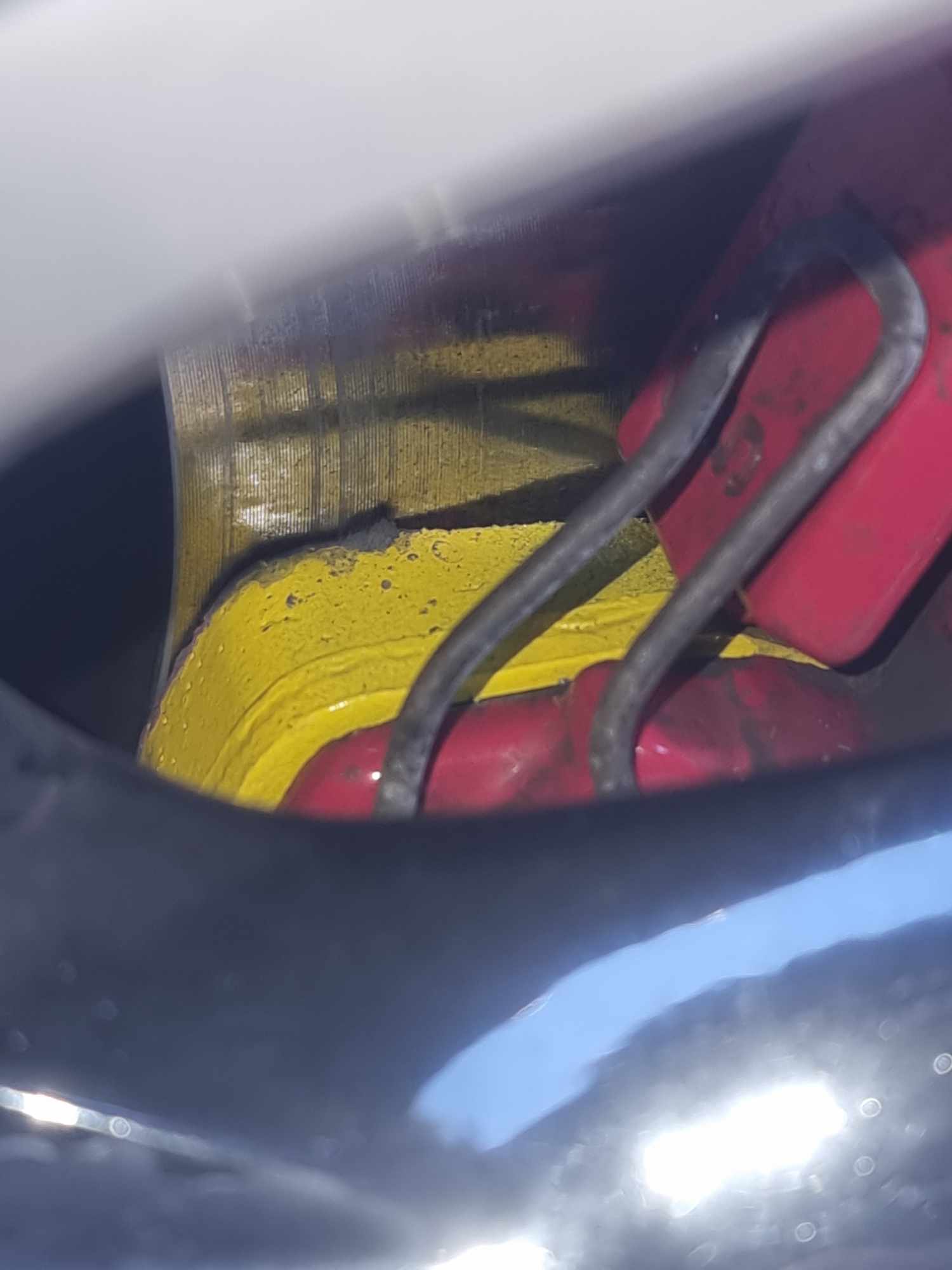

Hello. I had EBC Grooved discs and Yellowstuff pads fitted all around this week. I've done 30ish miles on them and I have noticed the inside of both front discs look differently worn compared to the rest of the disc. I also noticed it doesn't look like the pads are sitting completely flush with the discs, I'm not sure if this is normal or not. The brakes feel fine, although I am going easy on them. I will bed them in properly after 100 miles or so but I'm worried the garage didn't install them correctly. Any advice will be appreciated.

That's normal with new pads and used rotors

iichel wrote: Thu Jan 18, 2024 5:15 pm That's normal with new pads and used rotors
The rotors are brand new along with the pads
Posts: 6694
Re: New pads and discs not sitting flush?
I see. I wouldn't worry about it too much after 30 miles. Keep an eye on it for a while.

Fast Street use Pre Bed Fade 1 – drive 50 to 100 miles on Public road/highway normal driving to allow the pads to mate up to the disc and establish full contact followed by 8 stops from 80 mph to 30 mph at 300-yard intervals and then coasting allowing the brakes to cool.
The couple of times I've fit bluestuff to a friend's ST he just did a full tank of fuel worth of distance with minimal motorway driving before doing fade 1 bedding. Equated to around 300 miles~ but as they drive a lot that only took a week. Perfect pad to disc contact every time.
Do the 100 miles quoted by EBC and inspect. Try and avoid motorways or long stretches without using the brakes for those 100 miles.
To do fade 1 bedding either find a relatively flat national limit stretch of road where you know you can do your 8 stops without having to stop completely or a stretch of road again preferably with a national limit with a roundabout at each end like a dual carriageway or a motorway junction/spur. The benefit of the latter is once you're done you can hop on the motorway and drive for a while without using the brakes to cool them.
Ideally do it at a quieter time so no one can interrupt your bedding in and there will also be fewer people to think you're a lunatic :D 70-20mph stops work completely fine but still use your head and don't do it somewhere the police are likely to be or where you braking down to 20mph suddenly will put anyone else in danger.
The brakes will get hot and will smell quite bad, that's perfectly normal. If you didn't I'd recommend getting fluid changed or even better upgraded to match the increase in temps the pads can take.
ATE TYP200 is a good choice, while not the highest temp brake fluid out there, it's an increase over stock and only a little more expensive. I've never managed to get it to boil :lol:
