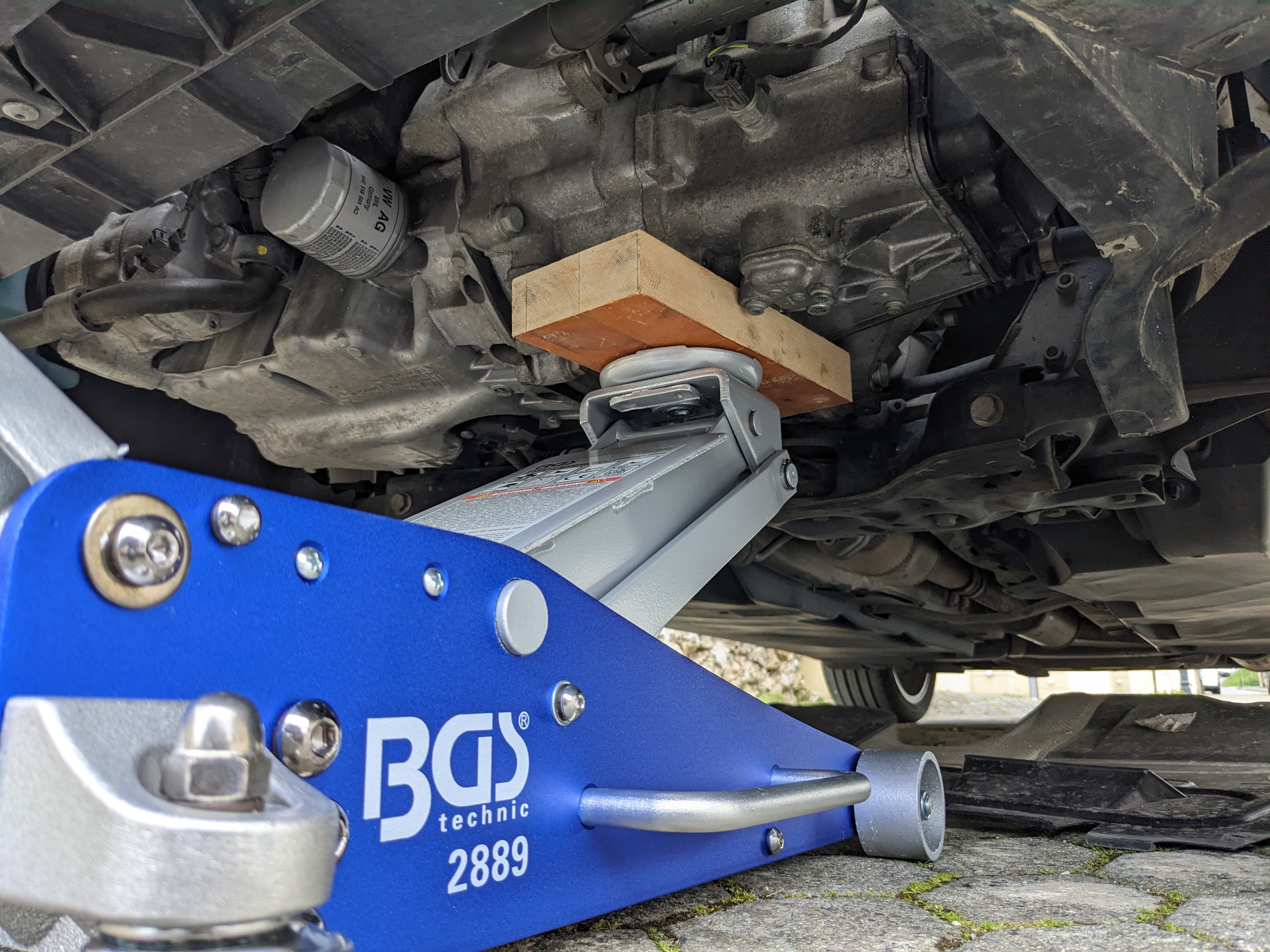

Hey did anyone swap the left engine mount with a scissor jack or a bottle jack? Is it doable?

amer6R wrote: Mon Jun 03, 2024 4:30 pm Hey did anyone swap the left engine mount with a scissor jack or a bottle jack? Is it doable?
You mean the engine mount on gearbox or the opposite side ?
I did the gearbox's one, and with a hydraulic jack it was perferct (under the gearbox). However for the other one, I'm not sure if the oil pan will likes that.

yea the one on top of the transmission. I know i have to support/ lift slightly the transmission. But im not sure when i loosen the bolts on top will it twist and fall off basic jack :mrgreen:

amer6R wrote: Mon Jun 03, 2024 6:24 pm
Le_Combattant wrote: Mon Jun 03, 2024 5:33 pm
I did it last year, and my tips is:
Support your gearbox with a jack like this one:
Remove the bolt that attach the gearboax mount to the gearbox, then lower a little bit (you can remove the dog bone mount to not damage it) and remove the bolts that attach the mount to the frame of the car.
Re: Engine Mount Torque Specs
Thank you, i think it's time then to invest in propper jack

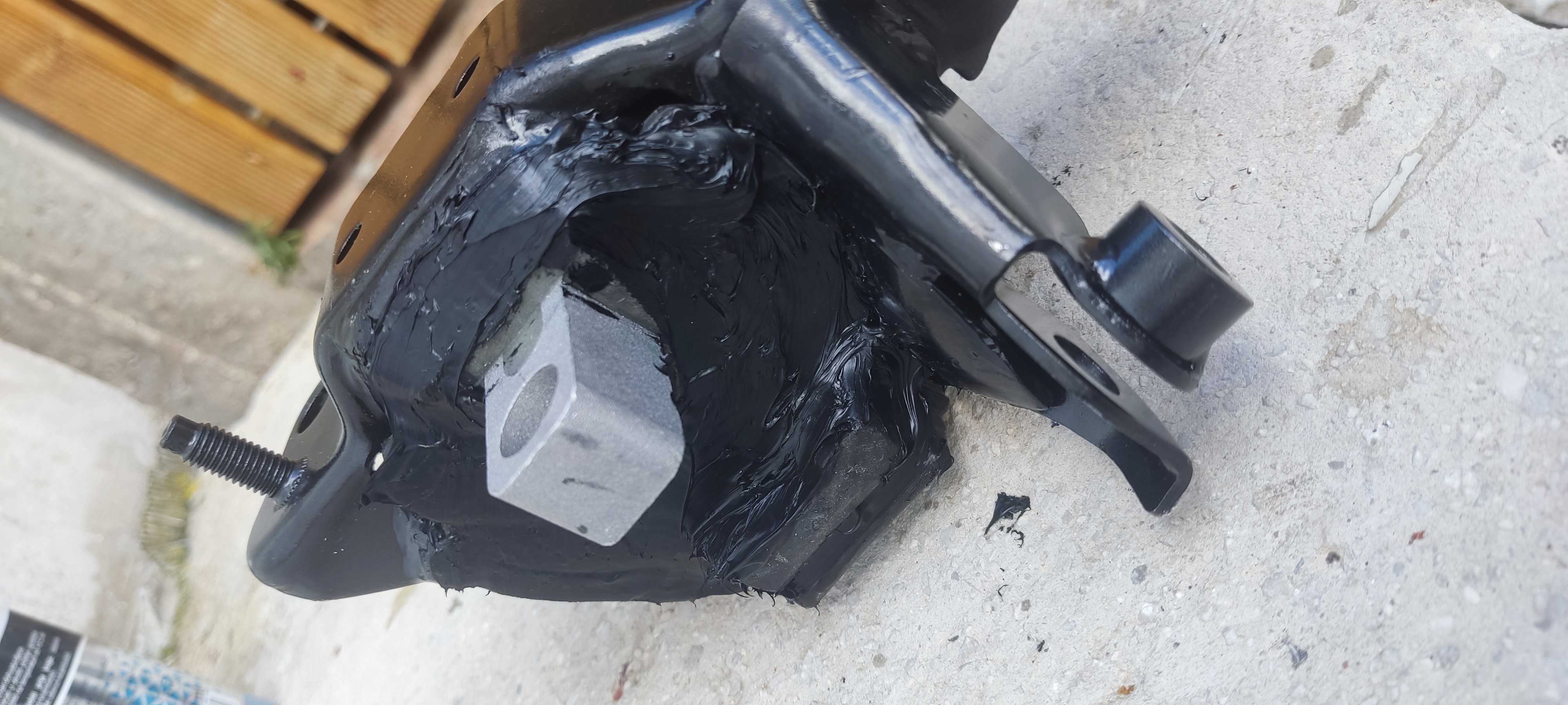

Everything mounted. I have cleaned and degreasesed new engine mount.
Then used Liqui Moly 1402 sealant and filled up the cavity ~ 70% of the tube used. I used a popcycle stick to level it out. Its really thick stuff.
Let it dry for 10 days. Use moisture it will help it cure.
I have a CAY engine with single mass flywheel conversion (~850 rpm idle) and there is so few to none vibrations (idle), but nothing that gets onto your nerves.
There is no more clunking noises, or rocking the car when you lift off your foot from accelerator pedal.
The response is solid, and gear changes are crisp.
I really like it and the car is much more pleasant to drive. The old mount started to show signs of cracking.
