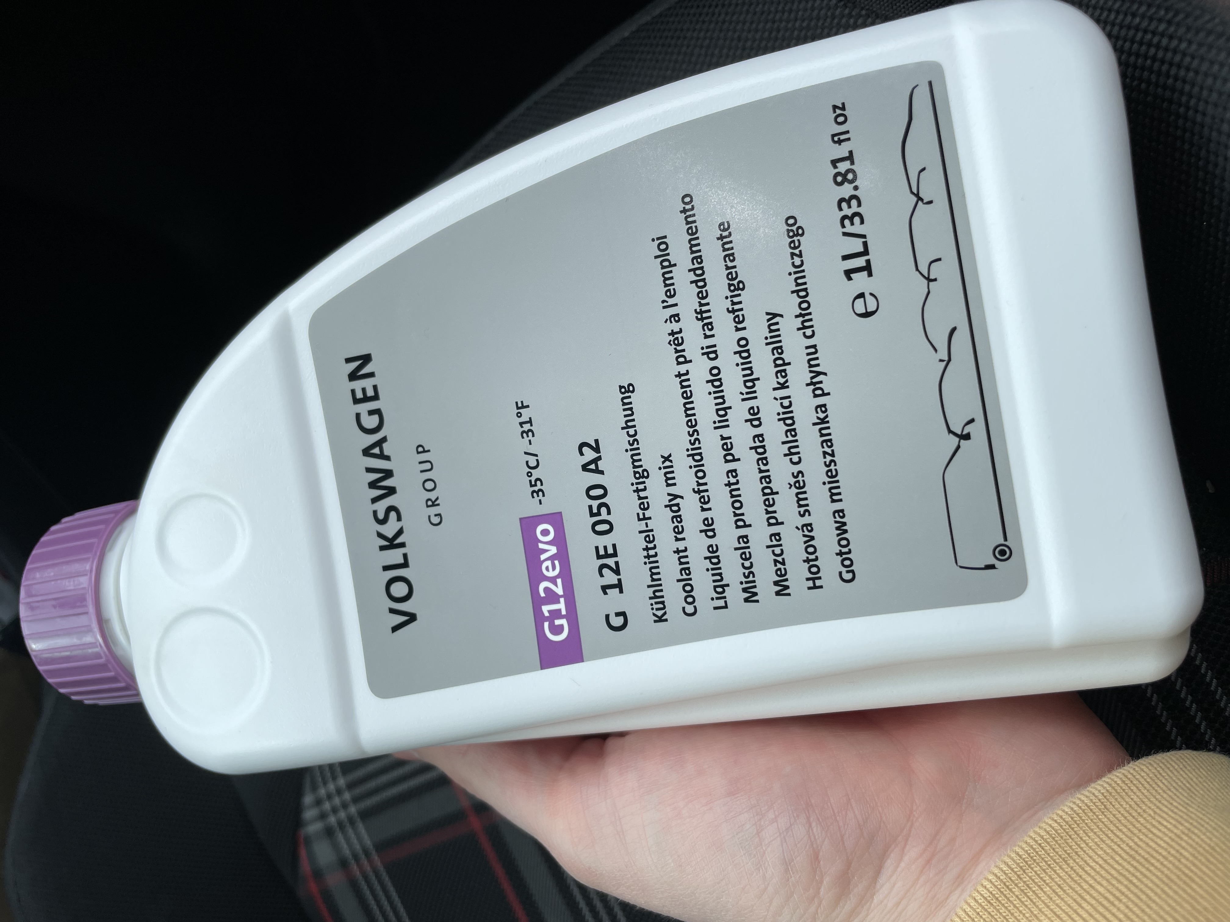

Thanks ciclo. This is the one supplied directly by VW, cost £8.40.
Posts: 6089
Re: Coolant Question
Yes, that is the latest version of coolant.
For anyone that does not know this, VW Group coolant went from G11 to G12 to G12+ to G12++ and then onto G13 which addressed all previous issues, was better than either of the G12 versions and maybe even produced using a "greener" process - and then moved onto G12evo, so that confused a few people, VW Group must have had a very good reason for "bucking logic" and calling this latest version G12 even although it is the first time that G12evo has been used.
