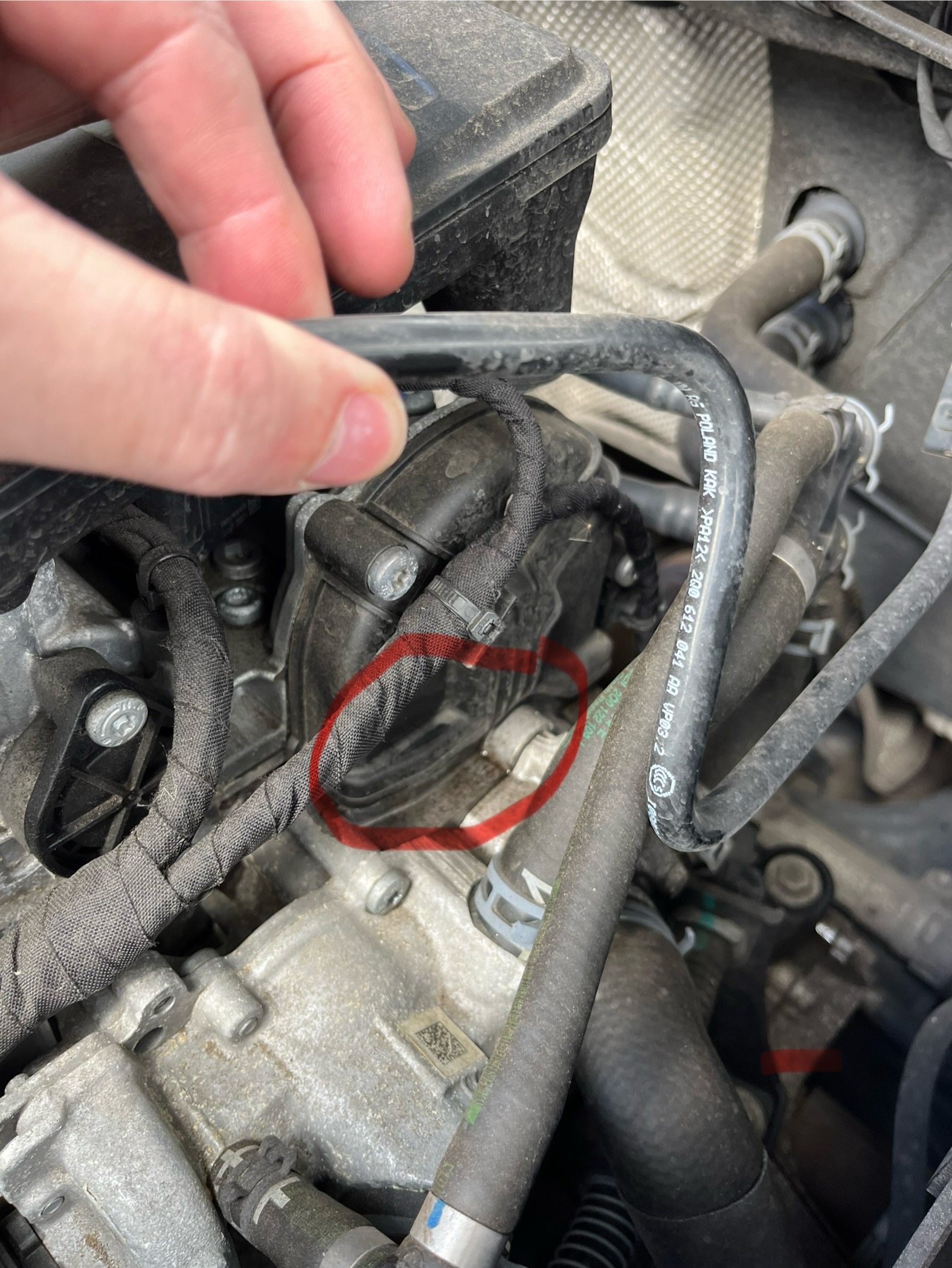

1 litre non turbo engine with a coolant leak.
Evidence of water at bottom of the plastic cover circled in pic,top rest of engine, passenger side.
Is this a common place for a leak and what is it remedy, new gasket or component?

cjb1971 wrote: Tue Apr 02, 2024 12:45 pm 1 litre non turbo engine with a coolant leak.
Thx.
Water pump/Thermostat housing -- a very common problem
