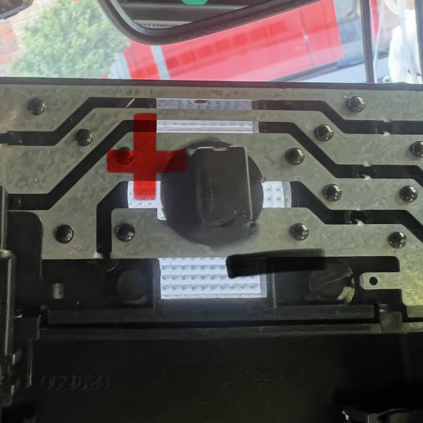

Just to update,
Managed to get them working!
Bought this harness set:
https://a.aliexpress.com/_Ezz0vEH
Also Needed:
~1M of wire (I used speaker wire I had laying around)
2 crimp butt connectors/crimp clamp
Soldering iron/solder
- Before I started I got the harness in place in the car. I followed the schematic from the post on here https://www.team-bhp.com/forum/diy-do- ... ights.html
- To do this I took the radio out and routed it behind there, and for the rear passenger lights I routed down the side of the centre console and under the middle of the chair so the cable does not get caught when moving seats back and forward.
- I took the dome light assembly out and unplugged the two connectors
- Took it inside and soldered the wire on the middle bulb of the dome light. The reason for this is the other two lights can be switched on and off individually, whereas the middle light is on powered by the main switch (off/door open/on)
- Once I had soldered the wire on I took it back to the car and routed the wire through the roof and down the A pillar
- I then cut the wires to desired length and crimped them together with the butt connectors and tucked behind the dashboard panel out of the way
No extra fuses or coding required!
Posts: 6694
Re: Retrofitting OEM footwell lights
it would have been easier to just take the red/black and brown/black wires of the connectors?
