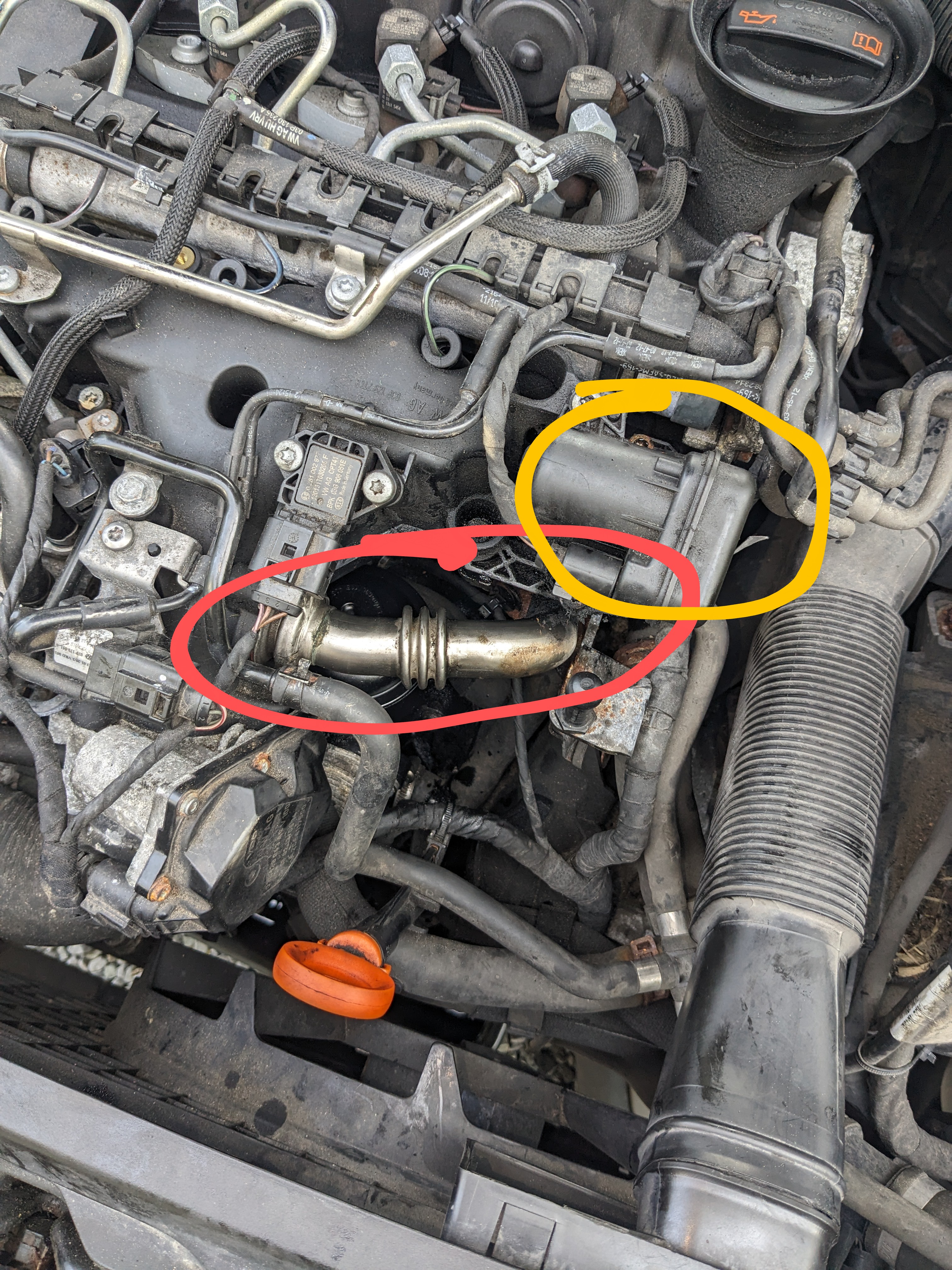

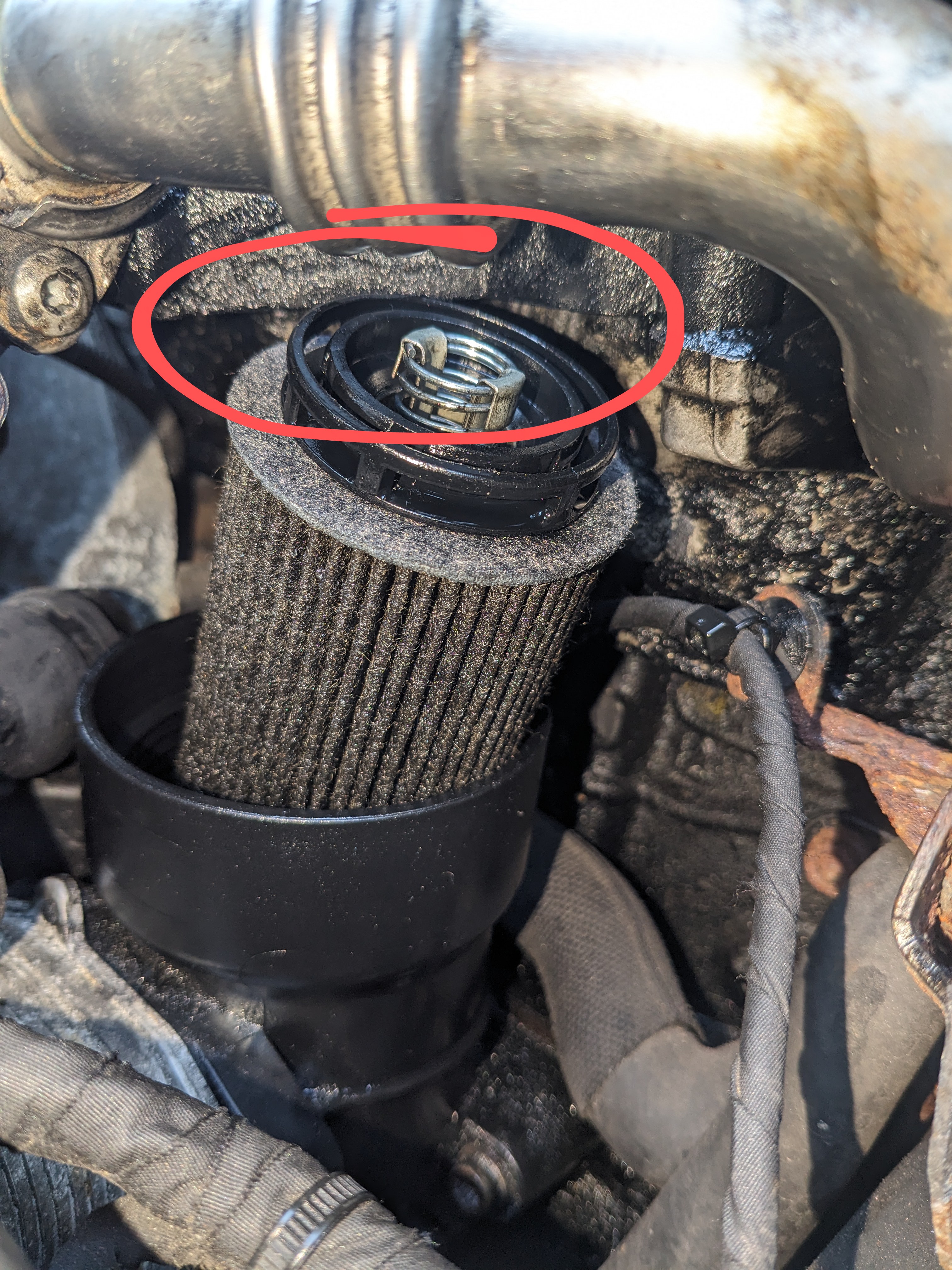

Thought this would be my last post / update. Well I've finally got the filter out but only because I removed the pipe circled in red and the valve circled yellow I removed the three torx on top just so I could move it slightly to the right so I could get a better view of the pipe end. With that out of the way I could get the filter out. Replaced with new filter inserted into the new filter cap, only difference was the replacement filter was about a half inch shorter than what was already there. A bit of juggling and the cap dropped square on to the housing and tightened it up. All seals on and pre oiled. Replaced everything as was and changed the oil.

Posts: 8992
Re: Oil Filter removal
CFWA?
1- You must make sure that the renewed parts are compatible/correct. Use the original references according to engine code to buy the parts to be renewed, ... original or aftermarket.
2- You must make sure that no old seal is left in the container/hole/duct for the filter.
3- You need to make sure you have placed the new small rubber seals correctly.
Any of the above three can cause high oil pressure due to restriction in the oil passages.🤷‍♂️
Edit...
Try to find the/some reference number of the filter housing and intercooler assembly, maybe we can draw some more correct conclusion of what may be happening there.
In the ETKA (image above) it is position 1 (oil filter with flange). 03P115389A --replaced-> 03P115389B

Unfortunately cannot see any markings on the housing for part no. Etc.
Si the end result is that after removing the new cap again it has the incorrect seal stem. Too short therefore not sealing in the base of the housing and thus causing pressure issues Swapped the old seal stem into the new cap to solve this problem.
Next problem......impossible to get the filter and cap back into the housing in one piece. After much pushing, twisting and swearing I removed from it's wedged in position and found that the thin plastic legs attaching the shat to the cap had broken.
So next step was to clean out housing, break shaft away from the cap and then install shaft full down into housing base, filter in and then cap. No other way without major dismantling of the engine.
