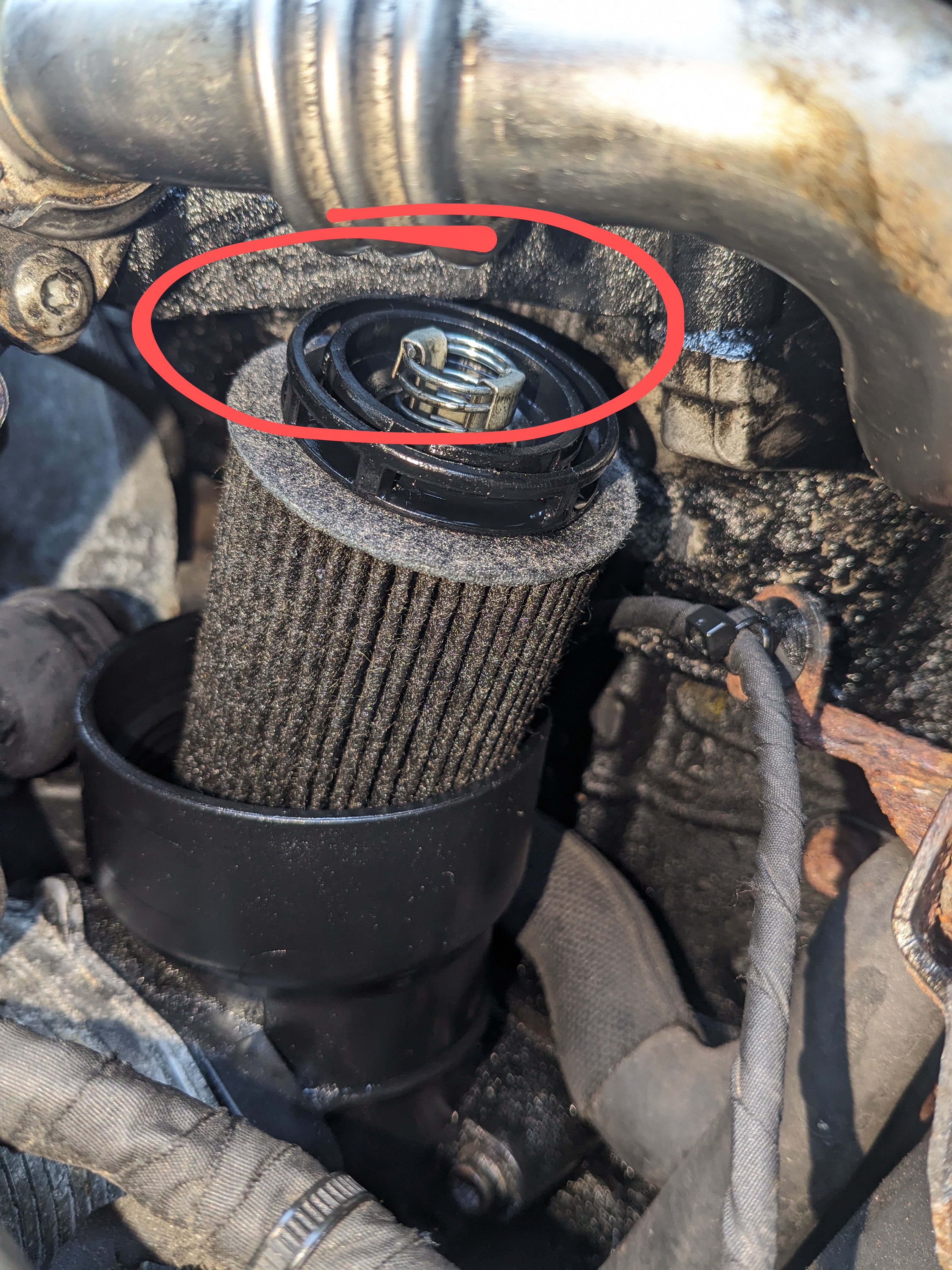

Right, I can only conclude that someone has previously replaced the filter housing and intercooler in the past and fitted an incorrect one. I had to force the cap off which in turn disengaged the internal spline with the seals in it and that and the filter are still in the housing. No way on this planet is that coming out intact as it's hitting the edge of the plastic assembly above and then the metal pipe along side that. I found a video of similar set up on the 1.2 TDI and they simply pulled the filter out upwards, as it should be. This car, no way !!

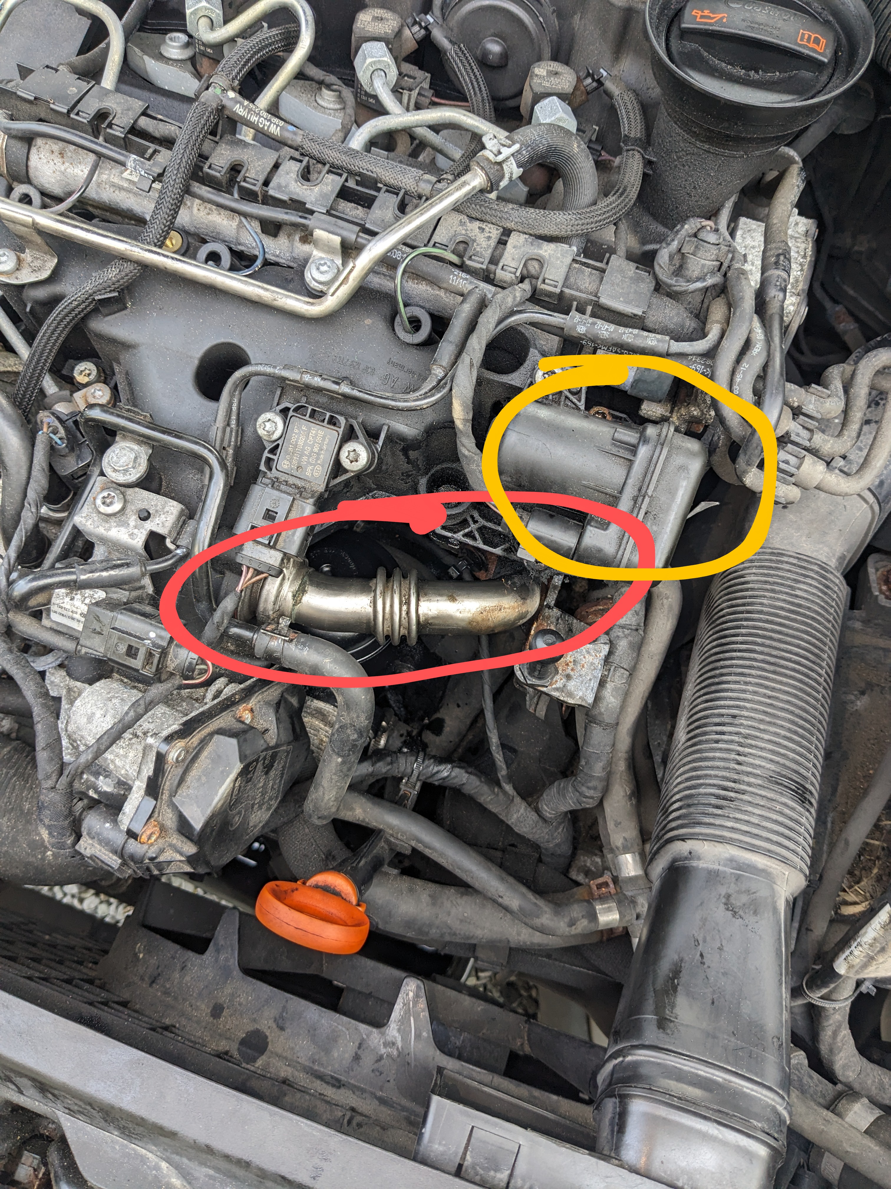

Thought this would be my last post / update. Well I've finally got the filter out but only because I removed the pipe circled in red and the valve circled yellow I removed the three torx on top just so I could move it slightly to the right so I could get a better view of the pipe end. With that out of the way I could get the filter out. Replaced with new filter inserted into the new filter cap, only difference was the replacement filter was about a half inch shorter than what was already there. A bit of juggling and the cap dropped square on to the housing and tightened it up. All seals on and pre oiled. Replaced everything as was and changed the oil.
So now I have red oil symbol coming up on dash with audible bleep indicating high oil pressure.
Haven't touched anything else and nothing missing, disconnected or loose.
Is it the shorter oil filter causing this ??

Unfortunately cannot see any markings on the housing for part no. Etc.
Si the end result is that after removing the new cap again it has the incorrect seal stem. Too short therefore not sealing in the base of the housing and thus causing pressure issues Swapped the old seal stem into the new cap to solve this problem.
Next problem......impossible to get the filter and cap back into the housing in one piece. After much pushing, twisting and swearing I removed from it's wedged in position and found that the thin plastic legs attaching the shat to the cap had broken.
So next step was to clean out housing, break shaft away from the cap and then install shaft full down into housing base, filter in and then cap. No other way without major dismantling of the engine.
