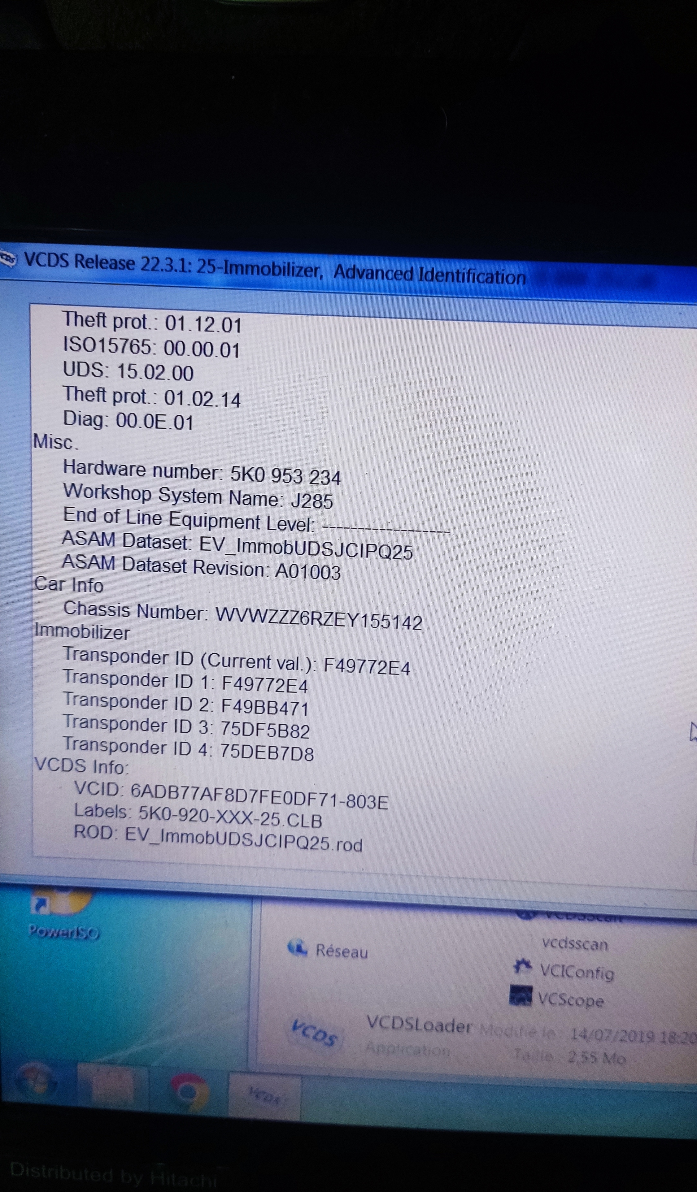

I have a 2014 Polo 6R with ESP9.0i and I lost the coding for the ABS control unit.
The problem is that we swapped the engine with an older 1.9 TDI pump injection engine from 2004.
Is it possible to code the ABS ?
Is there an engineer who can help me?
Thank you
Thank you

Re: Coding ESP9.0i E03 0003
i suppose we could try
How to proceed?
What do we need?
What do we need?
Chassis Type: 6R-VW25 (6N0)
Scan: 01 03 04 08 09 10 15 17 19 25 2E 37 44 56 61
VIN: WVWZZZ6RZEY155142 Mileage: 156180km-97045miles

- Posts: 6694
can you please post the advanced id of the immobiliser (module 25) and engine (module 01)?
Attached is the advanced ID of the immobilizer. The one from the engine is locked
- IMG_20240530_131708.jpg (3.1 MiB) Viewed 3379 times
- Posts: 6694
that's a shame. did you take notice of your factory abs coding? can you tell some more about what you did to the cluster and ecu to make it all work?

Address 25: Immobilizer (J285) Labels:. 5K0-920-xxx-25.clb
Component: IMMO H02 0025
Serial number:
ASAM Dataset: EV_ImmobUDSJCIPQ25 A01003
ROD: EV_ImmobUDSJCIPQ25.rod
VCID: 6ADB77AF8D7FE0DF71-803E
