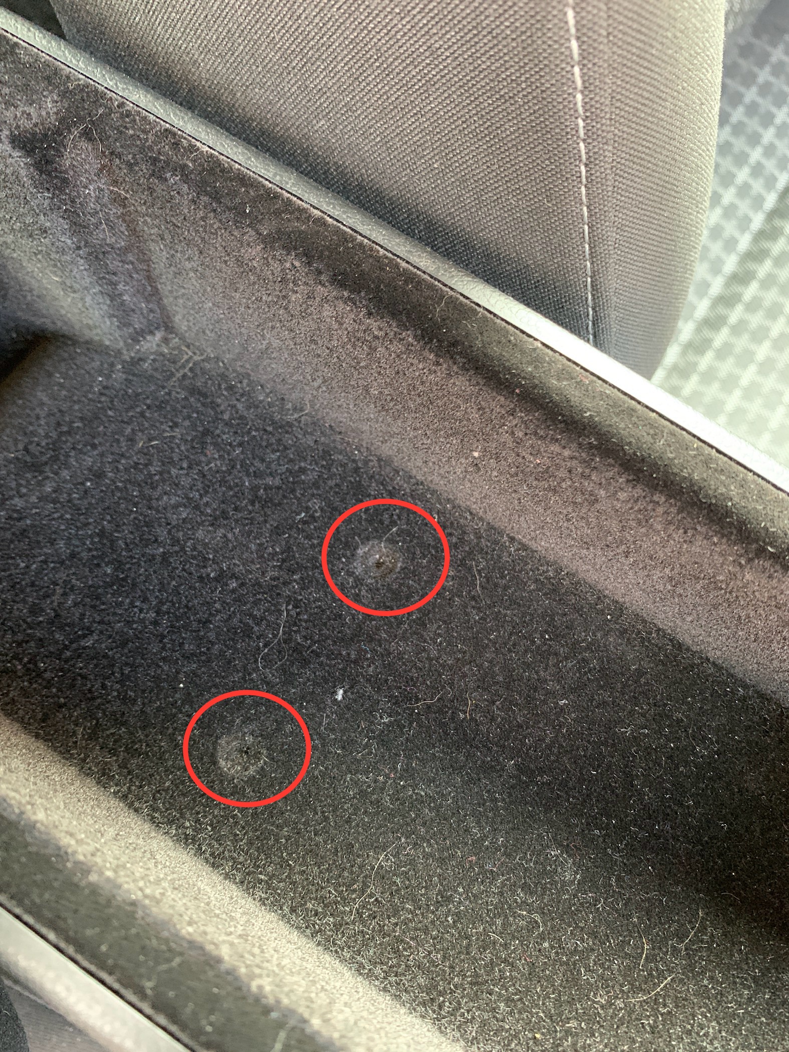

Long story, a VW garage took some screws out of my centre armrest when trying to stop an annoying rattle and never put them back. It’s a lost cause now. Does anyone know what kind of screws go where I’ve indicated?
This is the part https://www.lllparts.co.uk/product/6R08 ... itan-black but I can’t find anything about the screws.

Don't think those are sold separate from the arm rest box.
Nothing shows on ETKA.
However, most trim screws around there 4,2x16 with part number N 906 986 06.
Given the round indentation left behind I would venture to say those are the correct ones to use.
I will check my car in a bit and see what's there.

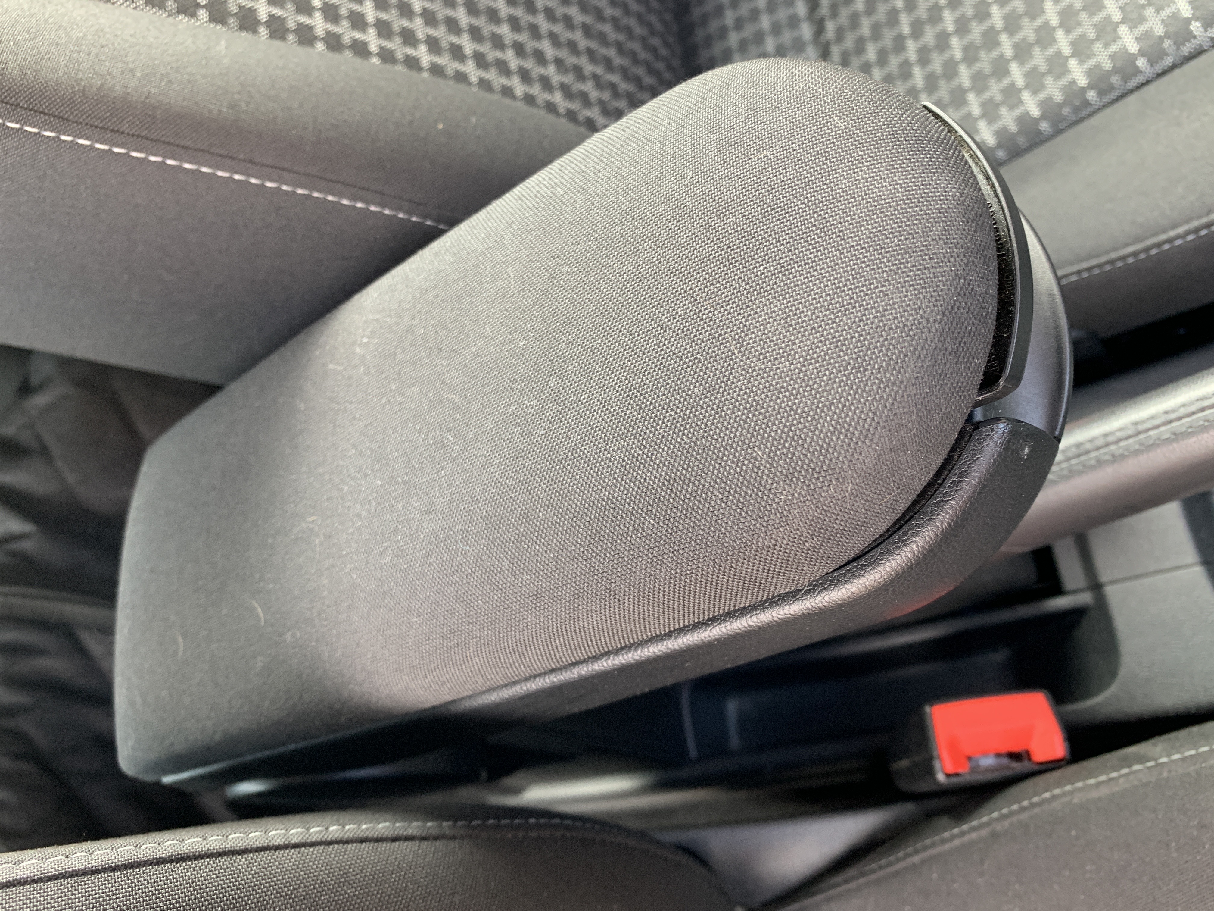

Appreciated! I tried taking out the ones where the hinge is but they were far too big.

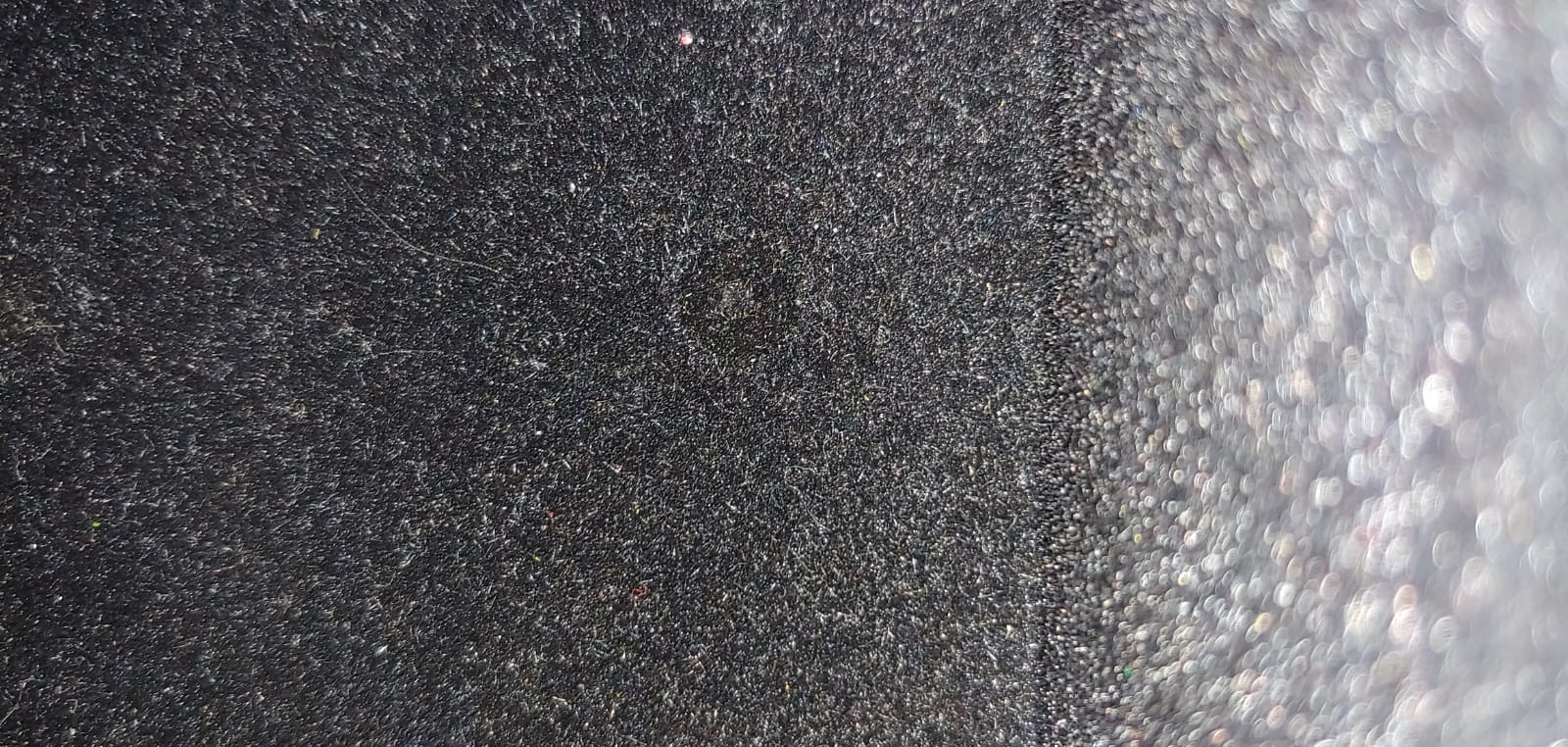

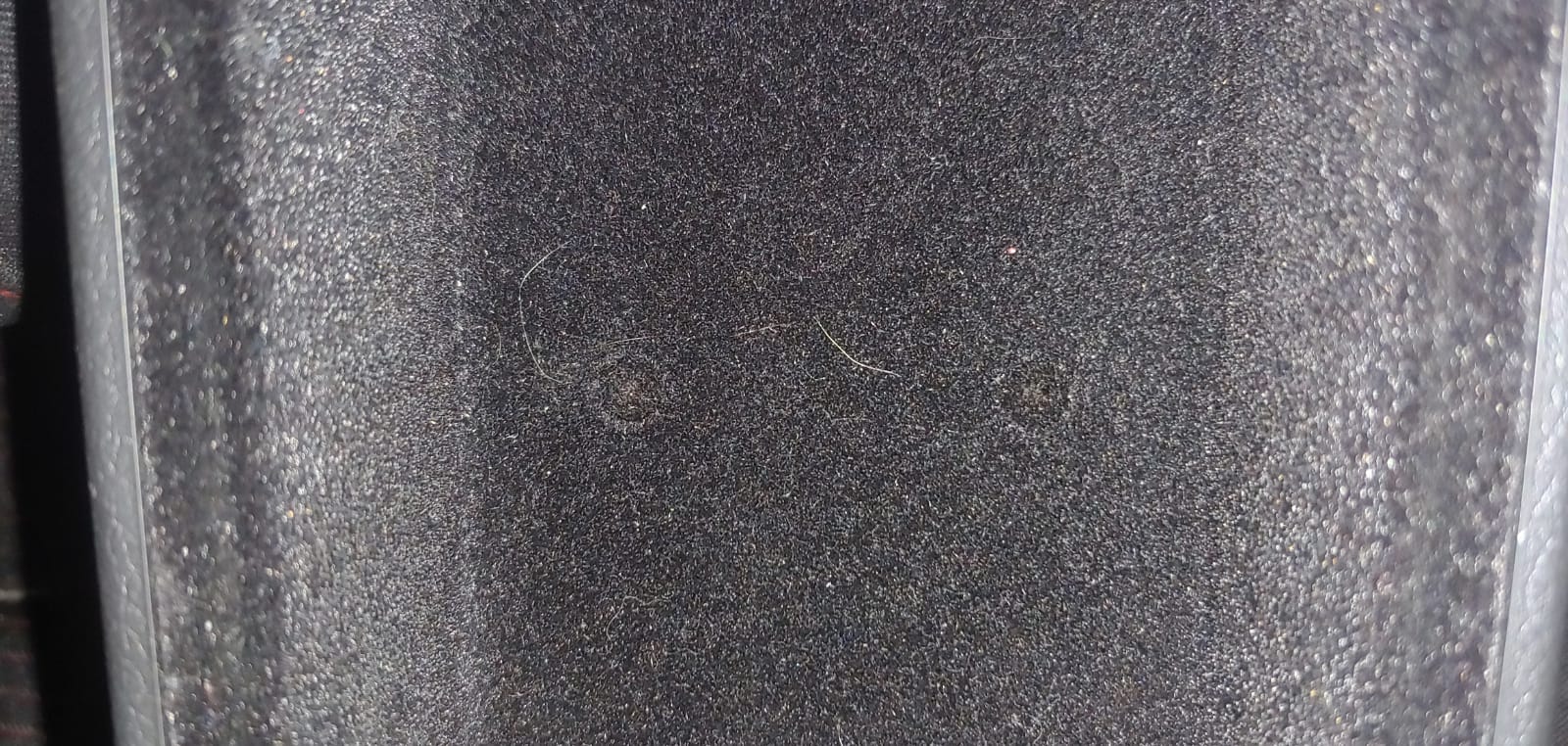

2226
- Posts: 556
Re: Armrest question
Interesting. I have no idea what's under there.
The felt lining seems glued to them. Not too sure I want to dig these out, but no harm if I need to (I think).
Seem to be small hex or torx head, but the lining doesn't help.
You sure there's nothing under there?

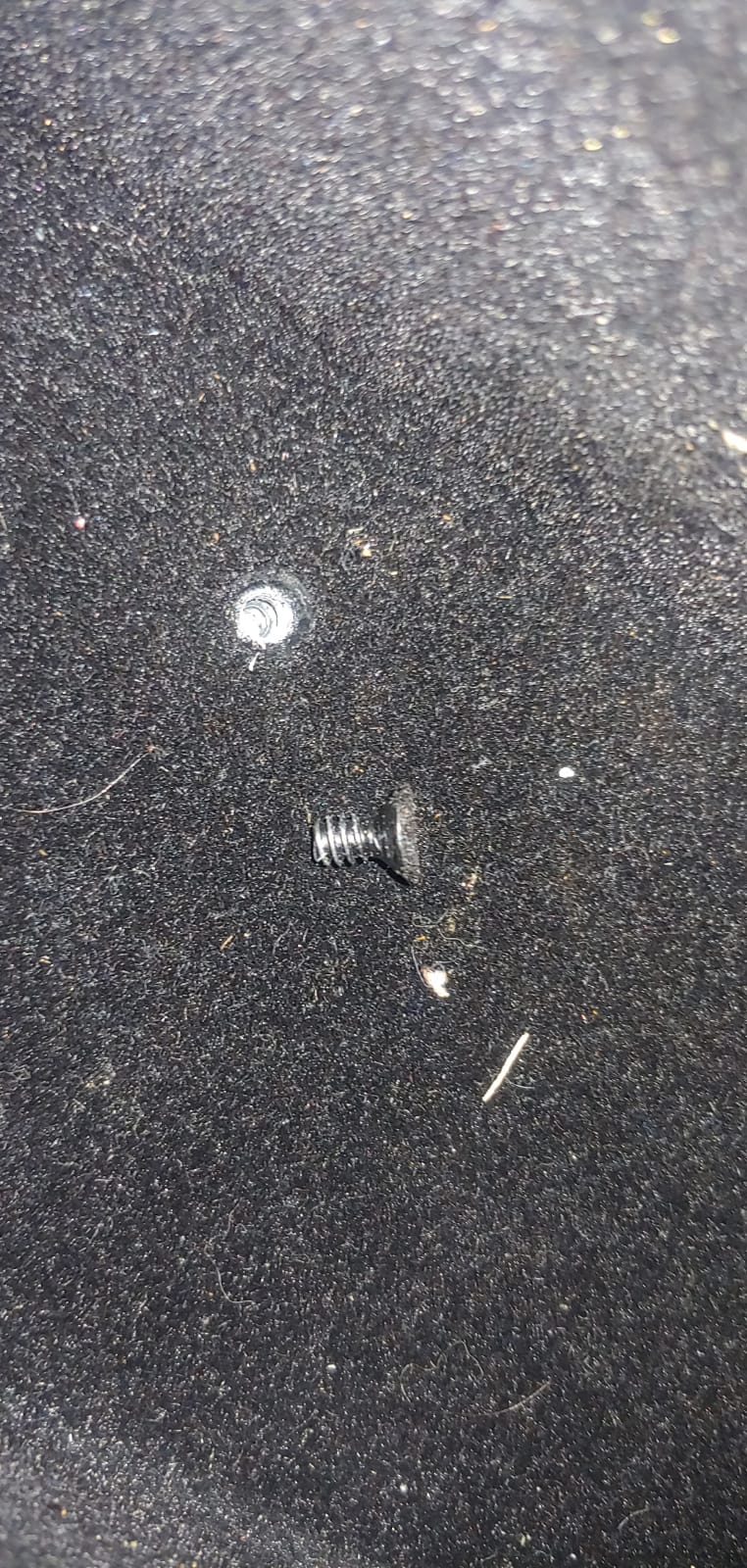

2226
- Posts: 556
So you're not missing any screws. They're in there. It seems they applied the flock to the screw heads as well.
Torx T20
M4.2x5
Overall length 7.8mm, so 8mm long.
Countersunk head, diameter about 7.2mm
Didn't check thread pitch though.
Torx T20
M4.2x5
