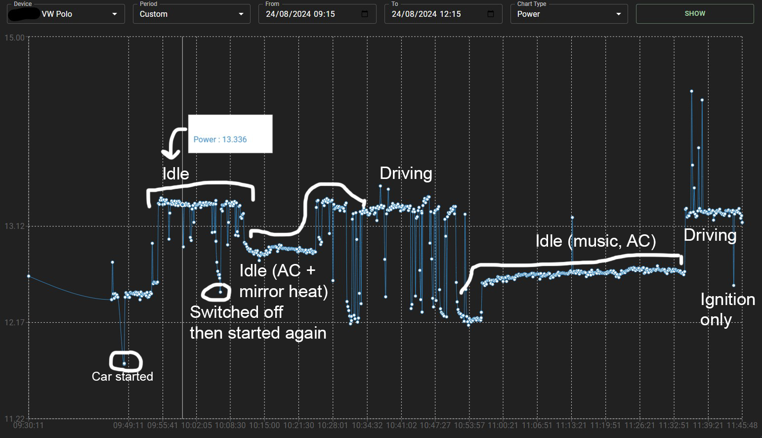

This is interesting - when I first got the battery, I thought I might as well hook it up to my Noco charger while I went around the house looking for my socket set. Took me about an hour but came back to the Noco on "maintain" mode (all four status lights lit with the green one slow blinking) and a voltage of about 12.9v. Fitted it, have started the car about four times on the day.
The open lead voltage on the battery sits around 12.6-12.7v according to the tracker. I've got the power readings and annotated them with what I was doing - it does seem the alternator kicks in randomly (14.7v for about 20 seconds at one point). It was a short trip (I stayed in the car as was in a loading bay...) but kept the engine going. If the battery isn't being massively discharged and the BCM wants to keep it at ~75%, that would make a lot of sense if it now knows its got an AGM battery installed.

Screenshot 2024-08-24 190655.png (532.67 KiB) Viewed 4990 times
Driving from London to Cambridge and then back tonight so will see what the power readings are during and after the trip. Got a jump pack just in case it all goes wrong!

That's all pretty normal, my charging voltage jumps to ~ 14.8V almost immediately after every start but only for 15/20 secs or so, presumably to replace the ~0.25AH or so used in starting the car, it occasionally rises to 14.8V while driving (frm 13.3V) but allways stays at a constant 14.8V on overrun, the SOC is normally around 80% but did show 85% on last scan, below. Car/(EFB) battery, 5.5 years old, "fleece" shows in battery type on VCDS.

I've taken the car around (put 430mi on it over the last couple of days) - I think the alternator may have a problem. Looking at the speed vs power line graphs (I've tried to overlay the two but looks like a mess) - the points when I'm braking is where the voltage jumps to around 14.6v, which suggests the jumps are the regen braking. I remember the chap at the dealership mentioning the car does have regen braking, but thought that was only for hybrids and full electric cars, but if it does have that, the voltage makes sense.
Have put a battery tester on the new battery too, it's reading SOC as 57% at 12.34v (car unlocked, key in my hand, no lights on apart from the digital dash) and that the battery needs charging. The electronics are probably drawing a tiny bit of current, so to account for voltage drop, think the true voltage might be 12.5v.
