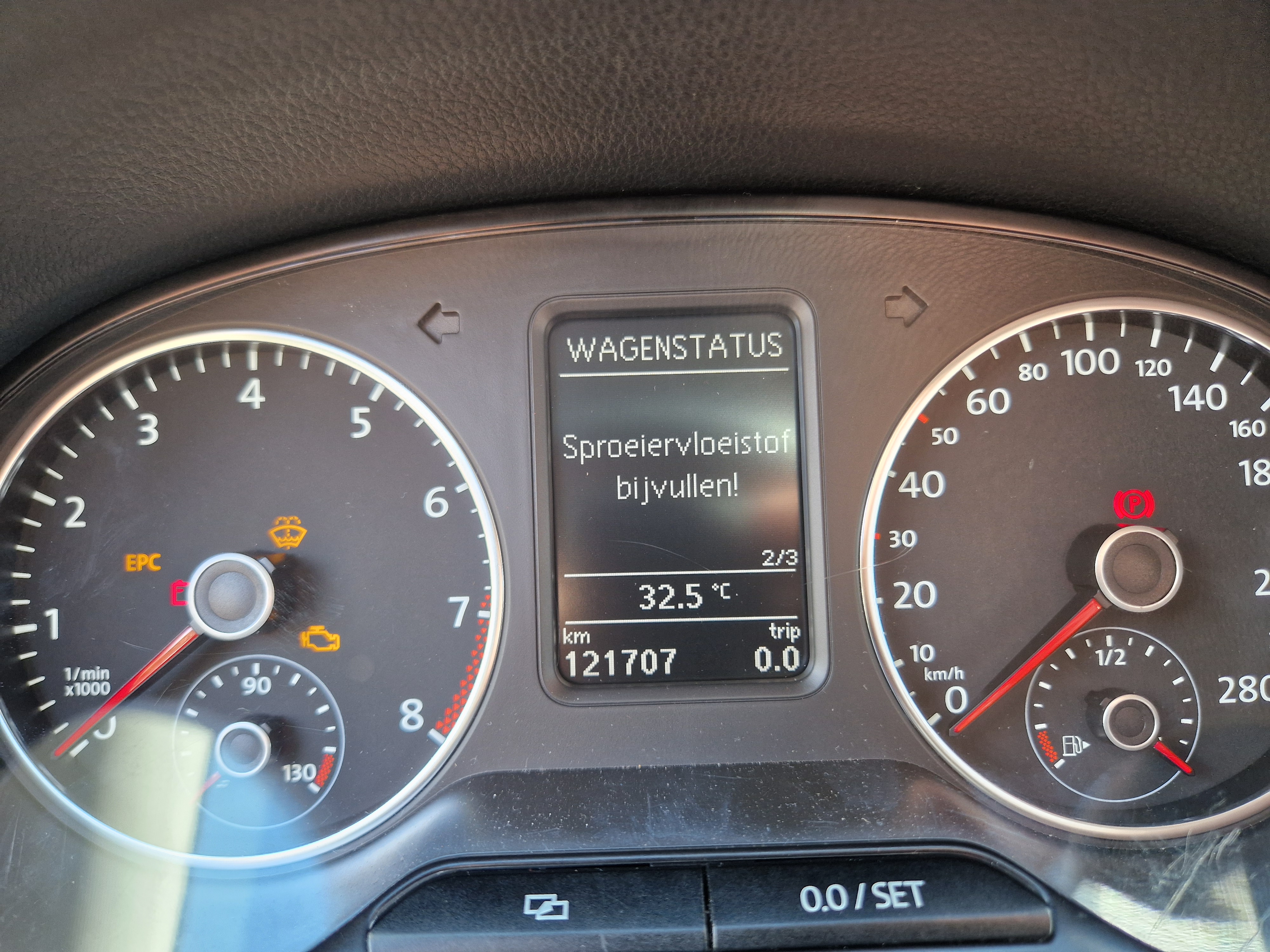

Windscreen wiper fluid level sensor also works :)
